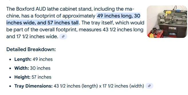

      Hi,
      I am just returning to ‘home workshop engineering’ and have bought a lathe (but yet to be delivered).  Could anyone please help with some dimensions?  I need the cabinet width and depth for a Boxford AUD Mk2 16″ centres so that I can manufacture a wheeled base for it to be dropped into.  I have rolled machines on 1″ bar in the past but the terrain is challenging this time!
      Any help is much appreciated.
      David

          John Hinkley
            @johnhinkley26699
            If the vendor can’t (or won’t) supply the measurements and you are prepared to accept the results from an Artificial Ignorance source, this is what I got back by asking it for “Boxford AUD cabinet dimensions”
            AUD cabinet
            Is that adequate for the trolley your want to make?

              Hi, as far as I know, the CUD, BUD and AUD MK2 lathe cabinets, are all the same size, with respect to the distance between centres. My MK2, 16″ centres CUD cabinet to the best measurement is 40-5/8″ (1032mm approx) long, and 13″ (330.2mm approx) wide, excluding the doors on the front, but the bottom of the doors are about 2-1/2″ (63.5mm) above the bottom of the cabinet, it stands about 30-1/2″ to the top of the tray. which is about 2″ to 2-1/2″ both ways, longer/wider than the cabinet.
              Regards Nick.

                @speedybuilder5
                My AUD – Bed 36″ measured from LHS of headstock located on the ‘Vees’ to the RH end of the Vees.
                Cabinet base 39 1/2 x 13″  the doors protrude over the base, but the hinges/doors  lift straight off.
                The tray is substantially larger being 43″ x 17 1/2″ with an upstanding lip of 1″
                Overall height, floor to top of tray is 28 1/2 + 1″

                David Johnson 13
                  @davidjohnson13
                  Thank you all for the responses.  I had guessed the width at about 14″ (based on the documented 17 1/2″ tray) so two of you saying 13″ gives me something closer to work on.  The length can a bit more flexible as does doesn’t affect entrance restrictions.  I just want my wheels at a reasonable width to reduce the wobble.  Didn’t get dims from seller as it was an auction purchase and oddly what I wanted to know is one of the few things not detailed when searched on the interweb.
                  Thanks again, much appreciated
