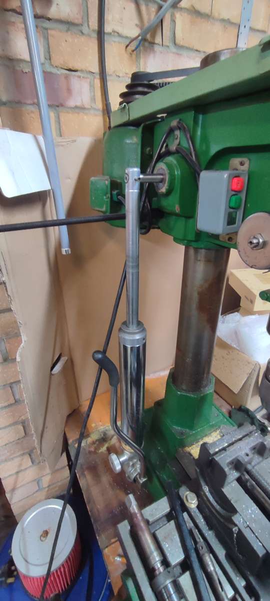

          I got this manual hydraulic ram for £3.
          IMG_20240526_170840
          I will mount the ram fixing at base to the mill stand when i get around to building it. The ram works very nicely going all the way to the top of column and down low enough that you would not have to use the quill feed. Might add a gas strut if i find one for free but it’s not really needed tbh as the release valve has great control when lowering. The picture makes it look like the shaft on mill could snap but it seems solid enough imo.

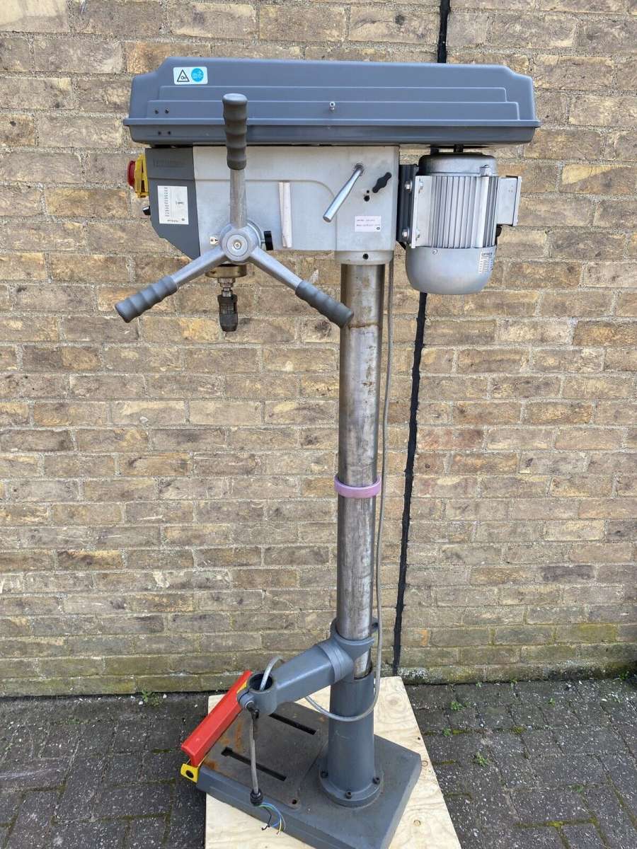

          Next i found a donor for parts 🙂
          s-l1600
          I got this 750w 3 phase pillar drill with a broken table for £43.
          It was a shame to strip it to pieces as it was a nice little drill but the mill needed some of the parts and i will use 90% of them.

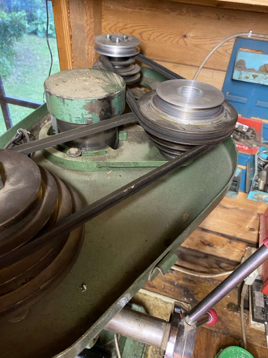

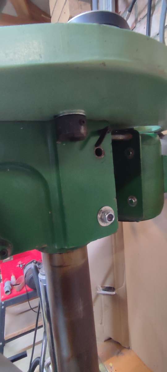

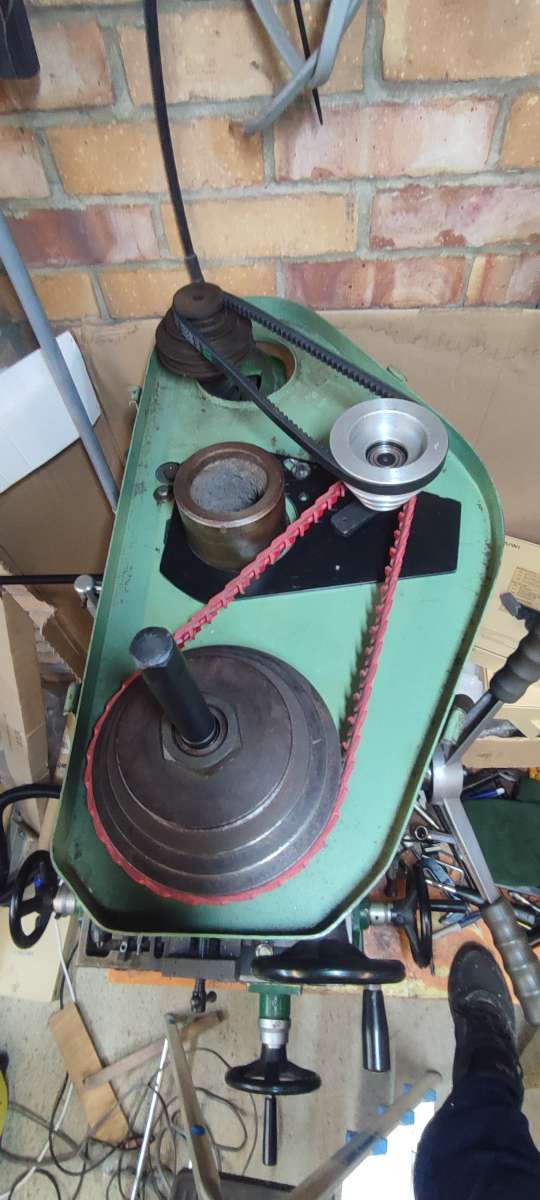

          Next part was pulley from the drill press to fix my missing one.
          IMG_20240526_173044IMG_20240526_173057
          I found a tv stand base that was about 5mm thick and drilled the hole unfortunately i did not have the exact size to match the column but close enough. The pulley shaft goes through the 5mm plate into the belt cover base and then i used the leftover shaft collar from the missing gear rack to hold it in place. Apart from being aluminium and not as heavy duty as the original part it works very well also.

            You need one of these. The pulley on top is my way of changing from low speed to high speed by just changing one ‘V’ belt.
            IMG_1592 Large

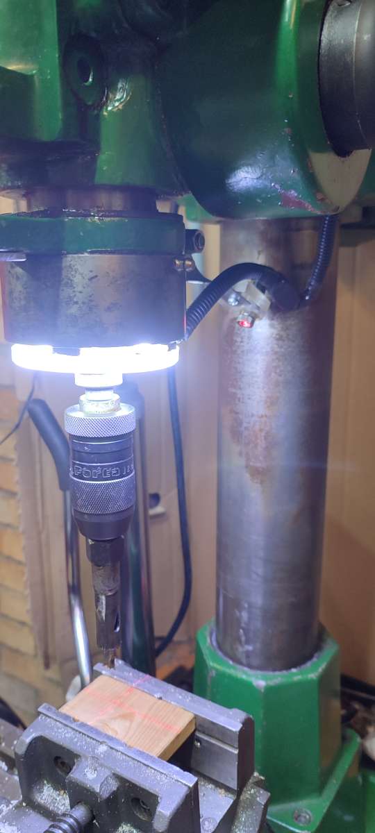

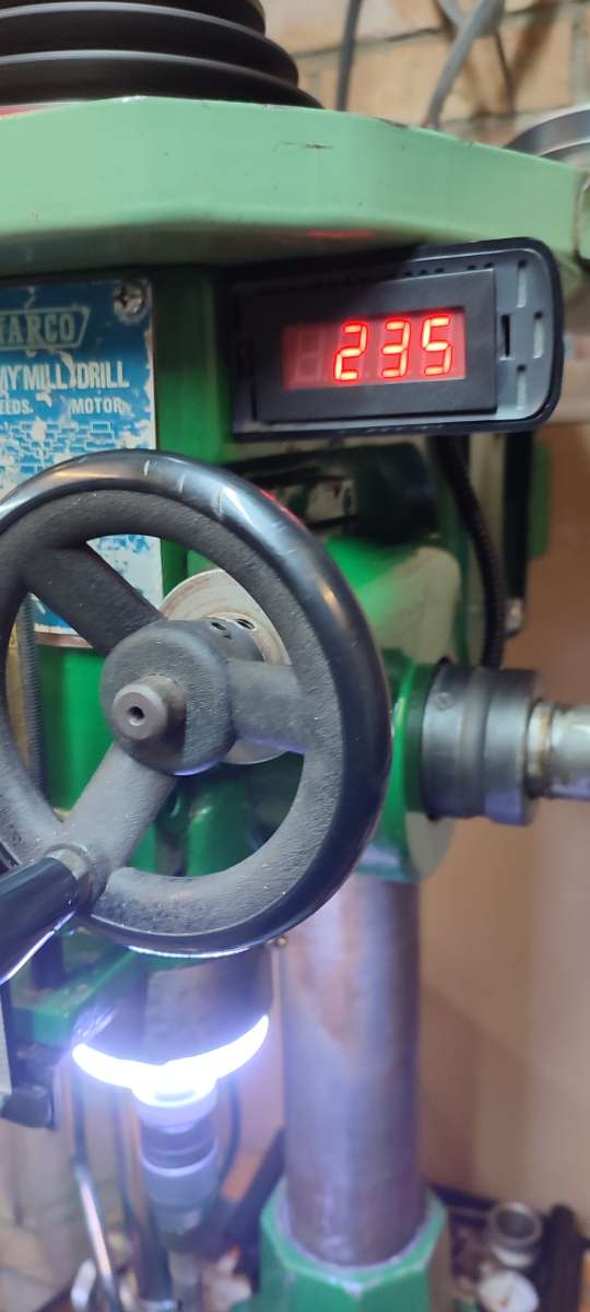

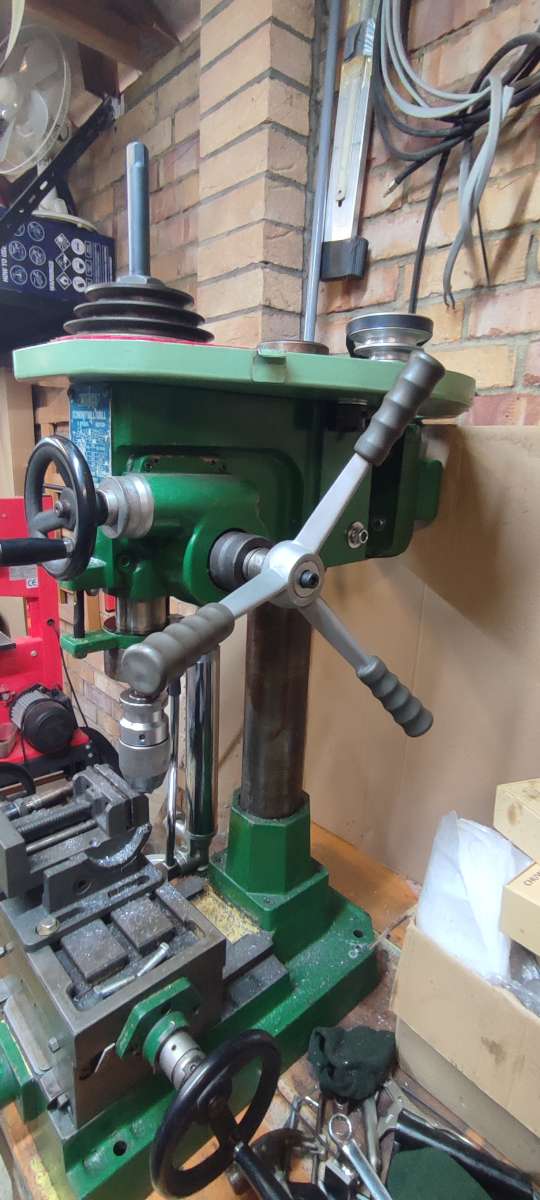

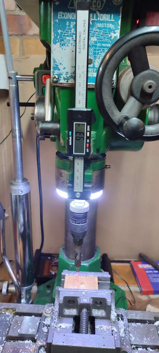

                This week i added the tacho,cross laser,digital vernier caliper as a cheap dro and an 80mm ring light.
                IMG_20240606_200324[1]
                IMG_20240606_200301[1]
                IMG_20240606_200248[1]
                Very pleased with the results after testing just need to get around to fabricating a nice stand next.
