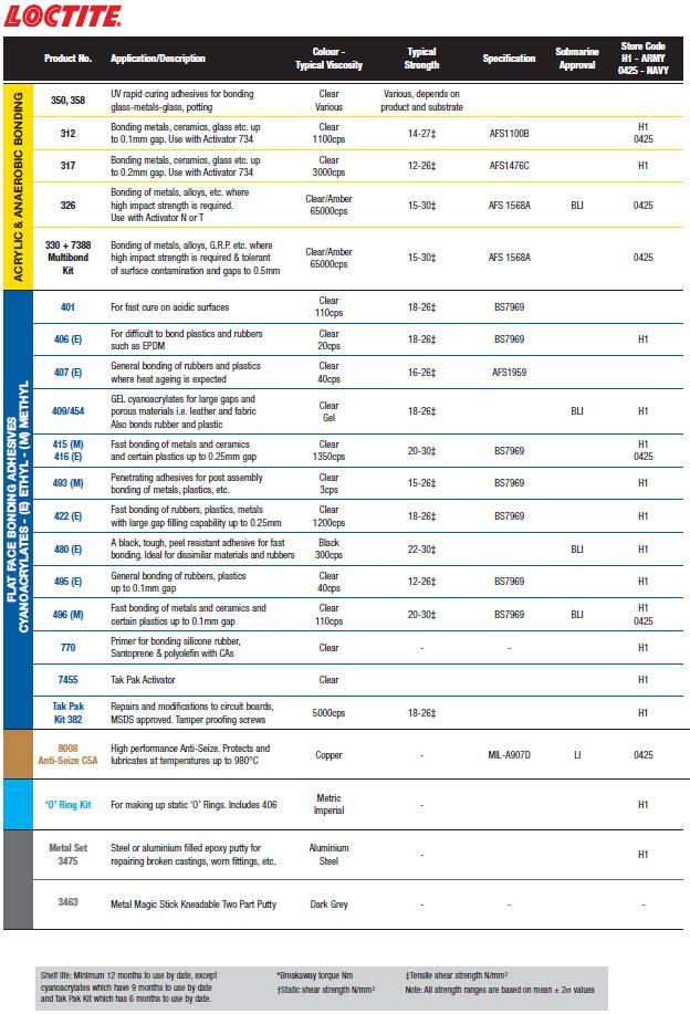

                                                      I found this on my computer it may be of interest to someone.
