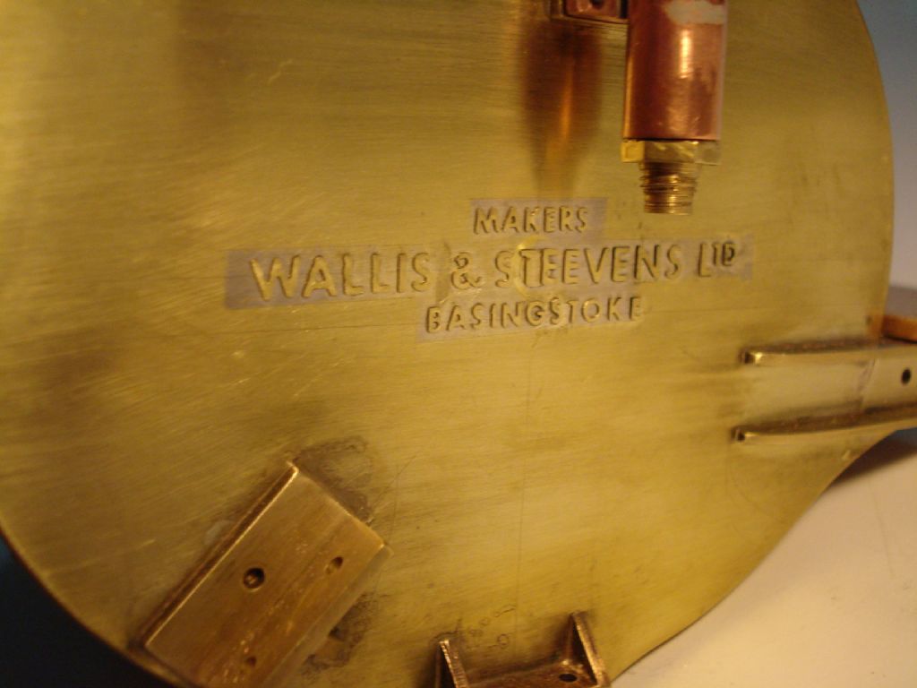

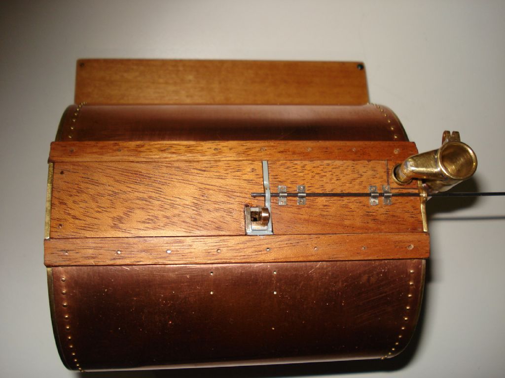

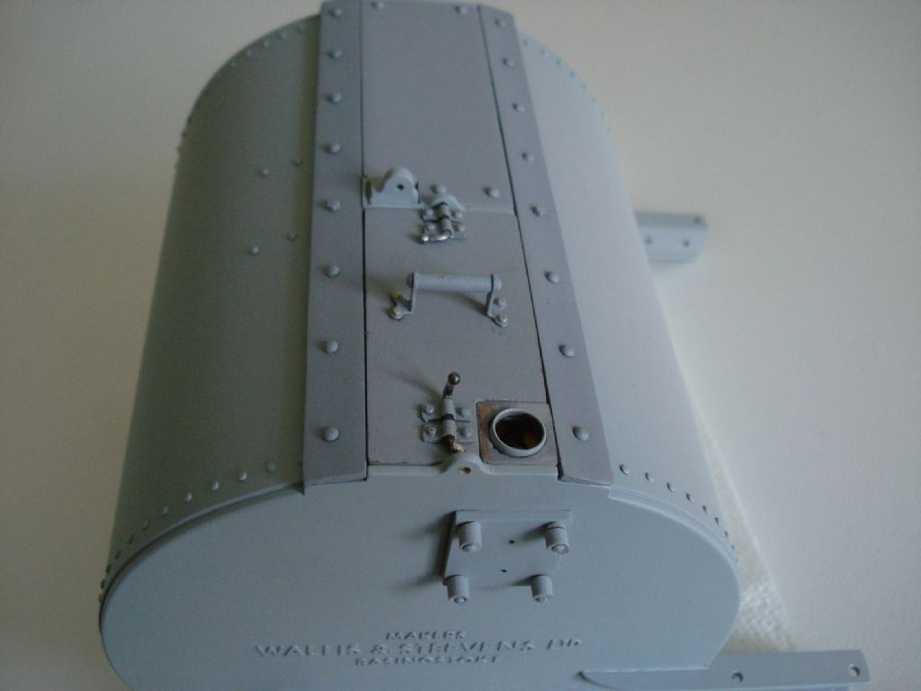

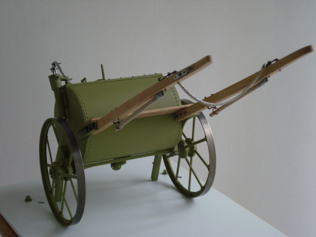

      I'm getting close to the top coat stage of this scratch build project now.
      Complied with the early original design option of using wood for the top areas and tank lid. I've used mahogany where they probably used elm?-

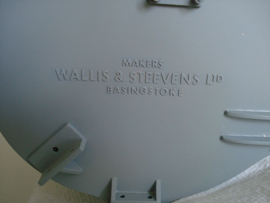

      I was glad to get past the job of soldering the individual letters onto the tank end plates-
      Not perfect, as a couple of letters had moved slightly and I had to make the Ampersands (& ) from bits in 3mm height lettering, but hopefully won't show from behind the wheels. A reasonable representation of the 'cast in' pattern of the original and looks better after a coat of 2 part etch primer-
      Most of the tank lid furniture is made from nickel silver and fixed with 1/32" rivets-
      More finishing to do on the woodwork, then it's ready for the drab matt green top coat.

        #514012
        William Chitham
          @williamchitham75949
          That's beautiful. Are the letters commercially available or did you make them somehow and looking at the album how did you do the wheel hubs, are they cast?
          William.
          #514023
          Dalboy
            @dalboy
            Great workmanship I just looked through what you had done to get to this stage and it does seem a shame to have painted it, but when you are trying to get it looking like the original I understand why.
            #514026
            Jeff Dayman
              @jeffdayman43397
              Top notch work Richard!
              #517092
              Richard S2
                @richards2
                Thanks all for the positive responses. I replied to William via PM same day.

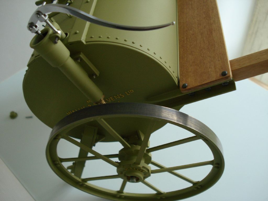

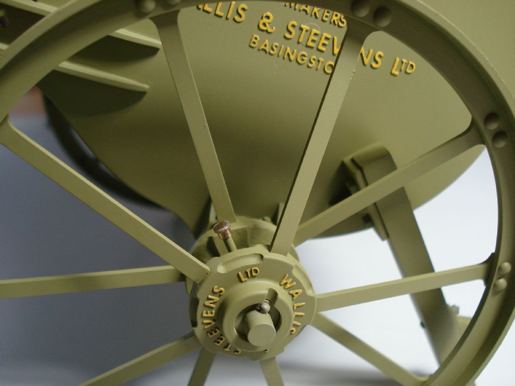

                Yep!, bit of a shame Derek, but needs must. Made fair progress on the main paint and picked out the raised lettering. Rather intense concentration trying to paint these with a 6 bristle sable brush and a x5 dioptra Loupe. This is the only pic at the moment-
                Need to get some more matt varnish for final coat before proper assembly. Reasonably pleased with the finish considering my tired old Airbrush (Badger 200) is now 45 years old.
                Regards

                  The only comment I make on your lettering is this: To anyone versed in the history of lettering design, the style you have chosen does not match the date of the original. Unless of course, your water cart was made after about 1927. In typeface terms, it might be Futura, or Spartan, or one or two others – I would need to see other letters to be more certain.
                  I wonder if there is enough interest in this 'arcane corner' of design history (from an ME point of view) for an article about matching the letters to the job?
                  Regards – Tim (who once, long ago, designed typefaces for Amstrad)

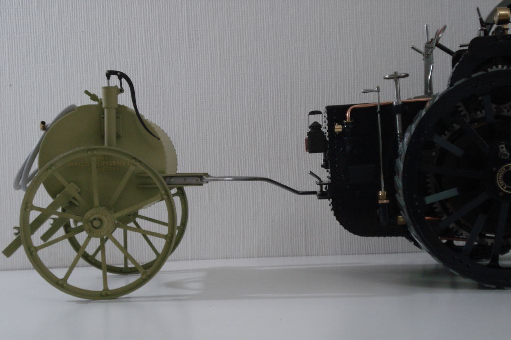

                      So continuing with this reasonable representation of the brand's model, I managed to dull the finish on the shiny wheel tread faces and now seem to look better-
                      Nearly finished, and just the Drawabar to make that will replace the shafts. It can then be hooked up to the Modded Minnie TE-

                        Now the Minnie T/Engine is back in one piece on 'all fours', I've finished fabricating the alternative drawbar for this cart. Trial fit –0620f517-f7b0-4793-a305-a7a7becec7b2_1_201_a.jpeg
                        Just the painting of the drawbar and some plumbing/hose parts to do and it will be finished.

                                Thank you. I did use images of full sized examples for research initially and my available stock of lettering was close enough for me.
                                I had no intention of making more lettering to a presupposed idea of what it may have looked like around 1900.
                                So for anyone who is bothered by it, can peruse the images of a full size Cart example on this – LINK – for another comparison. I can't post them (or others) into this Topic, as they are copyrighted.
