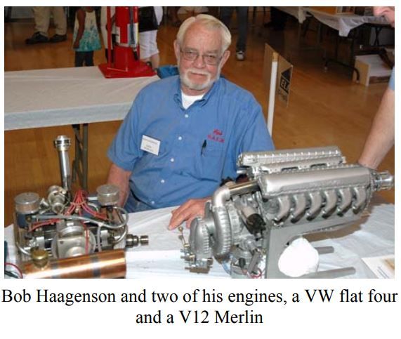

              #378918
                So your internet search did not show that Youtube video of a running model VW engine?
                Still of the engine and it's builder
                Edited By JasonB on 03/11/2018 07:58:46

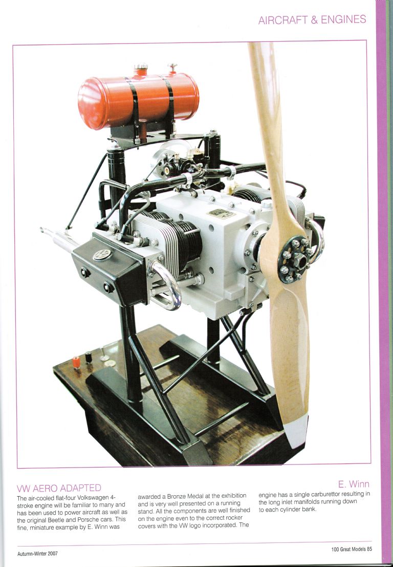

                  #378924
                    I was assuming you meant a beetle engine as there is also the aero engine, This is Ed Winn's one which I have seen in the flesh as I also exhibited at the same event this photo was taken at
                    Same engine featured in ME special
                    Edited By JasonB on 03/11/2018 08:24:06
