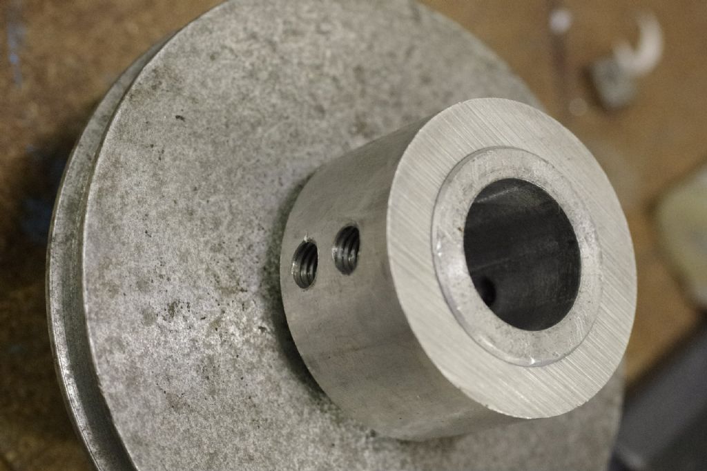

      I have an Invertec Optidrive E3 vfd, and it has been driving my mill for just over 2 years now.The motor shaft on the mill driving the pulley suffered serious damage recently. The drive was through a grub screw(I know not good) & I had ignored the occasional noises coming from the vicinity of the motor. I had to remove the armature to clean up the shaft, & fabricate a better drive to the pulley. The motor is now back on the mill & connected to the vfd. I have gone through the parameter settings, & there are three mometry switches controlling Fwd,Reverse & stop & a 10k 10 turn potentiometer. The problem I am now experiencing is that on the default frequency of 50Hz & the pot on max, the vfd shows 1.6Hz and the motor revs are low, somewhere about 20 to 30 revs. If I change the po1 setting to 500Hz which is the max setting,the vfd shows 16.6Hz the motor turns faster but is not a usable speed. The pot does reduce the speed, which suggests to me it is ok. So what do people think is the motor on its way out, or does the fault lie with the vfd, though no fault code has ever been displayed. I would appreciate your thoughts. Regards Lynne

                    My thanks to all who have responded to my post. When I installed the vfd I did use the Inverter Drives set up parameters & as i said in post it has been working fine for two & a half years. After the pulley trauma I did check the vfd parameter settings, & they were all over the place, but at this point repair of the shaft was my priority. The wiring to the motor was only removed at the vfd & I don't think that the phases are connected to the vfd in any particular order, only to reverse two phases if the direction is not correct. The switches are wired correctly as they work fine. I did reset the defaults to the factory settings & then followed the Inverter Drives parameter set up chart. I do have access to mains 3 phase but it means removing the motor & transporting it elswhere, but at least that will prove out the motor. OLD MART. Thanks for posting the pictures & link. I am still using the one grub which locates onto an area of flat on the shaft, & I will up this to two. I like the key, but I do not have a big dia of shaft to play with. No one has suggested that the vfd is faulty, & , if it is faultyI am reluctant to shell out on a new vfd two and a half years is poor. I still have the original motor, & I did'nt ditch the belt system. Regards, Lynne
