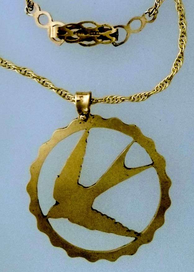

              Just to be clear; what I am thinking about is jewellery-scale work [for argument’s sake, let’s say a work area within 10mm diameter]
              Logic suggests that there must be some ‘transition point’ at which the preferred method of working switches from using a saw to simply drilling a hole and proceeding with files … and that transition-point might differ according to how well one can use the saw.
              #730297
              Gary Wooding
                @garywooding25363
                The swallow is 20mm diam, and the clasp 15 x 8mm.Swallow & Clasp
                #730300

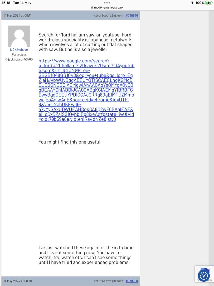

                              Search for ‘ford hallam saw’ on youtube. Ford world-class speciality is japanese metalwork which involves a lot of cutting out flat shapes with saw. But he is also a jeweller.
                              https://www.google.com/search?q=ford%20hallam%20saw%20site%3Ayoutube.com&rlz=1C1ONGR_en-GBGB1048GB1048&oq=you+tube&gs_lcrp=EgZjaHJvbWUyBggAEEUYOTISCAEQLhgKGMcBGLEDGNEDGIAEMgwIAhAAGAoYsQMYgAQyCQgDEAAYChiABDIJCAQQABgKGIAEMgYIBRBFGDwyBggGEEUYPDIGCAcQRRg80gEIMTU2MmowajeoAgiwAgE&sourceid=chrome&ie=UTF-8&ved=2ahUKEwiI5-a7yYyGAxUDWUEAHSdkDA8Q2wF6BAgIEAE&ei=oQxDZsiSGIOyhbIPp8ixeA#fpstate=ive&vld=cid:79b59a8e,vid:ehiRa4dNZe8,st:0
                              You might find this one useful
                              I’ve just watched these again for the xxth time and I learnt something new. You have to watch, try, watch etc. I can’t see some things until I have tried and experienced problems.
