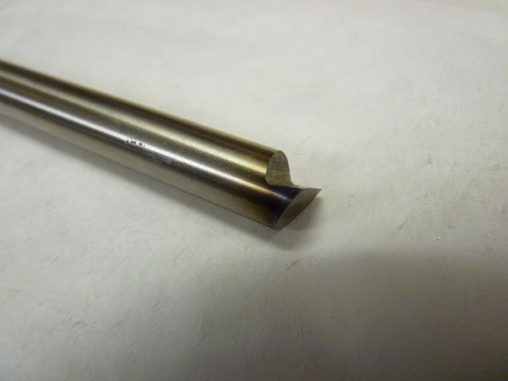

                                          HasBean
                                            @hasbean
                                            I ground this one up a few years ago
                                            I seem to think it worked well enough but I gave up with it for reasons I can't remember dont know
                                            I might give it another whirl now the topic has resurfaced.
                                            Paul
