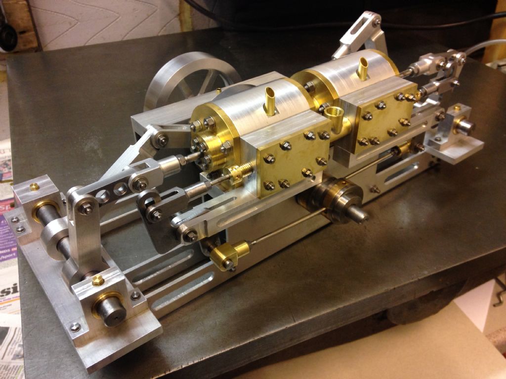

      Good day everyone.
      I was wondering if anyone had built the model drawn up by Julius de Waal and what if anything was problematic.
      Any advice will be gratefully received.
      David S.

        Roger Clark
          @rogerclark
          Probably better to use These on HMEM's site, Julius de Waals cad tends to be inaccurate and not build tested, just my own personal view

            @astroud
            Hi David
            Yes I have and do not remember any problems apart from one or two minor dimensions not shown but easy to either derive or choose to suit.
            I did freelance some features
            Andrew

              Jager
                @jager
                Roger, that HMEM build is truly spectacular with circa 1300 components but I fear that a combination of an inadequate skill set plus remaining life expectancy tells me it is not for me.
                I shall heed your cautious advice but will probably follow de Waal, constantly checking the accuracy of his CAD.
                David.

                gary
                  @gary44937
                  i built one and found no problems. i do remember having to ease all the linkages to get it to run though. good luck gary

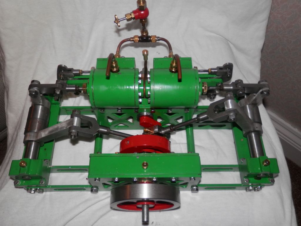

                  Chris Gunn
                    @chrisgunn36534
                    I did one as well, just had usual fettling to make it run nicely. Chris Gunnp2033376.jpg

                    Jager
                      @jager
                      Thank you one and all for your assistance.
                      I have decided to follow De Walls drawings, exercising due caution and probably modifing as I go. Some of the design feature appear to be disproportionate. Time will tell.
