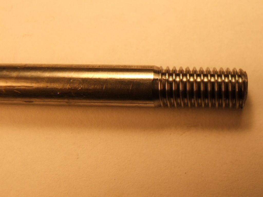

      Having been to a traction engine meeting yesterday and got thoroughly depressed 'cause the other wheels on display were a damn sight better than mine, I decided to abandon work on the engine today and give the Britan repetition lathe a run for its money.
      I've only cut a thread on the end of a rod, but it's a start! Here's the set up, 1/4" steel rod (EN3B) in the dead length collet and a 1/2" Coventry diehead in the second tailstock shaft:
      Spindle speed was about 112rpm and the tailstock was hand fed up to the stop, at which point the diehead carries on a bit and then pulls off. I like Coventry dieheads; when they're set up correctly they produce really nice threads:
      The thread is 1/4" BSF. Now I can churn out all the studs for my traction engines. It's only a small step, but the journey doesn't begin until you've made the first step.

          Well done Andrew – that looks nice.
          Now how about a few at 8BA ……………

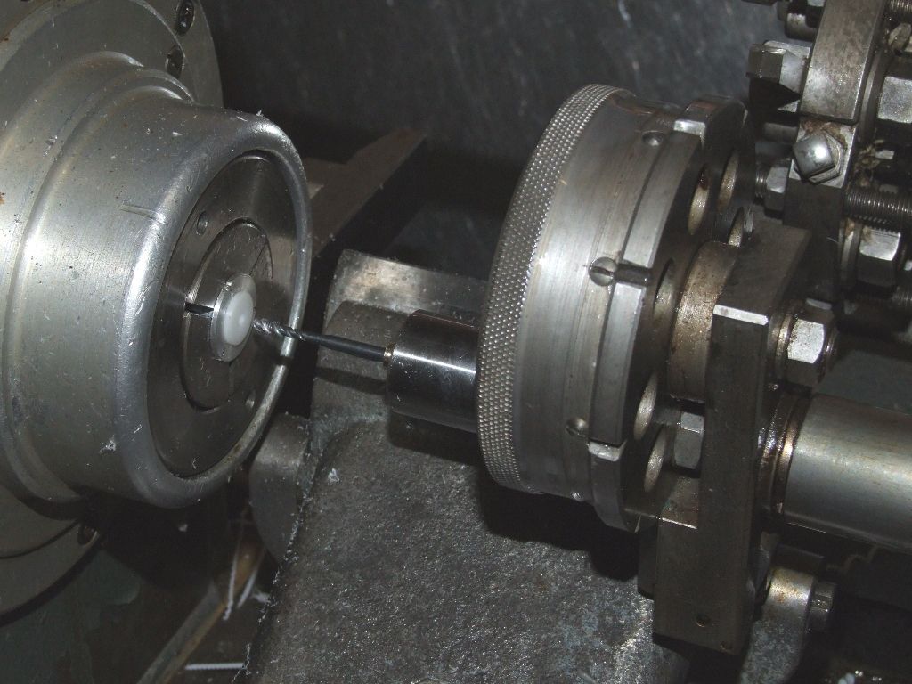

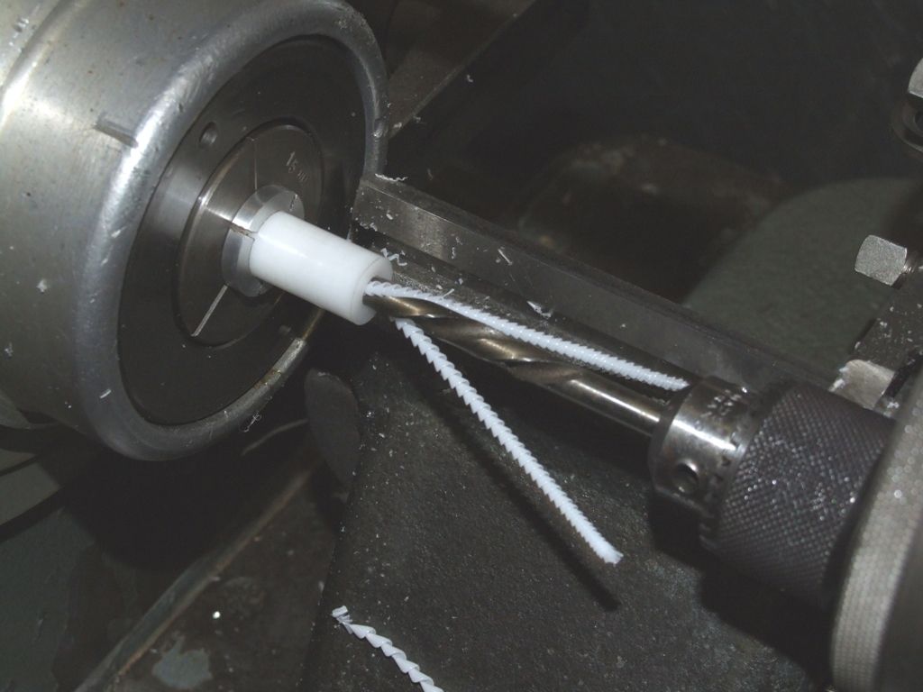

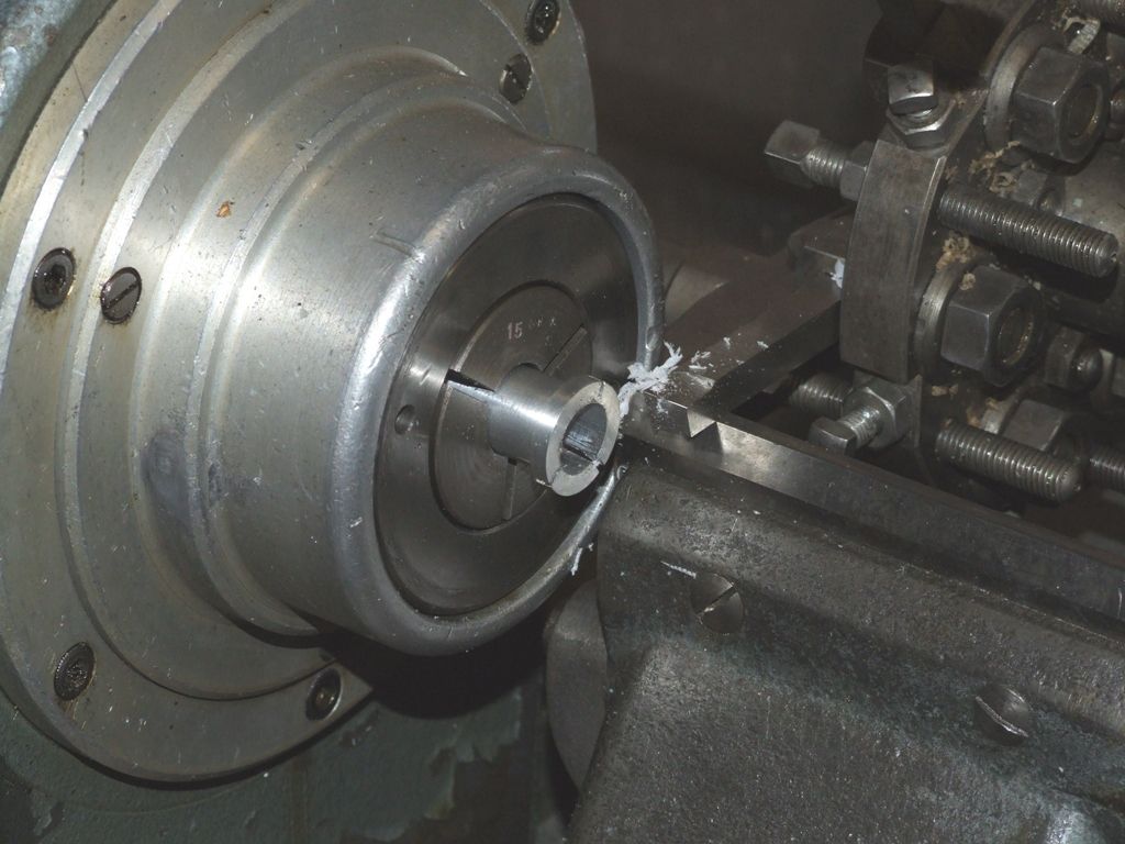

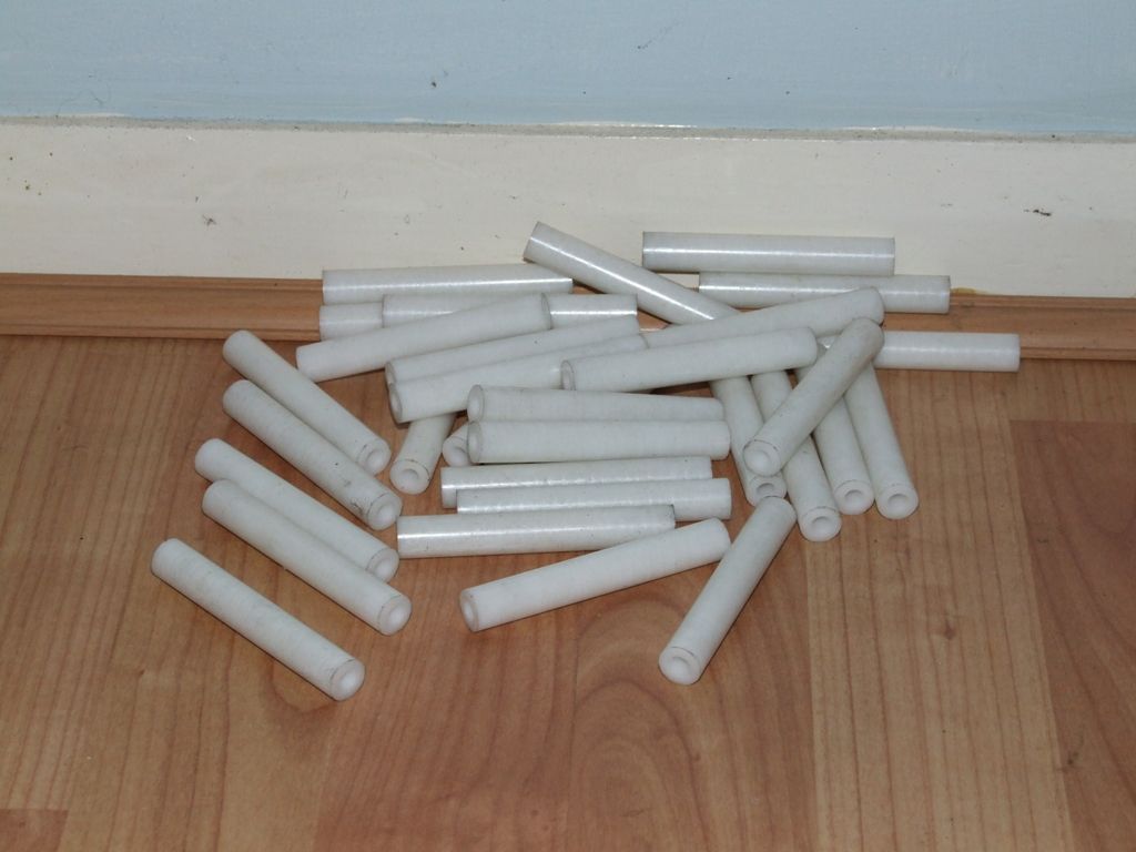

                            Finally the Britan is paying its way. As part of a set of plastic production jigs I am making for a client I needed 33 spacers, each 80.65 ±0.05mm long, with a 5.8mm hole in each end for a threaded metal insert.
                            It's long been a PITA facing items to an accurate length on my conventional lathe; face off, take the part out, measure it, put it back, take a bit more off and so on. Things are not helped by having a Burnerd multisize collet chuck, which is not dead length, on my conventional lathe. Due to the design of the jig it is important that the spacers are consistent on length as it controls how the internal parts clamp together. Here are the finished spacers:
                            The plastic (delrin) is nominally 12mm diameter, in practise it is 12.4mm. I don't have a collet for the Britan of that size, so I made an aluminium split collet to fit a 15mm Britan collet:
                            One end of each spacer was cleaned up on my conventional lathe. I then fitted the backstop to the Britan and using the adjustment screw crept up on the correct length for the spacer. Once set up it only took about 15 seconds per spacer to face off to the correct length:
                            I then used a centre drill (left hand) to centre each end:
                            And a 5.8mm drill, also lefthand, to drill the holes:
                            The centre and drill were separate operations, as I haven't worked out yet how to cope with the very different lengths of the centre drill and jobbers drill when they are mounted together. I'm really pleased with the operation of the Britan, it made what is normally a tedious and long winded job very simple. Doesn't happen often, but definitely one of my better buys.
                            I quoted a fixed price to make the jigs, so I'm feeling rather smug that these parts took a lot less time than I budgeted. Tomorrow I'll make up a simple adaptor to fit the threaded inserts, while ensuring that they go in square.

                                        Wouldnt bother with centre drill wth a 5.8, certainly in acetal.
                                        Work with it all the time for valves needing a cock on critical 1.3mm hole, i swage a 1.5mm silver steel in.
                                        4 operations?
                                        Face off, drill and part off. Turn round set to a stop and drill?

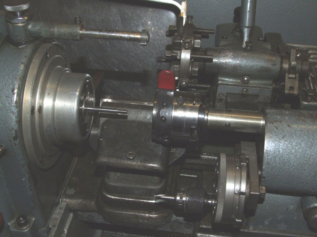

                                                Another first for me, machine tapping on a lathe. I've machine tapped thousands of holes on vertical and CNC mills, but never done so on a lathe; before now. Here's a picture of the setup:
                                                The tap is M3, spiral flute, in a holder with a one way clutch. In other words the holder will drive the tap until it pulls out and disengages the drive, but in reverse it always drives the tap. After a tentative start on slow speeds, 56 and 112rpm, I finally settled on 562rpm for the tapping. The procedure was to start the lathe in reverse, ie, conventional direction for a normal lathe. Feed the tap in up to the preset stop on the tailstock. After another couple of turns the tap holder disengages and the tap spins with the spindle, then knock the spindle into reverse, just hit the reversing lever, no need to stop the lathe. The tap holder engages and reverses the tap out. Job done, takes much longer to write about it than to do it.
                                                It took me less than 45 minutes to thread 32 parts this afternoon, including making a split brass bush to hold the tap, the initial tentative experiments and a few tests with an M3 bolt to make sure that I really was cutting a thread.

                                                  I probably would NOT have used a c/drill unless a lead in for the insert was required.
                                                  If only doing 35off, you might find it better to 'opp' it, rather than worry about drill lenghts etc. Good pratice though.

                                                      Yes the drill should start fine in plastics for a simple spacer insert.Peck, clear, then drill, clearing it as required. One thing you really will notice, is the 'feel' you will get from the drill, whilst drilling. If drilling a bit deep (20/30mm), I'd use a suds brush to dab on some suds and clear the drill at the same time. As you will know, drilling plastic fast, the drill will get very hot!
