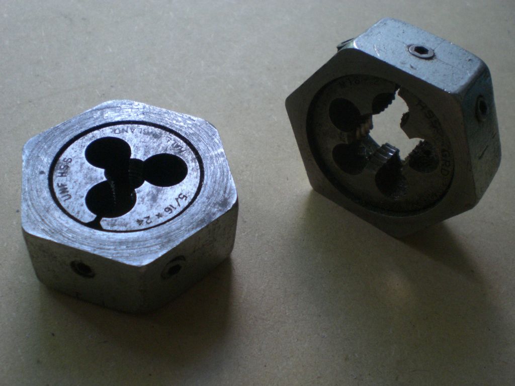

      I cut a lot of large whitworth /unc threads usually on the lathe and then run a hex nut die down them to clean them up.
      Sometimes its hard work just cleaning the thread up removing a small amount of material.
      On a woodworking forum someone has a 1.5inch 6tpi split die and they are wanting to cut threads just with this.
      is it at all possible on steel?
      what would the forum say is the biggest thread that you can cut with a die from scratch on sized steel?

                  Yes i meant a round split die so it could be opened up a little to start it off
                  the large dies i have are all hex nut type so i generally use a big pair of stiltsons to run them down
                  I just cant imagine trying to do a 6tpi whit over 1” from scratch or even trying to tap with a set of 3 taps
                      So far as I'm concerned die-nuts as you describe are purely for cleaning up slightly damaged or rusty threads, not cutting them from scratch.

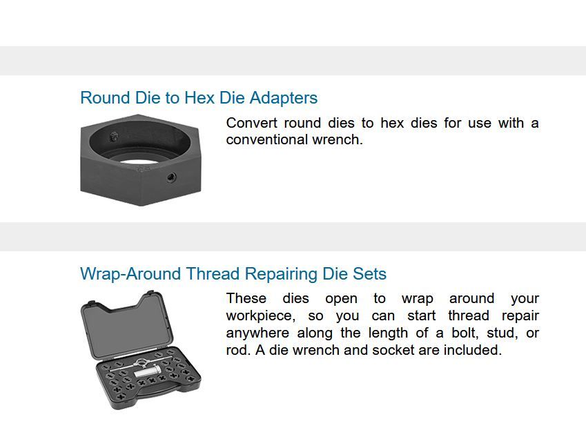

                                  The McMaster website shows Hex Dies as thread repair as per UK practice but they do show the conversion holder in the clip below.
                                  Would be easy to mage similar at home
                                  Steve

                                        I do screwcut on the lathe to size but i run the hex nut dies down after just to make sure they are the right fit
                                        i make chuck adapters for woodworking lathes and its surprising how many dont fit even though I’ve used my spindle or sample threads or nuts so I’ve found that running the tap/die down my cut thread makes them work.
                                        the other day i had a chap send me a commercial 1 3/8 6tpi whit adapter that would not go on his lathe he sent it to me it wouldn’t go on my dummy spindle but running a tap down it cleaned it up..didn’t seem to remove any metal..but afterwards it went on my spindle and the customer was happy.
                                        My original post was about someone agin on a woodwork forum who wanted a die holder 3 1/8” dia to use his round split die to cut a male 1.5 “ 6tpi on a steel bar… I dont think that would be possible at all…but ill stand corrected if someone says they can do it…

                                          Hi, I made a couple of round to hex adapters out of a couple of 30mm nuts, 15 years or so ago when we had a breakdown at work and the only way to clean up a couple of threads was a couple of hex dies which we didn't have in those sizes at the time. Never had seen any adapters before.
                                          Regards Nick.
