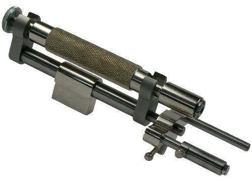

      Hello all.
      Just received this unusual hand held knurling tool from Ebay.
      It's quite neat and works well. Never seen one like it but it may be something from industry.
      I did a test piece shown above it and the diamond pattern was very tidy.

          I like that yes
          Maybe designed by someone who owned a Pipe-Cutter ?
          Edit: https://www.horia.ch/en/Products/Knurlingtools/Knurlingtools/Knurling-tool.html
          Edited By Michael Gilligan on 22/03/2019 14:59:45

            Interesting that there are apparently three knurling wheels; also that you were able to traverse by hand.
            A set of these with the knurl type indicated by the knurling on the handle would be good.

              It moved smoothly along the work with just a little sideways pressure. The only thing I cant fathom is the cylindrical boss on the end with the two wheels. Looks like it could be a mounting lug but I'm not sure.
              Obviously knurling pressure is varied by squeezing the pistol grip.

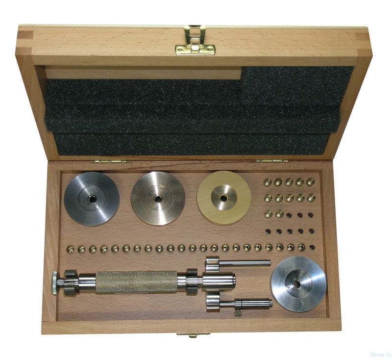

                  Michael many thanks for the link. There it is still in production.
                  I'm a bit confused, not being of a horological persuasion, as to why such a tool is manufactured by a precision clock and watch tool maker.
                  Its capacity is 3 to 25mm which seems quite big for a watch maker. The spare Knurls also look quite coarse.
                  Is this just for horology or a general tool? Seems everything else on their site is just for watch making.
                  Regards mMic

                    I have one and it is used generally in Instrument work right up to the collets.
                    It was part of the inventory for the Service Dept. at Leica and I aquired it on close down of a satellite workshop that was not making money, I asked what I should do with the kit and was told to dump it!
                    Yes, into my tool box

                      Plasma, one use in clock making that I can think of would be knurled clock case feet but seems kind of expensive for that.

                        Certainly on the large side for making watch parts
                        … but just right for making parts for watchmaking tools
                        https://www.horia.ch/en/Products/Polishing-screws/Lathe/Polishing-screws-lathe-in-his-box.html
                        Perhaps they originally made them for use in-house, and then realised that there was a market.
                        Clive's comment would appear to support this hypothesis.
