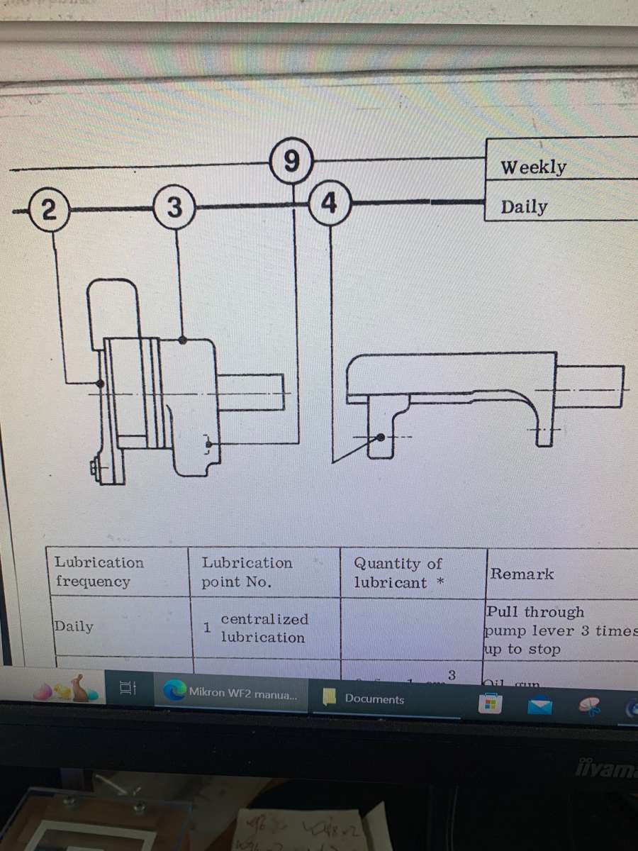

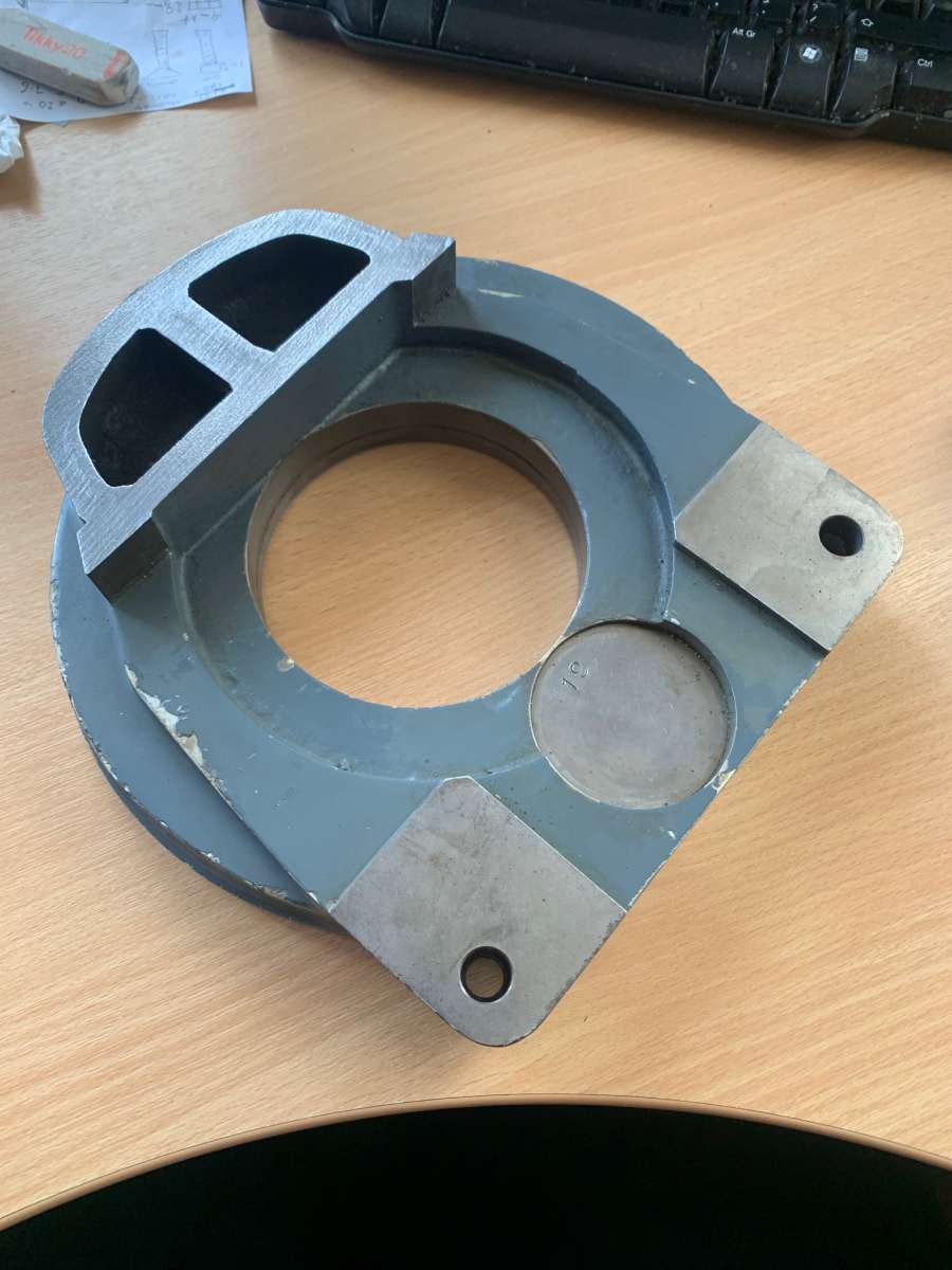

      My project is to fit an Aciera F4 slotting head to a Mikron WF2 mill. I have cut off the F4 dovetail support arm and need to mount in its place a cylindrical support arm. The F4 arm is of a lattice construction (ie it is cast with weight-saving pockets) so my plan is essentially to weld a plate (275 or 355 steel) onto the stub of the F4 arm and then weld a 355 steel cylinder onto the plate. My concern is the weldability of the F4 arm cast iron because the person doing the welding is an expert at welding 275 and 355 construction steels ( RSJ’s etc) but not so much cast iron. He has laid down a trial bead of weld on the scrap piece of the arm and it looks ok but of course no way to test how strong the weld really is. Can anyone tell me or speculate on the type of cast iron the Aciera F4 arm is and its weldability in order to match the appropriate welding technique/rod to make this a good weld? In particular, quality swiss machines all seem to have castings that are immune to rust which might point to a particular type of iron used. On cutting the arm off with an industrial power band saw it cut well with plenty of suds and produced a fine black powder typical of cast iron machining.
      #718463
      Adam Harris
        @adamharris13683
        IMG_5421
        #718464
        Adam Harris
          @adamharris13683
          IMG_5423
          #718479
          Adam Harris
            @adamharris13683
            FYI both the WF2 horizontal milling support arm and the slotting head have a 62mm diameter solid cylinder that slides into a socket on the face of the WF2. At the end of this socket is a drive dog that drives the vertical milling head (which has a hollow 62mm diameter cylinder within which is a shaft connecting to the vertical spindle via bevel gears)

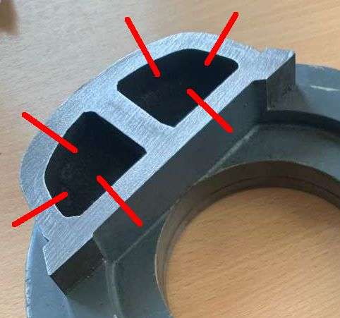

                I would be shaping some steel to fit reasonably into the lattice holes, gluing it in with the very best metallized epoxy I could buy (JB Weld plus) so the entire space is filled and attaching my steel plate to that. You could drill and tap sideways into the infill plugs if you were not confident of the epoxy joint. With countersunk fasteners, some filler over the heads would resore the original casting shape and make it look as if nothing had happened.

                    Thanks DC but how to “attach” the steel plate to the filled stub? The weight of the slotting head is about 35 kgs and needs to be absolutely rigid – albeit there are going to be 3x M12 bolts assisting mounting to the face of the WF2 , the cylindrical arm is the main support. Also I need to machine the fixed plate perfectly flat before mounting the cylinder to the plate, and when welding the cylinder to the plate won’t the heat impact the epoxy underneath the plate?

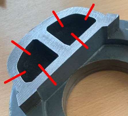

                        Fabricate, stress relieve and machine true every piece of steel that is going to be attached to the cast iron (hole-filling stubs, flat plate, cylinder). Machine the back of the cast iron level and true. Squirt some glue into the holes. Plunge in the fabricated component and clamp together. You will need some kind of fixture/jig/scaffolding to assure left/right and up/down alignment.
                        Once the glue has set, the two lattice holes will be solidly filled (no air space). As above, drill though horizontally or from the front and put in some bolts or fitted pins with loctite to make sure nothing moves.
                        The difficulty with welding onto the cast iron piece that you have is that the heat may distort it and you have no excess material to true it back up again.
                        Edit: confidence bolts could go where the six red lines are.

                              DC I can’t put screws or dowel pins into the plate through from the reverse (front) side as that is where the circular T slot lies and I don’t want to interfere with the nice sliding action of the beautifully profiled T nuts. Are you thinking the cylinder should be welded to the plate before assembly and fixing the plate to the filled stub with screws?
                              #718532
                              Adam Harris
                                @adamharris13683
                                DC it could be a possibility if I used some 10mm angle steel I have as the plate, with the perpendicular side lying against the underside of the stub, thereby directly assisting support of the weight of the slotting head, and then I could also screw through that underside part of the angle plate into the (under)side of the filled stub…

                                              DC31k
                                                @dc31k
                                                I edited my post to add a photo, possibly after you read it, but this morning the photo has disappeared.
                                                bolts
                                                You can avoid bolting from the front. The only place you would drill for bolts (or pins) would be in a part of the cast item that is currently painted grey. For each half, one bolt in the underside; one bolt on the sloping side and one bolt on the (less sloping) top.
                                                For the steel stubs that go into the casting lattice holes, I would aim for a nominal 2mm clearance on all five sides and maybe look for a fluid epoxy that I could inject once the two parts are assembled and aligned.
                                                As above, drilled and reamed holes with mild steel pins loctited in and then the surface filed flush with the casting  would look tidy. Using pins would also expand your positioning options – with bolts coming in from three directions, you have to make sure they do not clash and that ther eis a minimum distance between the female threads.
                                                Perhaps as a modification to the angle you suggest, mill a small flat on the underside that is perpendicular to the sawn face. Then make a step on the welded fabrication. The casting would sit on that step. That would also greatly assist alignment (reduce your fixturing requirements) as it stops the assembly trying to rotate.
