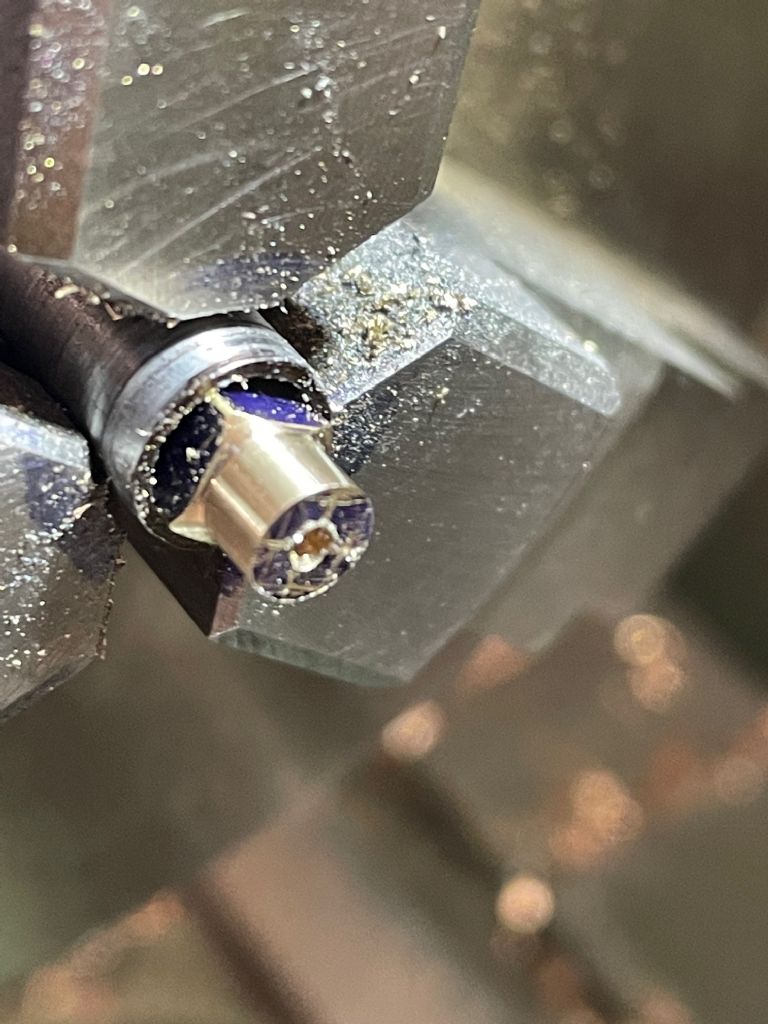

      Making the big end for Stuart Models oscillating engine I need to turn a short length (1/2 inch) of 3/16 square stock. My 4 jaw is too big, and I don't have any square collets. I am thinking of milling a slot just under 3/16 deep in round bar and holding that in the 4 jaw. Is that a sensible option, or are there any other methods I could employ?

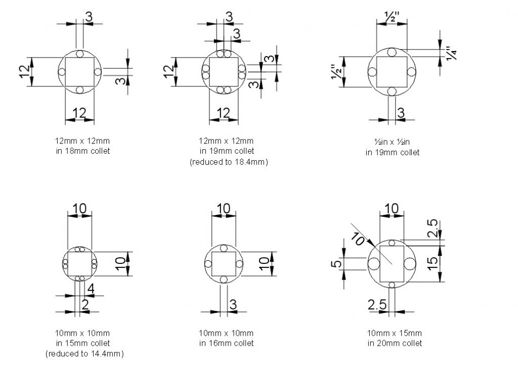

                            It just so happens that I wrote a short article for MEW – issue 285, page 67 – not available in the archive, yet, on this very subject. In the article, I stressed that it was strictly a get you out of pickle solution and not suitable for mass production. The snip below is a screenshot of the drawing which accompanied the article. I hope it's self-explanatory:
                            It's in metric, but the same principle applies to Imperial.

                                  Being new to ME it never fails to amaze me how many different solutions there are for a given problem, or how knowledgeable and helpful the folk on this forum are – this is the 4th time this year the forum have helped me solve a problem, and with multiple solutions to each. I decided to start with the slit bush method using the square stock provided with the Stuart kit, and got pretty good results as per pic. The accuracy achieved was such that there seemed no point switching to the 4 jaw. I now intend to try the other methods suggested as part of my learning process, and also to purchase a smaller diameter 4 jaw as I intend to focus on small modes initially and the need will clearly arise again. John, I subscribe to MEW print and online so will lookout for your article, though as you say the screenshot is self explanatory. Thanks again, will no doubt be back soon with another question!
