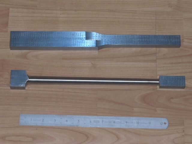

                Anonymous
                  If you've got the speed and feed correct there shouldn't be chatter or vibration; thump, thump, thump yes, but that's not the same thing. Personally I'd use carbide inserts. The idea that they don't like interrupted cuts is outdated. The top bar was reduced to the bottom bar on the lathe, with a round carbide insert at 800rpm and 4 thou/rev feed:
                  Like this:
