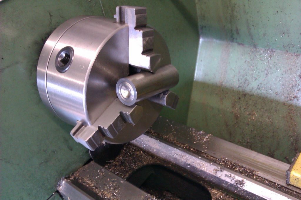

      I have a basic model engine kit of parts and plans and one of the tasks is to machine a cylindrical brass bar down to form a semi circular cross section bar. . This seems quite wasteful but getting over this hurdle can people please give me some advice on how i might achieve this using only a lathe?
      The finished item will have a slot cut along its length so I am able to drill the bar across its diameter a couple of times to aid mounting on a face plate and i have a 4 jaw chuck which might help in holding the piece although i have significant doubts about the stability of doing this.
      The supplied cylindrical bar stock is only 1/8" longer than the finished piece needs to be.
      Many thanks

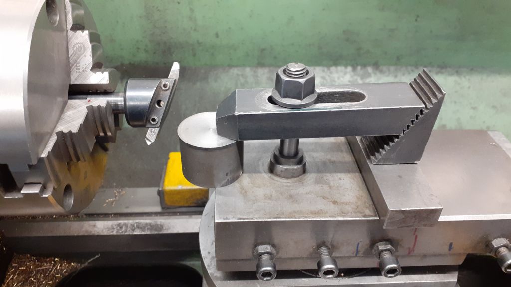

          Depending on length and diameter I would probably face the two ends down to final length to make them square to the cylindrical face and give you two surfaces that can be clamped.
          Then you can take off the toolpost and stand the cylinder on end where the toolpost fitted, pack up if needed and then clamp it down with just over half overhanging the edge of the topslide.
          You can now flycut the side of the cylinder making a number of passes with the cross slide.
          Nearest video I have showing the basic method
          4-jaw would have worked if you were removing less than half but not in this case. If you have a vertical slide with vice that is another good option.

                Quick piccy may help with suggested setup. Sounds a bit like a crankshaft balance weight to me. You could saw off most of the "waste" material and save it for a rainy day
                Edited By JasonB on 03/03/2023 11:02:23

                          Thank you for your quick replies, Whilst I do have experience I am coming back to this after nearly 40 years away plus i don't have access to the facilities I had back then.
                          I was tempted to screw (using brass screws) a block on the side of the 5/8" dia cylinder and clamp it in a 4 jaw chuck to face off, or clamp the same in to the tool post and use an end mill in the lathe chuck to machine it.
                          I think facing off the cylinder with block on the side in the 4 jaw chuck might be easier to align. What do you think?
                          Rats! Mad that this might seem I have just realised I don't have any scrap square section bar to bolt it to, I might as well buy some half round bar!
                          Edited By Paul McDonough on 03/03/2023 11:31:18
                          Edited By Paul McDonough on 03/03/2023 11:37:51
