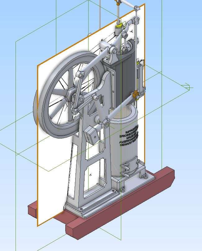

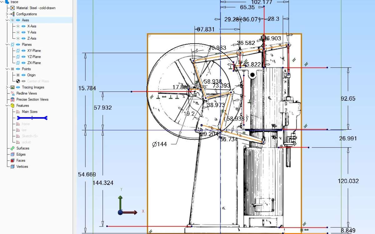

      Specifically, using an imported elevation as a “sketch” base.
      Having found at last a key area where I kept going wrong in TurboCAD I have started re-drawing the GA, orthographically, for my steam-lorry engine.
      This is so I can design each component in place without needing draw it fully – that is for a later detail drawing – so I can “seed” it at the same time as establishing its relationship to the rest.
      I need orthographic drawings for workshop use, anyway. However, if I want to model some parts and simpler sub-assemblies in 3D, I would have to use Alibre Atom and a transferable file (.DWG) for a 2D sketch foundation.
      In theory. I tried. Alibre just saved my attempts as if pictures, basically.
      So, if it is possible to open an imported .dwg file for further editing as an Alibre model, how, please?

        I have posted before with examples of how to get an DXF or DWG file to “open” as a sketch in Alibre In answer to your other queries about it.
        Once imported into Alibre as a DXF or DWG file you can open it and select all or part of the 2D drawing then copy and paste that as a sketch to start the 3D modeling.
        Can you just confirm that it is opening TC drawings in Alibre that you want rather than the other way round.

            Nigel,
            Key points are as follows.
            • Alibre will import the .DWG or .DXF into the 2D drawing workspace.
            • You have to select ‘sketch on sheet’ from the right click context menu to get into ‘edit mode’.
            • You can then select and copy figures as required.
            • copied sketch figures from the 2D drawing workspace can be pasted (or paste stamped) into 2D sketch of a 3D part workspace.
            Note also – if the imported drawing contains symbols (AutoCAD Blocks), these must be exploded.
            .DWG and .DXF files often are not well formed – it may be necessary to do some remedial tidying to get a valid profile that can be used to drive a 3D feature in Alibre.

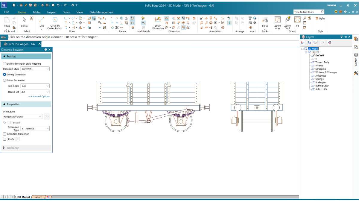

                      IanT
                        @iant
                        Yes, sorry. I don’t worry about what is going on in the ‘background’ – I’m simply exporting a DXF file from TC and then directly opening it in SE Draft. It’s very straight forward. I was agreeing with Dave in terms of committing to a single CAD system and sticking with it where ever possible
                        With regards to starting drawing from scratch or using existing work, sometimes that is easier to start over for 3D work but for some other things it most certainly isn’t..
                        Here is a simple TC 2D (DXF) file that I’ve just opened in SE Draft.  Everything is there (layers/dimensions etc) and I can use exactly the same sketching tools in SE 2D that I normally use in SE 3D modelling. I can then save this as a native SE ‘Draft’ doument either exactly ‘as is’ or amended as required. I then have no need to return to TC for this drawing ever again. As I have quite a lot of this kind of work, re-creating everything from scratch again would take a long time (even if I still had the source references to hand).
                        Regards,
                        IanT
                        (It’s really quite warm out there atm….)
                        9Ton_GA

                          It seems many have been caught out by trying to use TurboCAD in the directly-intuitive way, by the tool-bar menus. It responds better to what it calls its SEKE moves (Single-Entry Keyboard Equivalents) I had previously not used.

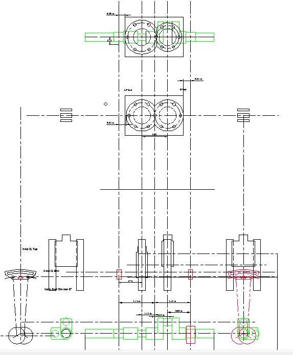

                          I am perfectly well aware this transfer business will ONLY work for a single-layer 2D image, either an orthographic elevation for use in a 3D model, or a 3D model facet to use in an orthographic drawing. Certainly not for assemblies, in either direction. I did not expect otherwise. I cannot model a complex machine in 3D in either TurboCAD or Alibre anyway, although it is possible in both.
                          As far as I know, TurboCAD has no equivalent of Alibre’s system for creating 3D Assembly images from Part ones. You need create each Part in place; but its 2D mode is very flexible for designing the whole thing.  Alibre is fine for copying old drawings as a CAD exercise, but that assumes you have both the plans and expertise. I don’t.
                          The drawing below shows what I am trying to achieve and why this method. It might not reproduce very well, being a screen-shot then converted from .png to .jpg form. The individual parts do not need much detailing on the General Arrangement; not all parts need be shown (e.g. connecting-rod one side, valve-gear the other). Nor does very part have to be drawn completely first: it is completed and located according to how the whole drawing develops.
                          I cannot create a 3D model of the whole machine in either package. So want to choose the better or easier at any stage for designing both the machine and its bits together. As this drawing progresses, I will be able to put the various parts in their right places.
                          Screenshot 2025-07-12 225052
                          I have found it far easier to export an Alibre sketch as a DWG file to TurboCAD; than vice-versa. TC opened it directly, and I did that for the expansion link in this drawing. Once I’d trimmed some extraneous stuff to make its image symmetrical, it was fairly easy to place it correctly above the crankshaft (right-hand end). The link-work on the left is more for geometrical construction purposes.
