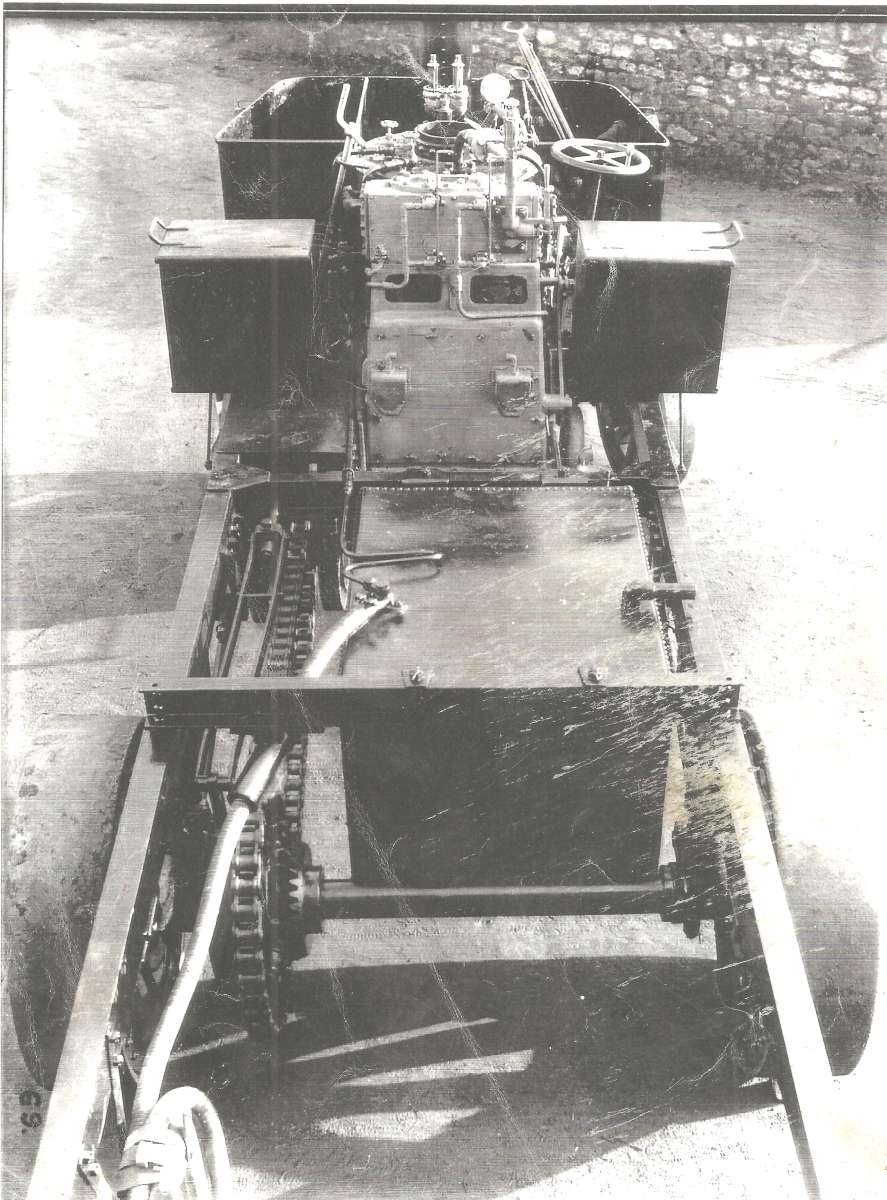

            Yes, I see that but those Edwardian designers had a lot of prior knowledge and experience, in a team of properly, apprentice-trained engineers. Their “Light Delivery Van” was their third or fourth vehicle. E.S. Hindley & Sons was already established, making a range of engineering products.  Their first steam-wagon was a spindly affair, with undertype engine and vertical boiler. They developed that experiment into their moderately successful “Standard” 5- and 7- ton undertype and its heavier-duty “Colonial” export variant.
            Then in 1908 intoduced this LDV with its vertical mid-engine – as far as I know, a unique arrangement – for 2-3 ton capacity.
            The only photograph I have that shows much of the engine is this one:
            The engine is that grey box between the seats. I know the bores and stroke but what valve-gear? What are those two pressed-steel bulges (motion-parts clearance??) capped with open elbows, on the “quickly detachable covers” as the original catalogue has it? Where is the reverser? Assuming the regulator being the globe-valve on the boiler, what is that valve with prominent lever on the off-side, HP end, near the driver’s shoulder in full-size, and working across the vehicle?
            The transmission is only thought to be 2-speed on this wagon (as we know it was on the Standards, with the gear-lever next to the rear wheel). How is it arranged? Where is its control lever?
            Where is the boiler feed-pump, invisible on all photographs?
            How does that brake work? On all the other photos it uses blocks drawn against the wheel rims.
            You see the problem…..
            I have to design something to fit a vague external outline; plus my naturally limited CAD skill enforces my peculiar work-round –  making the draughting possible but more difficult and cumbersome than it should be.
            At least when I need choose between the Myford and Harrison lathes for particular work, their operating is much the same. TurboCAD and Alibre are very different.
            I don’t have the skill to use either system for 3D assembly modelling; nor can I see how to use Alibre or similar when you have to design the Parts before you know the Assembly.
            So far I do have some engine parts made, and a library of Alibre 3D models of others. I think my best bet is to turn the Alibre models to Alibre elevation drawings, export those to TurboCAD and work exclusively in TurboCAD in orthographic mode.
            Using 3D-priority CAD is obviously easy for everyone else here, but a blind alley for me.

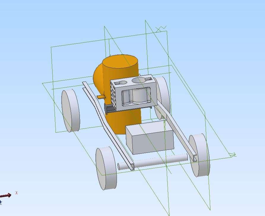

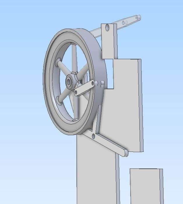

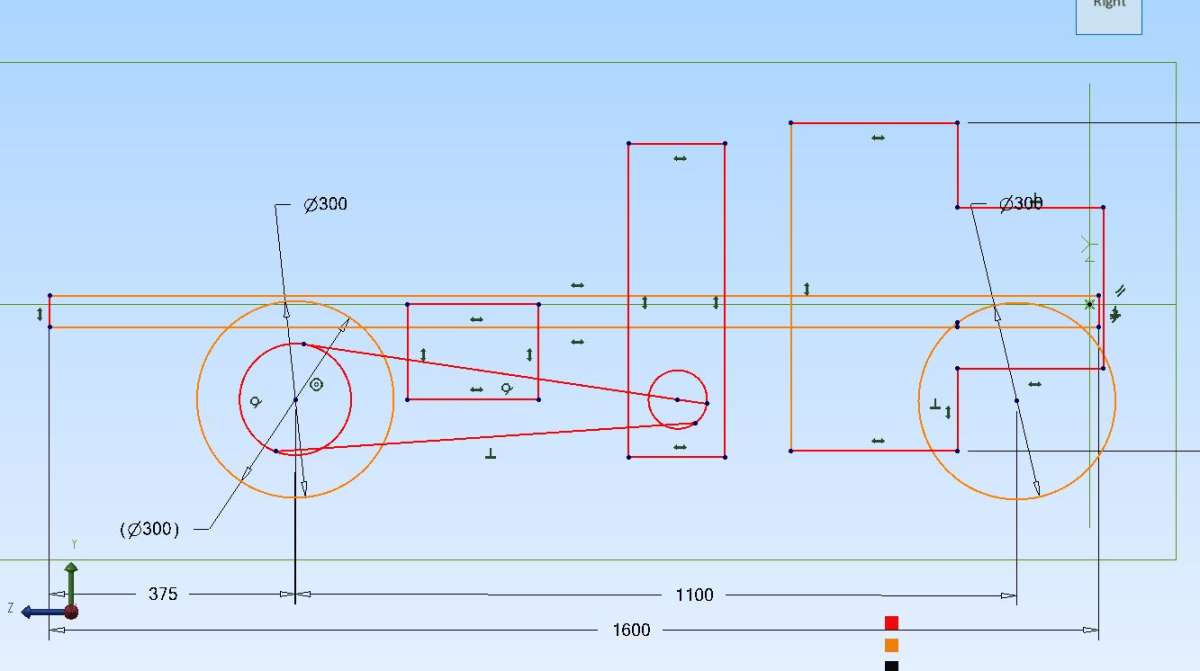

                Much like John says you start with a basic sketch just like you would do on a fag packet. Put a few simple shapes into a 2D sketch and a couple of basic sizes. Here I have just shown the chassis, engine, boiler, wheels and drive train with simple shapes. Anything can be altered at this stage.
                n fag 3
                You then start to produce some basic shapes by taking thos 2D boxes and circles and giving them some depth. Th enext stage is to start putting those shapes together, you can use the original 2D sketch to help place them if you want.
                n fag
                n fag 2
                You can still make changes, maybe the chain when it is added will clash with the tank, so alter the tank width/position.
                Then you start adding detail like the cylinder has and so on detailing wheels, chassis etc. There will be a lot of going back and forth making tweaks to an old part as newere ones are added but it is a lot better to do it on the screen than waste metal and workshop time.

                    #807336
                      Probably 10-15mins work.
                      To be fair I did have the chassis, cylinder, boiler and cross mebmer from using them to answer your other queries. Doing the rough initial sketch, adding wheels, axle, tank etc took the majority of that time.
                      It is not a lot different to the same issues you would face drawing it on paper as you would still have the same limited references and have to come up with much of the detail yourself. And if done as a simple 2D first you are only substituting a screen for the shet of paper. Take one of those examples I showed yesterday looking from a different angle, you can see all the linkages are just simple flat shapes for me to check their movement, really no different to using bits of cardboard and pins stuck into a drawing board. I only need the holes at the ends and the pivot points to se how it works, easy to alter any one and then once happy use those hole positions to develope the actual part around them like the flywheel has been, that was just a disc initially.
                      cardboard

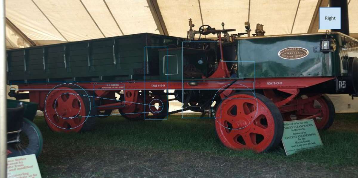

                            Is this what you’re looking to build?
                            8219764377_5794e52364_o
                            #807415
                              Image generated by AI … having skimmed data from this forum ??
                              #807416
                                One of Steam Scenes I think. Funny enough I snipped an image from the other side yesterday and was going to post this as an alternative way to start your layout. Rather than a fag packet doodle over an image but I thought that may complicate things further for Nigel. Needs a bit more scaling and some compensation for prospective.
                                fag overlay

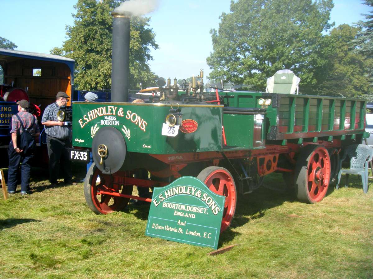

                                      No, Michael, those are genuine photographs… Taken at the Great Dorset Steam Fair some years ago.
                                      That is indeed the vehicle, or rather a modern replica. I do have those photographs, sent me by someone… or I did. I seem mysteriously to have lost quite a number of photos and all around the time the Seattle lot “up-graded” my computer from WIN-10 to 11. They might be still on my previous PC if they are not in Mickeysoft’s server “cloud” .
                                      However, I have not seen that lorry for myself. It was built to commission by Richard (‘Turbo’) Vincent and I tried to ask its owner if I could visit it, but he was reluctant to let me. Understandably, perhaps.
                                      I do not know where it is, nor if it ever appears anywhere else. I have not heard of it doing so, and of course the GDSF has died.
                                      I did though visit that replica under construction, though at that stage it was just a chassis frame on trestles, and a boiler. I think it was Mr. Vincent who sent me the photo I posted a few messages back, and he admitted having no more infomation than I did. He wondered about modifying a Sissons engine, also an inverted-vertical, enclosed machine, and I do not know if that is what the replica has.
                                      On the other hand Richard Vincent is a professional preservation engineer with far more experience and facilities than I have.

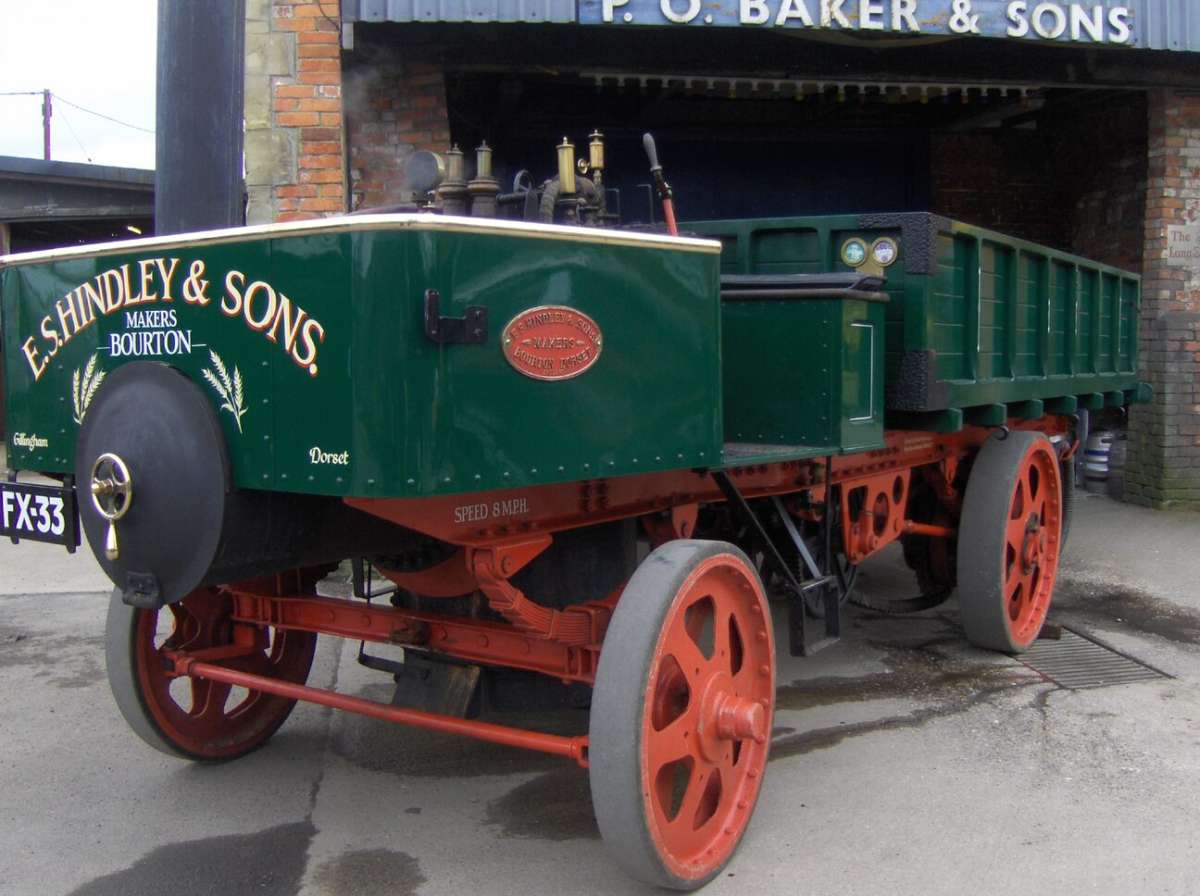

                                      Despite the low light level, that marquee photo does show the transmission is two-speed, though not how you change gear; and the peculiar way to let the steam at the engine. There is also a faint hint of a lever with trigger, below the regulator: the reverser?
                                      It also shows the steering-box used on the Hindley “Standard” wagons, hinting different gears (worm and quadrant or screw and nut).
                                      Hindleys did not like to standardise parts too much. That prominent gear-frame plate on the nearside, in the outdoor picture, is different on every photograph showing it, but all show it carries the radius-rod pivot, presumably axially with the sprocket shaft. I have used a commercial rose-joint between two plates: they are reasonably discreet. Slightly less discreet on the Ackermann steering whose original was all clevises, but I don’t want to emulate M. Cugnot’s unfortunate driver!
                                      I cannot identify the blackness beyond where you’ve placed the sketched sprocket.
                                      The outdoor photo hints something unexpected. The steering-column looks not only raked aft-wards as you’d expect, but also to starboard. Original photos including the driver do suggest the column was inboard of his left foot. They didn’t want it too comfy for him!
                                      It also reveals a big, inverted-arch stretcher under the boiler, and on mine it carries a hardwood V-block, boiler support.
                                      I have met someone who has briefly driven that replica. He confirmed the regulator at least on that specimen is that arkwardly-placed globe-valve (for rapid shut-off?), and said driving it is not easy! My answer for my model, given how one has to drive such a model, and my making the engine simple-expansion, is to use what I think the starting-valve as the regulator and leave the globe-valve open, closed only for the hydraulic tests.
                                      Still, I have never claimed mine is a rivet-counter’s special, but tries to represent an average of the originals as well as it can. This “Light Delivery Van” appeared to have been built in different chassis lengths, and I have made mine the “Lightest”, perhaps slightly under-length on the chassis. It’s also fractionally under scale width… so it fitted through my house door. Not that anyone would know or notice.  The Vincent replica seems of the longer variants. That long-ways chassis in my photo, with water-tank ahead of the axle, was probably of short form to take a tipping body.
                                      There IS another 4″-scale model already built, by a member of Taunton MES, but I do not think he still owns it, have lost touch with him and I do not where that model now lives. I saw it, static, at that Society’s exhibition maybe twelve years ago now; but did not meet its owner.

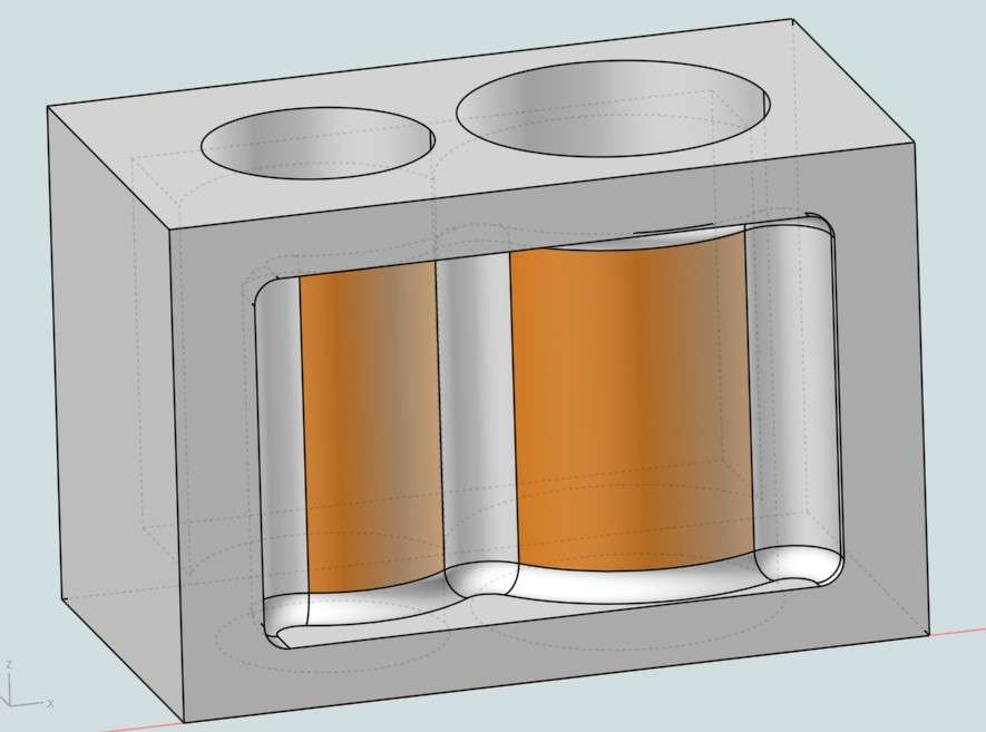

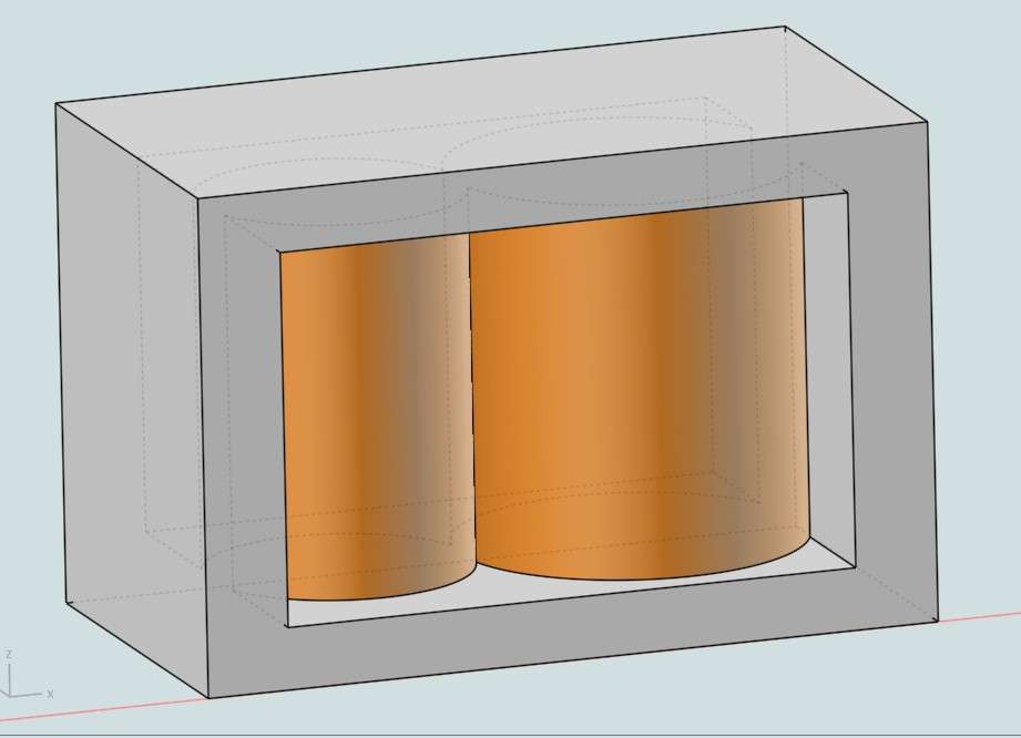

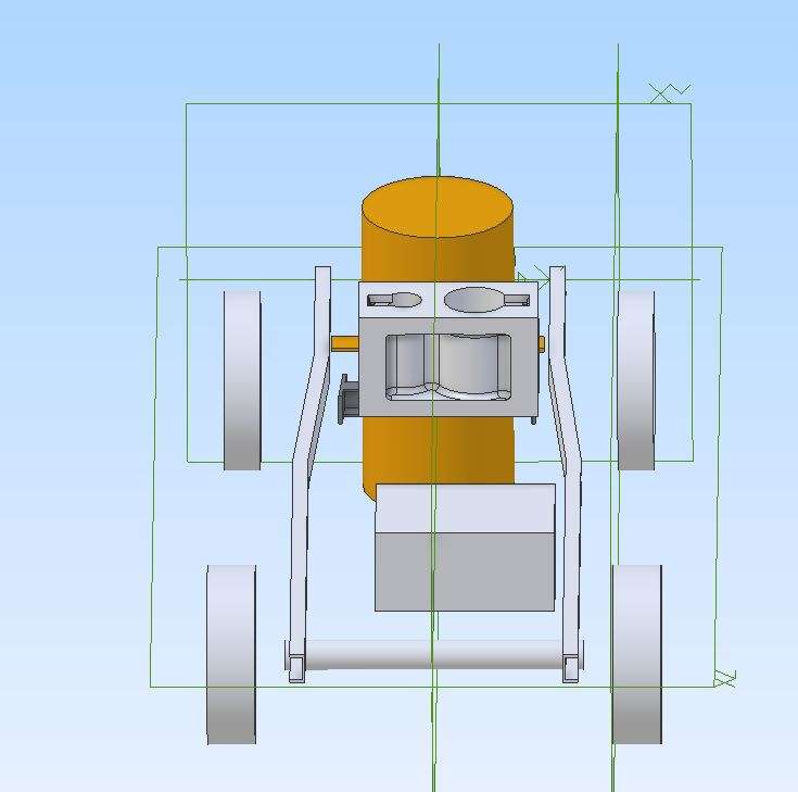

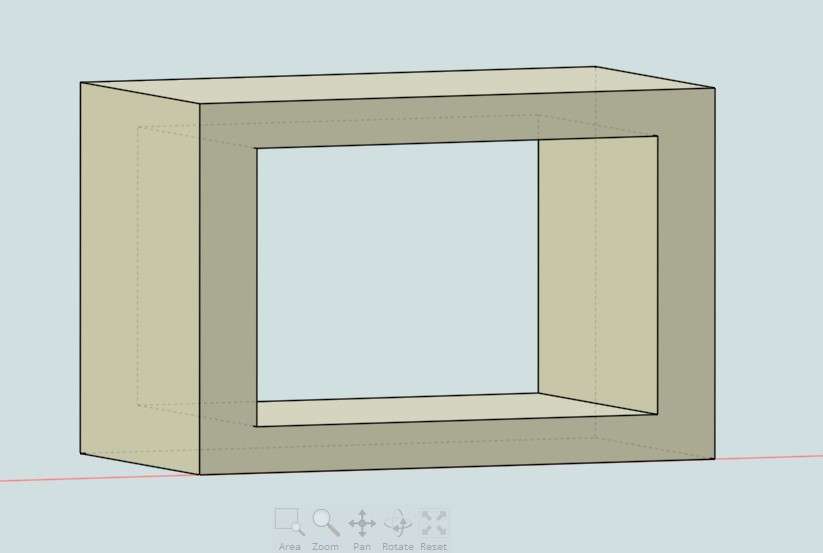

                                              “Quarter of an hour…. ! I doubt I could create that assembly. I could not represent that cylinder block as you did, with a profiled recess as if a casting. (Nor make it that shape from solid, anyway.)”
                                              Maybe it’s how you are approaching its construction.
                                              One way would be to use a box primitive for the cylinder block.
                                              Boolean cut a rectangular hole straight through the side of the block to create the void.
                                              Extrude both cylinders from top to bottom of the block and of the correct external diameter to leave a suitable cylinder wall thickness.
                                              Boolean union the three pieces together.
                                              Boolean cut the cylinder bores.
                                              Fillet edges around cylinder walls.
                                              Martin.
                                              block
                                              block cyl
                                              block fillet

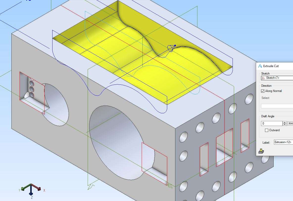

                                                I Have a feeling that Atom does not have Boolean.
                                                When I did the example for Nigel I kept it as simple as possible a mid plane sketch, cut-extrude equally in both directions. Fillet the ends and mirror
                                                cylinder side

                                                    Thankyou for showing me ways to draw the block. The elegant shape might be fairly simple to draw but not to make except as a casting. I can make only simple rectangular recesses but with the DRO as aid might be able to cut steps to approach something like the same weight-reducing.
                                                    No, Alibre Atom doesn’t have a tool called “Boolean Add / Subtract” by name (as TurboCAD does) but I suppose its ‘Extrude Cut’ is simpler version under a different name, combining the shape generation with the subtraction. It might not be able to subtract a fancy shape like that but I can see how you achieved the same by an axial extrusion into a half-section. You can do the same in TC but with an extra move: generate the extruded shape in place then subtract it.
                                                    Nick –
                                                    That is more or less as I am doing. I will be making it from a stock cast-iron block, not a specific casting. Though there’s no reason I could not apart from cost, and having already bought the metal, considering Bridport Foundry is only a short drive from home!

                                                      Have you noticed, Nigel, that this photo on the trucknet page that Jason found, is taken in a very convenient perspective and includes a lot of detail. [a surprising amount, considering the size of the image]
                                                      IMG_0901
                                                      If you want a good image to work from, I don’t think you could ask for much better.
                                                      P.S. __ Trivia Question
                                                      Is that a dead Rat lodged in the middle of axle-beam ?
                                                      Zoom in
