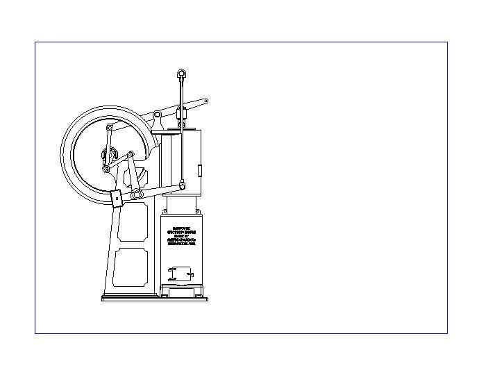

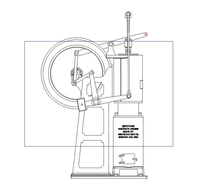

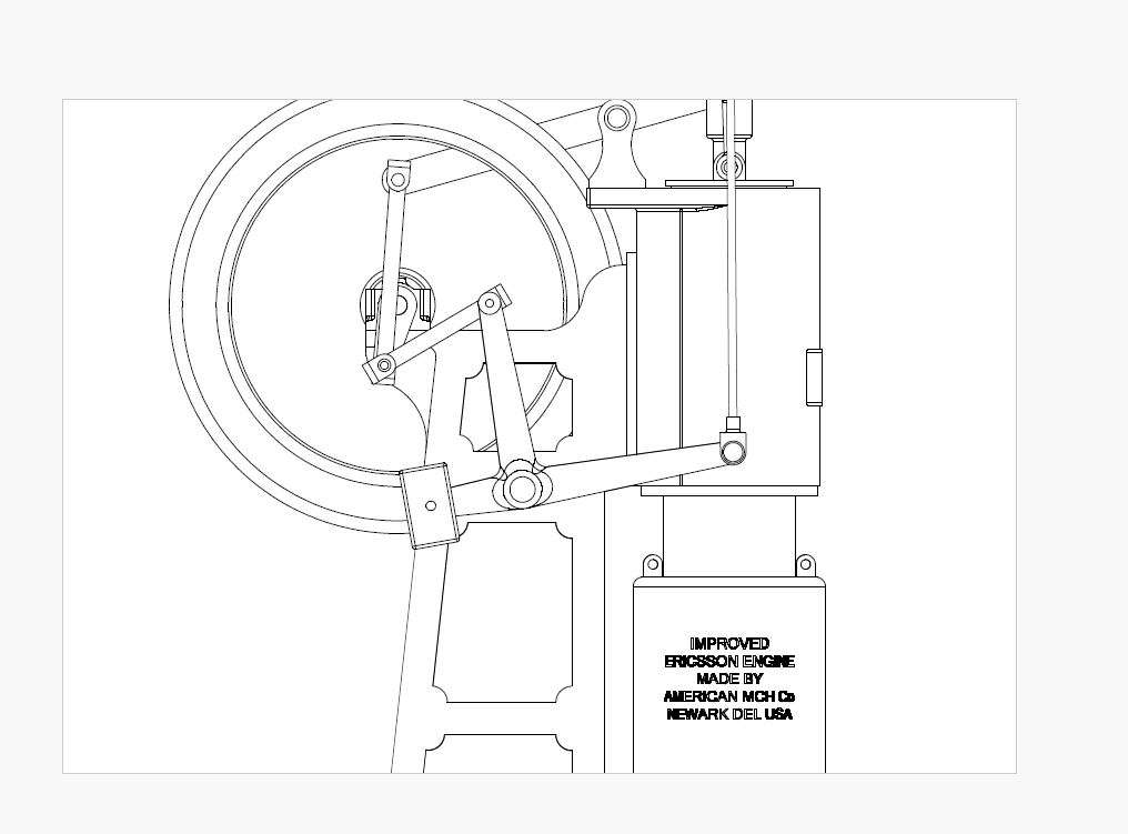

                  On the other hand Alibre will show the size of your piece of paper, the part and if it don’t fit you just get the bit that will fit.
                  Screen Shot showing A4 paper in blue and the model at it’s actual size. I can move the model about on the sheet if for example I want to print out the bottom
                  a4
                  Screen shot in Adobe of what it will print out.
                  a4 adobe
                  Or I can scale the model to fit the page or specify a larger piece of paper as I can print a£ at home. In this case drawing is 1:2
                  1 to 2

                            Anyway I saved the general-arrangement TurboCAD drawing I wanted as a 403kB dwg file, but notice it also created a 1kB .dwl file. ??? (More fun and games because Win-11 has given me a primary directory and folder system far more vague, chaotic and clumsy than any previous system right back to Win-3.)
                            I was able to open it in Alibre, then I made two copies, one side and one rear, elevation.
                            Working only on the copies I could now strip away all the rest of what had admittedly been an incomplete tangle subject to a lot of revision, as it is part of a project that has to be designed as it goes. And stops. And goes….
                            This revealed the drawing was a mass of many Layers and innumerable line fragments, some stacked “below” visible ones. They kept raising a “Change Layer” option – which meant little and did less. Selecting Layers on the tool-bar opened an impressive list of them presumably carried over from TurboCAD and re-named, but Alibre could only act on one. I could select that by dragging a box around the area to be removed, and deleting those highlighted. This left the rest, right down to tiny specks on the screen, removable only by highlighting each one-by-one and deleting them several at a time.
                            Once I’d cleaned the two drawings I tried printing them, despite the printer menu telling me the paper is of “Legal” size whatever that was – and with no choice.
                            I knew a lot of the image would be off the paper; but more importantly the few dimensions left on the drawings were indeed accurate. The 7-inch centre-distance was indeed 7 inches on the print.
                            Phew!
                            In fact I already had established Alibre does print to size on my PC and A4 printer.
                            It doesn’t answer my original question though – why I can’t print a TurboCAD drawing to size. It emerges either reduced or enlarged, randomly, despite every care in setting it up.

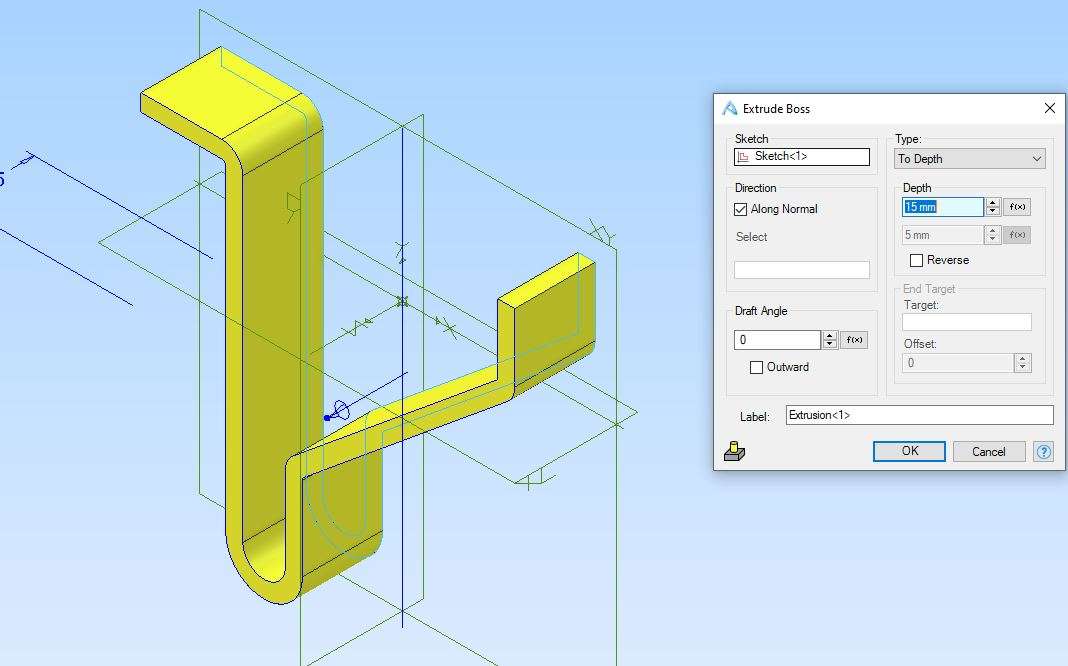

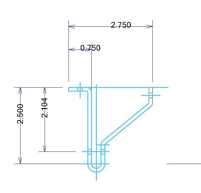

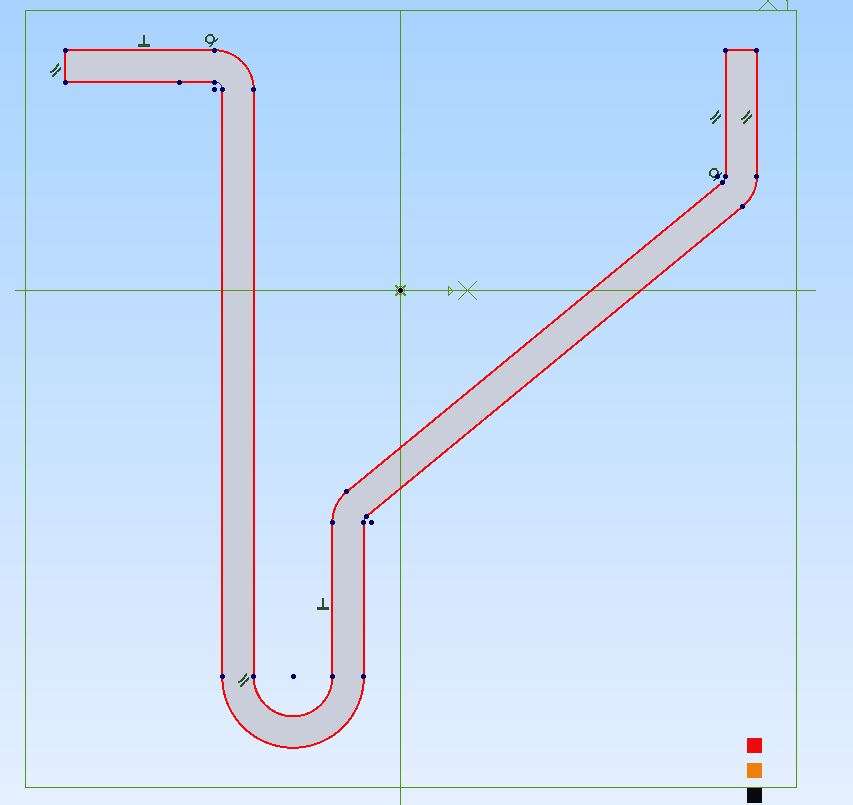

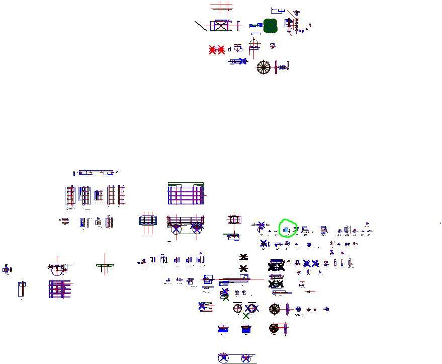

                                            david beat me to it but I’ll post the image sof this example anyway.
                                            This is a DWG that someone sent me of a Fowler waggon, all parts for the waggon on one “sheet” I want to 3D model the part ringed in green.
                                            dwg1
                                            Zoomed in and selected then copied the bit I wanted
                                            dwg2
                                            Pasted into a new 2D sketching screen and tidied up as ctr lines and hidden detail had carried over as solid
                                            dwg3
                                            I can then deactivate the sketch and extrude it to the required width
                                            dwg4
                                            There are some holes that were shown on another elevation, I could do the same process again with those and then Cut-extrude them rather than have to draw them.
                                            It’s a bit complex and you would probably be better off redrawing the old tC parts in Alibre which would be good practice and improve your Alibre skills no end
