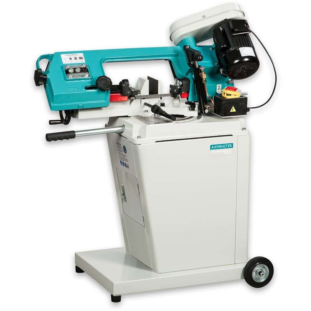

      Hi Guy’s,
      I am looking for guidance / recommendations before spending my hard earned on a saw. I want it for “hobby use” to cut flat/round mild steel/Brass/Aluminium up to say 125mm.
      I have space in the workshop for either a floor standing machine that can be wheeled back under the bench when not in use. Or I can go with something smaller and lighter that can be pulled out and used on a bench top.
      In the woodworking area of my home workshop I have a big RecordPower sabre 350 band saw but I have specifically partitioned off the woodworking and metal working areas to avoid the sawdust/oil cross contamination issues.
      So I am looking for recommendations/advice on portable bandsaw in a stand vs a powered hacksaw vs a cop saw. My initial thoughts are that a chop saw generates too much mess, throwing sparks and hot fittings all over the place. A powered hacksaw is possibly a very slow option compared to modern bandsaws?
      Thanks.
      PS. A search of the forum for “Bandsaw” has page after page of hits but 5 pages in and they are all just passing reference to the word.

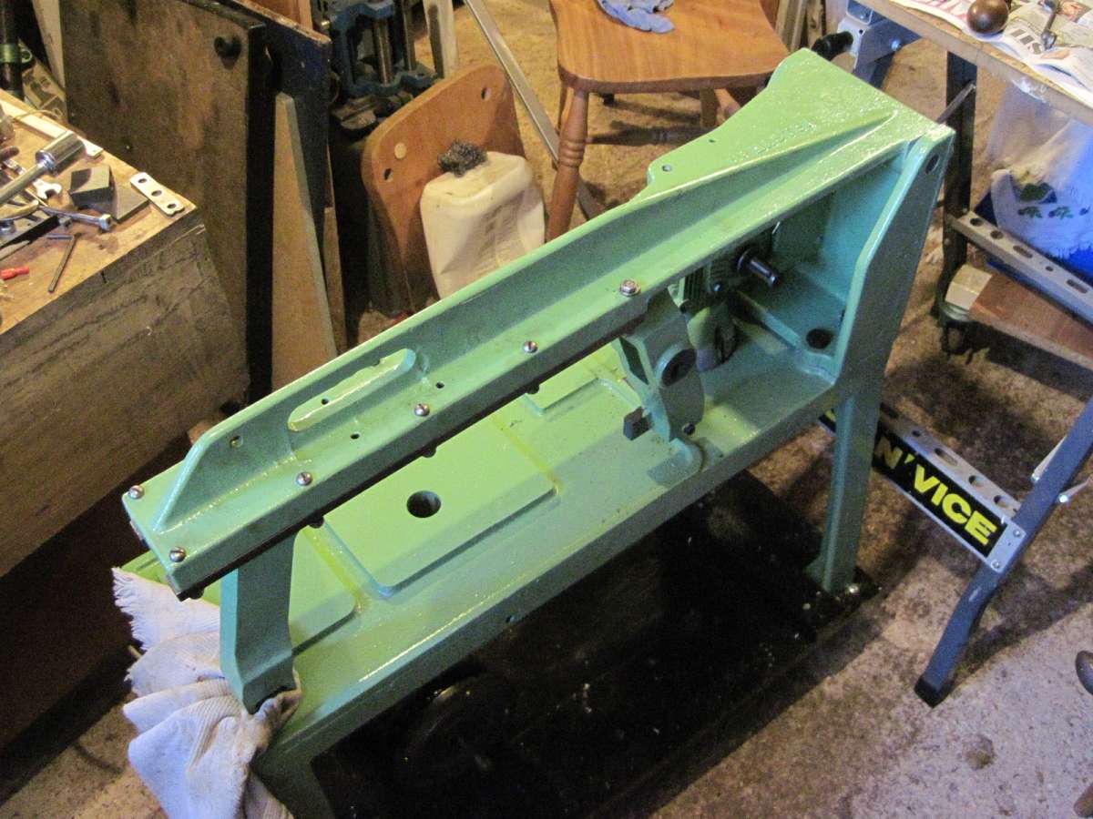

            I have an Aldi “portable” metal bandsaw and an old McMaster hacksaw I rebuilt a few years back. Both have their merits.
            The Aldi is good for cutting smaller work but I think you would be getting near it’s cutting capacity at 125mm and the vice wouldn’t hold it I feel. It’s fairly quick to cut but you have to ‘operate’ it. Replacement blades are not expensive (I recently purchased some new from Tuff Saws that work well). It is also relatively small and easy to move around. You can mount them vertically with a bit of ingenuity. How long it would last if used a lot may be a matter for debate. Like a lot of fairly cheap power tools, if it breaks, it’s probably going to be scrap.
            The old McMaster sits on a low wheeled platform and pushes under the bench. It will cut 125mm easily and has a large, heavy vice. I’m going to chop some 200mm+ (wide) x 50mm (deep) cast iron scrap into usable chunks with it when I get some spare time. I can set it running and let it just plod away – so speed isn’t such an issue. I just give it a squirt of cutting oil every now and then and let it get on with it. I’ve already repaired it and can do so again if need be. It will last a lifetime if looked after.
            (Photo shows it being re-assembled some years ago)
            McMaster - 101014 002
            The McMaster was very cheap at the time and I quite like playing with ‘old metal’ (it just needed some TLC). The Aldi was on offer at a good price two/three years ago and I was tempted. Both saws have their uses.
            However, if I was starting over and could only have one metal cutting machine, then I’d probably get one of the larger Chinese bandsaws now.

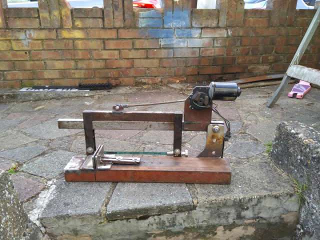

                                    On SillyOldDuffer Said:
                                    Can anyone explain what the particular advantage a power-hacksaw has?   Never used one, and watching one from a distance at a show I was struck by how slow it was.
                                    Is a power-hacksaw for lots of medium cutting, where a handsaw takes too long?   Otherwise, what are they good for?  The appear to have disadvantages compared with a band-saw –  they waste time by not cutting on the backstroke and blade life must be low because relatively few teeth do all the work!
                                    This owes me about £10, spread over the ten years between starting and finishing the build:
                                    Completed
                                    The sliding frame is from an MEW article, and was made from bought tube; everything else, the wiper motor and linkage(from an MGF), bundle of Eclipse blades, base C-channel, etc was scrap. I power it with an old car battery, and use it where you see it. Then it just gets dumped back on the floor inside.
                                    It cuts through 50mm steel straighter and slightly quicker than I can. That time is used for something that isn’t avoidable manual labour.
                                    I wouldn’t buy one because that money would be better spent on a small bandsaw which is, as you say, far more versatile. But I don’t have space for one, and if I did would probably use it for a plasma table.
                                    Angle grinders are horrible things – noisy, dirty, expensive to run, not well suited to cutting thick bars, leave razor sharp burrs on everything – so again, I save them for the jobs they are suited to. I have a nibbler, but  can’t stand the seemingly endless supply of sharp ‘C’s it throws over the entire work area. Instead I cut large sheets with a cheap electric shear that uses carbide inserts.

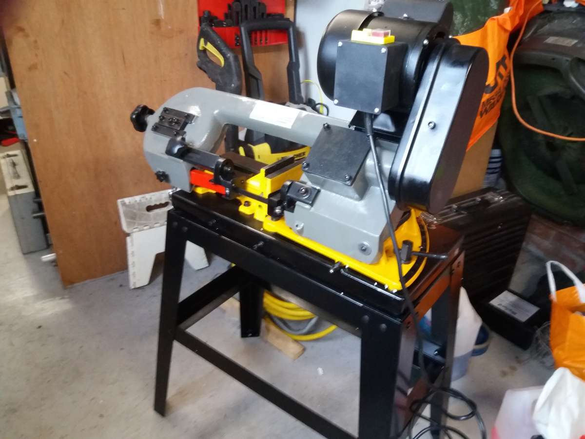

                                            MarkS
                                              @idriver
                                              THANK YOU ALL for the replies.
                                              I have ordered the MCB115SHD from Axminster Tools. It is just their badged version of the generic Chinese horizontal bandsaw available from many different suppliers. I know some will say I could have hot it X ponds cheaper here or there, but Axminster have always given me great customer service and support so I went with who I trust.
                                              Image Copyright : Axminster Tools.
                                              700103_xl

                                                #811223
                                                grubscrew
                                                  @grubscrew
                                                  That’s the exact same model I have Mark. It cuts surprisingly square (maybe I was lucky) and has given me no problems.
