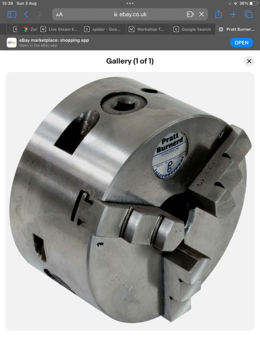

      Hi Folks,
      Its possible I’m going over old ground here but I thought I’d share some experience with an old in need of restoration and set up of a 4” Grip true chuck, In principle the chuck by design can be slipped around on its integral back plate leaving the final coupling and registers fixed as per normal to the spindle nose.
      In my case the chuck is old and a bit of a project to attempt to restore to a usable condition.
      Its 4” 3 jaw 100mm diameter
      IMG_0095
      One thing to note is they are still available and expensive
      In stripping down the chuck cleaning comes first and and few checks made measurements wise, My problems by design start to come into effect from here !
      Most I believe are being used incorrectly to start with by not properly providing access to tighten the rear intermediary bolts once you have adjusted the total runout via the 3 cheese wedge bolts, This leads to the chuck having terrible rigidity and it hard rides on the three pins further creating point loads , In my case it was nesasary to extend the thread on each taper bolt to allow adjustment to re-occur
      Once stripped the body in the y direction was not precise enough so the registers were re established square once more, All good so far so with everything tightened down I took a light cut from the inside of the jaws with little success, I had got rid of the slight bell mouths on the jaws but soon realised the following that you have work around sadly…..
      The 3 wedge bolts have more than enough influence to distort the front face of the chuck body towards the Z
      It will also be able bolted together in an symmetrical and simply Aim the jaws off square again due to distortion, I spent a fair bit of time stoning off these high spots on the two body half’s to get them to take up flat and not rock on 3 points
      In this condition it’s possible to dial in stock at the chuck end but say 8” out with non bell mouthed jaws it’s just a lottery as to how the far end runs, Typically 0.125-0.2mm or worse, I spend more time thinking looking and resolving the problems
      Main problem solved was to stone off the back of the chuck until the bolts when tensioned gave an even force to the point that the stock in the chuck didn’t deflect from axial alignment…..Very time consuming…… last it would be nice use a too post grinder to finish but I had good carbide so used that to take a very light skim, Finally to get close to perfect co-axial alignment I removed the jaws and honed them until the work mounted first time with 20 microns or so at a good amount of stick out!
      Up shot is I had a spongy in accurate un adjustable chuck but knowing where the downsides are hopefully this can help other folk struggling with longer stock in these chucks

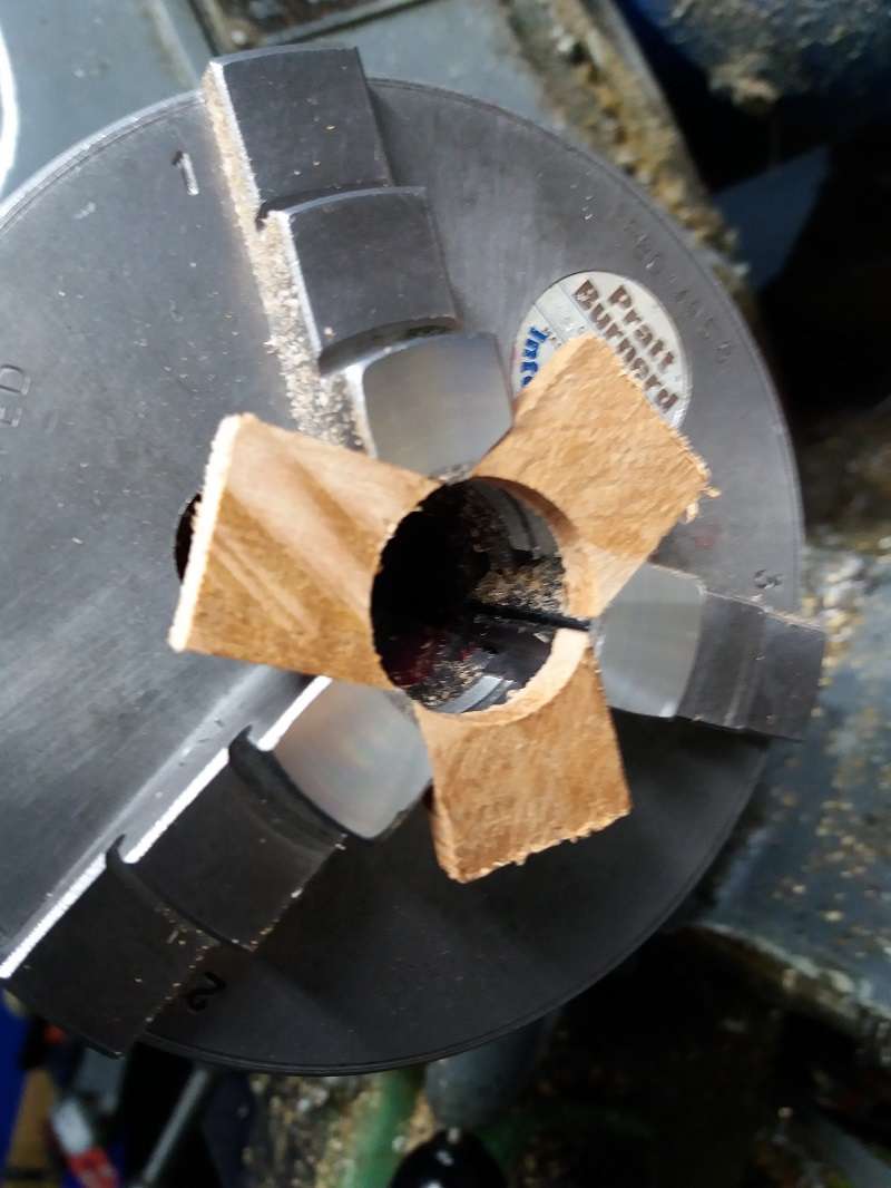

            My two came with bellvile type spring washers under the capscrews. One came with the lathe when I bought it used in 1987, and the other chuck New from the importers closing down in 1997.
            On my old chuck, I closed the edges of the jaws onto a pieces of material the same size. Then carefully took a skim cut until a minimum clean up. the bore was about 25mm or so.
            A petal plate is effectively what i used to hold the jaws.
            Found the picture taken at the time.
            rebore-Jaws

                    When truing the Jaws, I first set the outer body of the chuck , running true to the backplate.
                    The over all outcome, any size on the chuck now is quite close, and is closer than the standard 3jaw chuck that came with the lathe. The runout with my rebored GripTrue is about 0.06 tir on various sizes. In my case 25mm is the zero diameter and every 1/4 inch diameter smaller from there is very close to Zero, and every 1/8 inch is off by upto 0.06mm.
                    This suggests to me, that if I rebore it again, and correct the body by 0.03, still won’t be any better, as that is the wear or the mechanical limit to this particular chuck.
