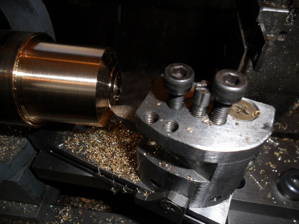

        Personally I just plunge in with the parting tool and keep going, rather than try and widen the groove. Seems to work fine for me, like this:
        Parting Front Wheel Hub
        I also part off under power feed, although that is more controversial. surprise

          Ooooh that looks scary and the work piece looks microns away from the tool post!
          I haven't parted off yet but I'm going to have to give it a go… fingers crossed

            It's not quite as scary as it looks. The toolpost is a fair distance from the work, it's an optical illusion of the picture. I wasn't completely parting off either. It may not be clear from the picture, but the wheel hub has already been drilled and bored, and is mounted on a home made split mandrel. Since I didn't want to damage the mandrel I left a wall thickness of about a 1/16". The hub is 3-1/2" in diameter, and the mandrel is 1-1/8", so the depth of the slot is about 1-1/8".

              Andrew, there are some beautiful radiused corners there. I take it that the work on both sides of the parting tool is for use?
              How did you achieve those really nice corners?
              Paul.

                  Paul: The internal radii were formed with a 5mm diameter carbide button insert. The external radii were 'chamfered' by eye with the same tool and then finally shaped using files.
                  The work to the right of the parting tool is the front wheel hub outer cover. Once removed the end of the work to the left is cleaned up and the inner cover is machined and then also parted off, leaving the hub to be cleaned up to length.

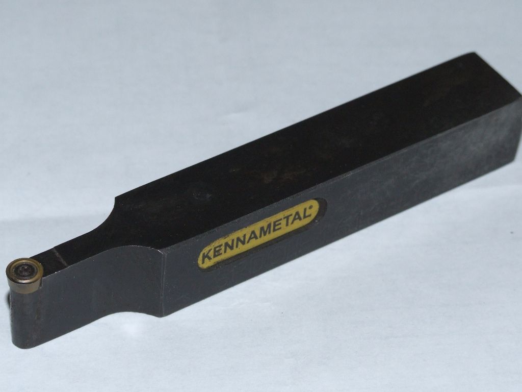

                        Andrew, 2 questions. First. what exactly is a button insert; I'm presuming it's a rounded equivalent to the triangular ones I have? Secondly, in your 'avatar' what are you sitting in?

                          Paul: First, here's a picture of my button insert tool:

                            Tht's a great tool, Andrew. I take it you choose the radius you want and then just let it cut?

                              Paul: I'm not sure I quite understand your comment on choosing the radius? Using the tool directly you get the radius set by the insert, 3mm. I was wrong in an earlier post, the button insert is 6mm diameter. However, the tool is very useful for generating curves of larger radius, if it can be guided by other means. I have a hydraulic copy unit on my lathe, so the tool can be used to generate tapers and curves from a simple flat pattern, like these connecting rods:

                                What I meant, Andrew was that you would choose a tool with a different size 'button' to suit the desired radius. Once set up you would then presumably use either the cross slide or top slide in a straight cutting motion to produce the corresponding curve?

                                  Paul: Thanks for the clarification. The round inserts do come in several sizes, but sadly each one requires it's own tool holder. They're not intended to be interchangeable on the same holder. The 6mm insert is the smallest; for larger inserts you need a fairly rigid machine to avoid chatter as the length of cut can be large. For most of my work on the traction engines the radii are not critical, so I just use the 6mm insert. If I need a definite radius then I'll grind up a HSS special or make one from gauge plate. You are correct that a straight cutting motion is used to generate the radius appropriate to the insert.
