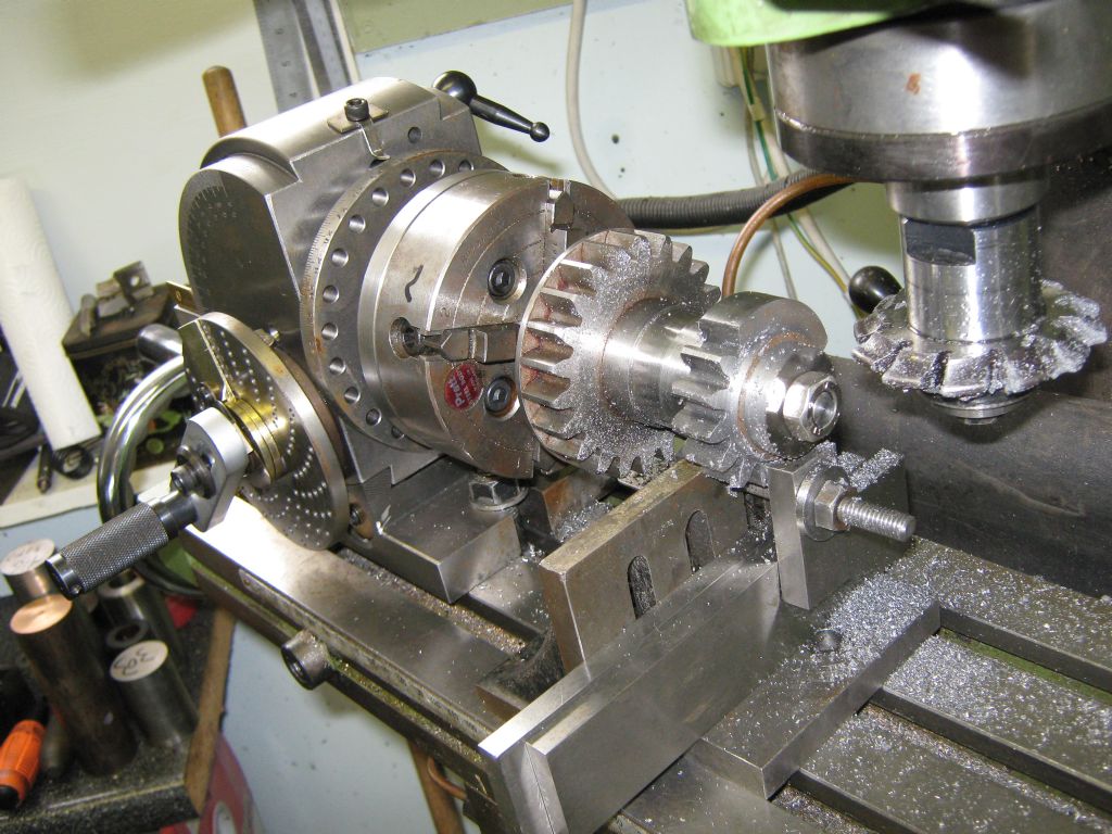

                    I think the Warco VMC is worth a look as it's very versatile and has good capacity at a fairly low price.
                    I have been using this to build my 3" scale TE for which it has surplus capacity. I have not had any problem with my VMC, speed change is however, by changing the drive belts. I assume the major and GH machines you mention have variable speed which is an advantage.
                    These gears cut in one pass, 7.2mm depth, with no problem.
                    gear cutting

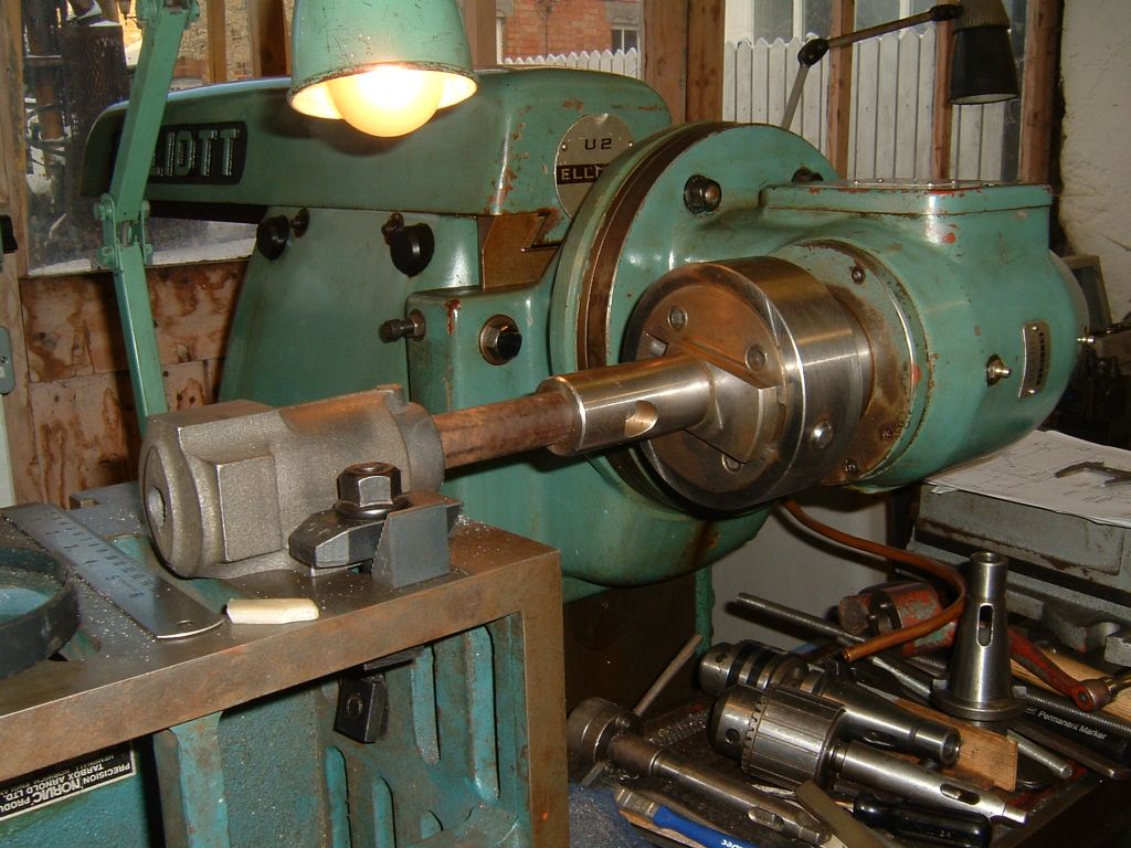

                          The method Nigel shows for gear cutting is perfectly OK, until you get to the large final drive gear which in my opinion can only be done horizontally,on a rotary table, using a horizontal mill, due to the machine capacity required, The money you save by cutting your own gears will more than pay for a decent H/V rotary table with division plates,
                          Also a mill with swivelling head is useful with the head in the horizontal direction, used as a horizontal borer, for boring cylinders etc, you will find that set up very useful, I know I did.
                          Don't restrict yourself to modern imported machines either, there are plenty of very good S/H english machines still out there , probably better suited to your needs.
