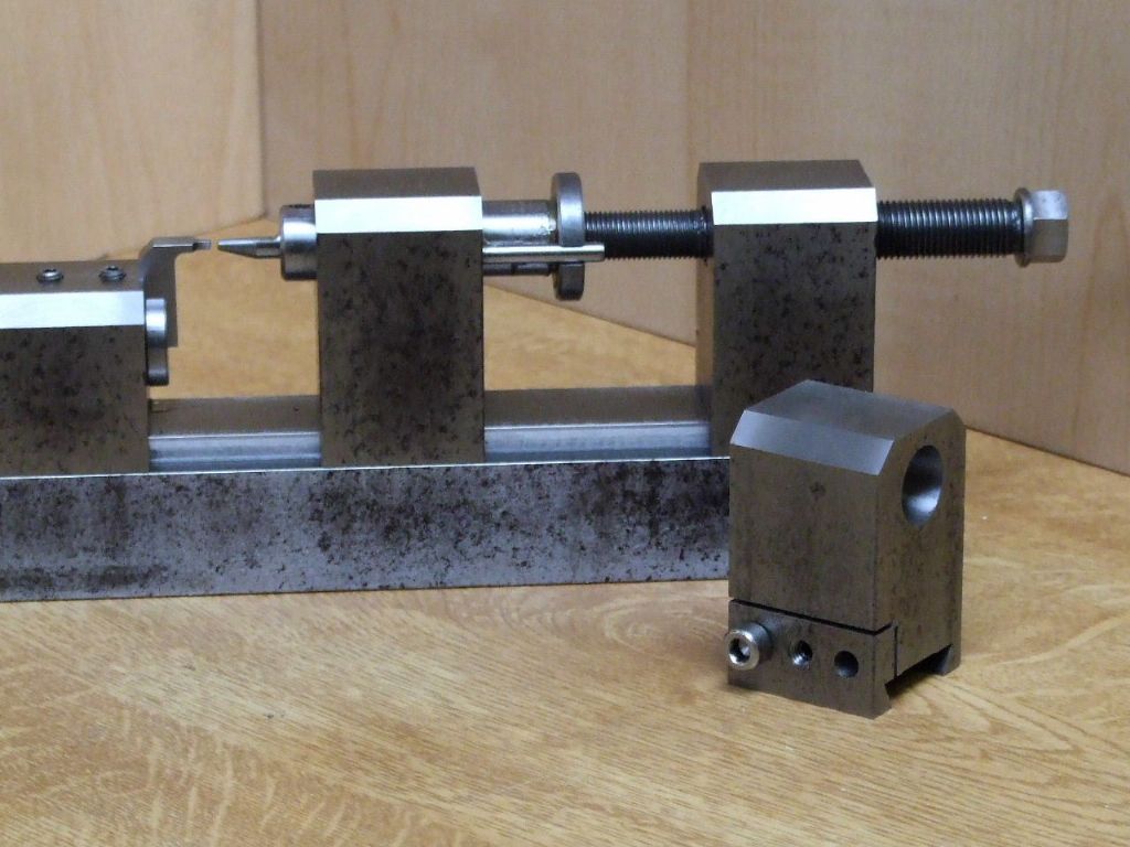

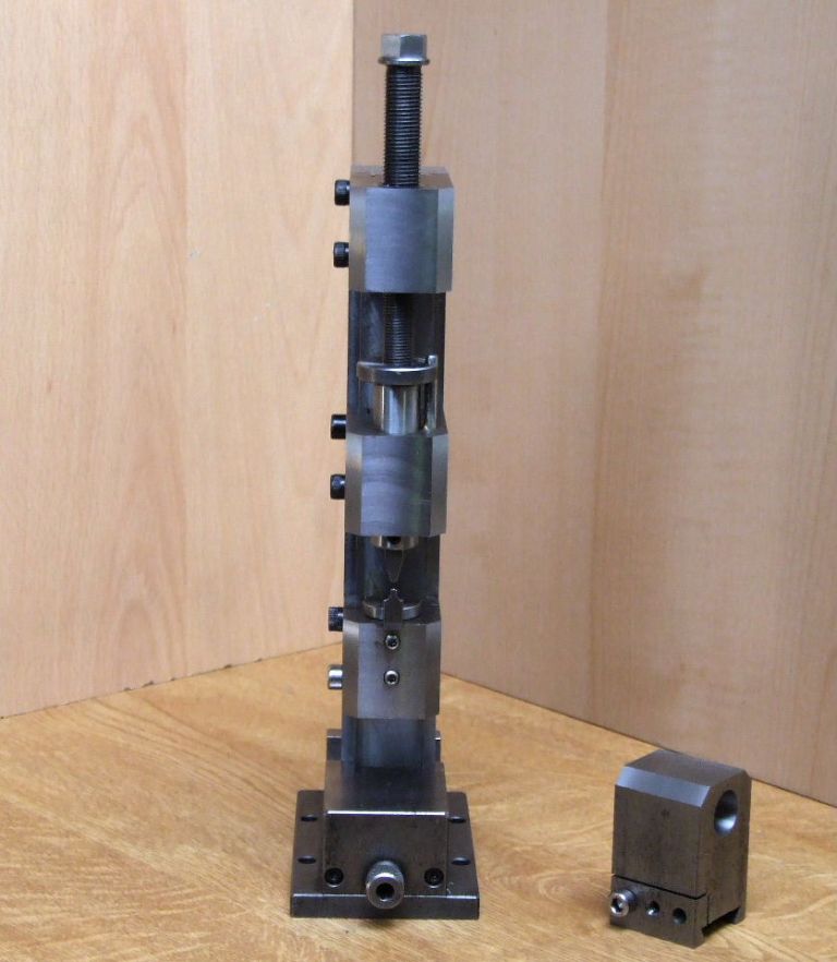

                                        Now that the post seems to be concluded I thought I would add another use of the differential thread principle that I used on my Squeeze riveter.
                                        I wont bore you with why I chose the screw thread over the more conventional lever, but below is a close up of the working part.
                                        The reader will clearly see the two different sizes of screw thread used. Below is the results on my Clayton Timber Wagon chassis.
                                        If a torque wrench is used the tool gives extremely good and consistent results. There are a couple of more photographs in "My Album".
