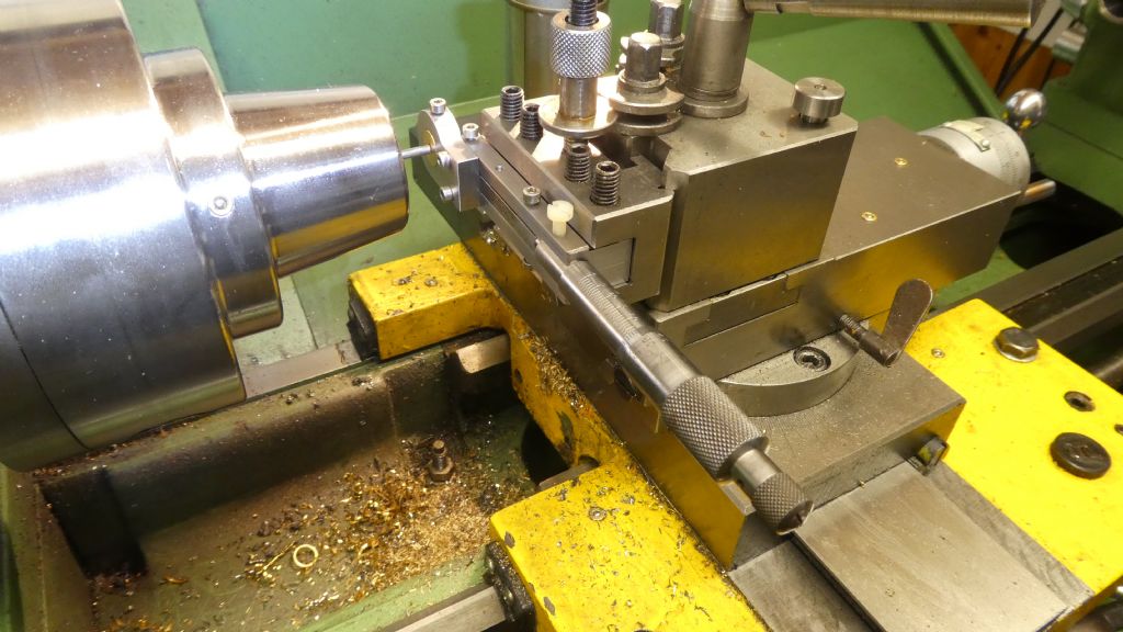

      A tool worth making I thought. So I did !
      ………….and it works here!
      **LINK**

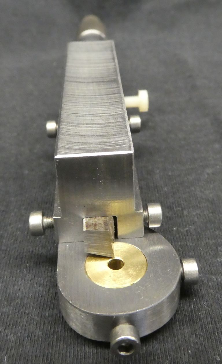

        old mart
          @oldmart
          A clever design, could have trouble as HSS requires sharpening, perhaps a DCGT 07 for aluminium could be incorporated into the toolholder. Then tool height would not be a factor.

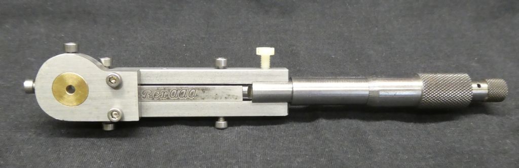

                #478859
                Rik Shaw
                  @rikshaw
                  Thanks Hopper but not my design by any means just my take on it. A version by Stew of Potty Engineering gave me the idea. Someone else had incorporated a mic head into their version and as I had one laying around I did the same.
                  Rik
                  #478870
                  Hopper
                    @hopper
                    I like the mike head development. Seen them for sale cheap online and been trying to think of a use for one. It would make a great MEW project write up if you were so inclined.
                    #478950
                    Howard Lewis
                      @howardlewis46836
                      When I made my reversible roller box, the intent was to use a ME 40 thread for adjustment. But I was given a mechanical digital micrometer head, so used that, instead, despite the increase in size. Had to be more accurate than anything I could make!
