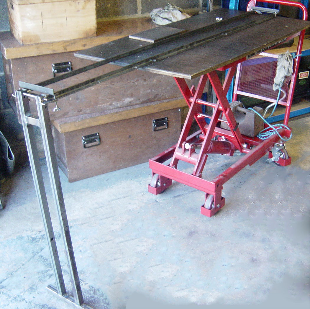

            #58495
            Niloch
              @niloch
              Ian,
              I suspect Trev means something like this
              #58498
              TrevorK
                @trevork
                Hi
                I looked at the motorcycle type lifts, you can find similar ones on ebay.  In the end I decided on the Joe Holdsworth lift kit which has all the features I wanted.  You can see it  at http://www.jblifttablekits.co.uk/products%20lift.htm

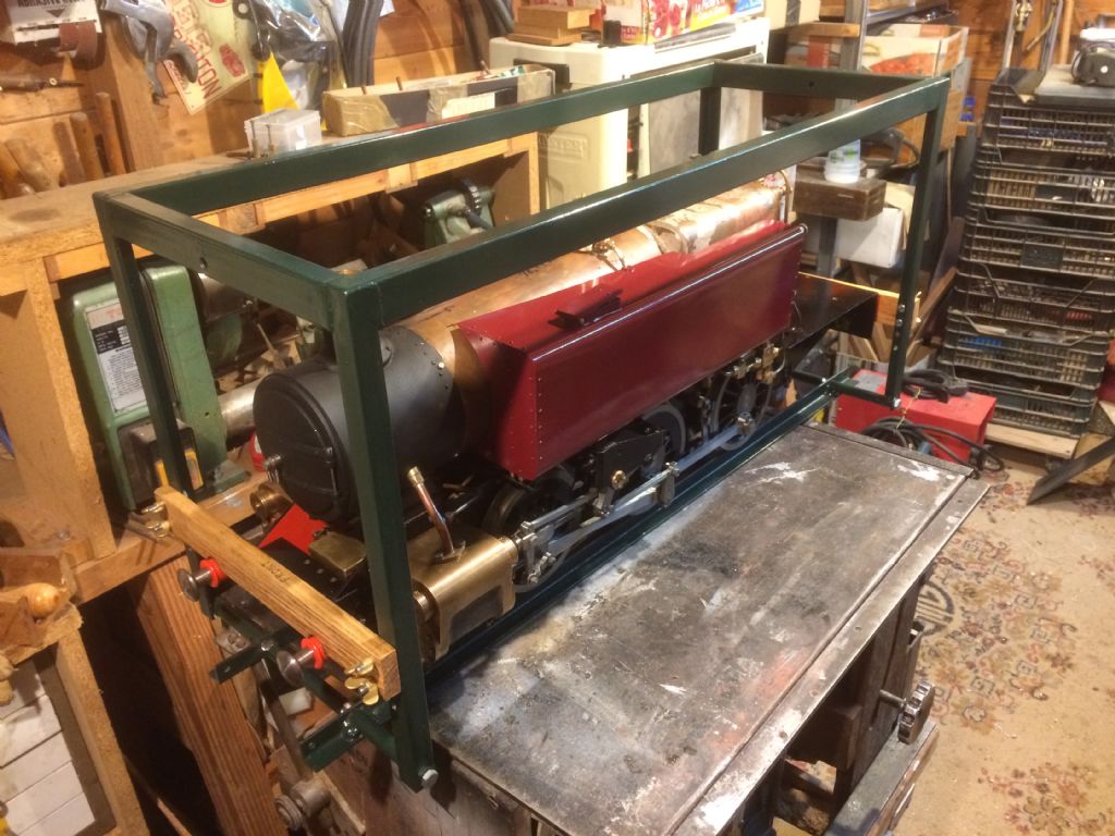

                      #58839
                      DMB
                        @dmb
                        Hullo all,
                         Ref Niloch, 9/11, the main picture on Machine Mart`s site, of their trolley. This is as used satisfactorily for sometime now by Worthing Model Engineers, who have actually modified it with an extension to the table and fitted rails to the table.
                        John.

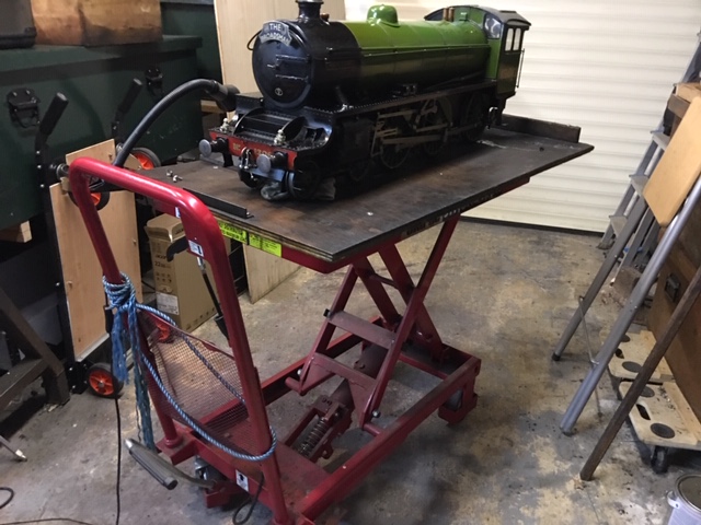

                        #566454
                        John Farmer 5
                          @johnfarmer5
                          I have a 150kg lifting table bought new on Ebay about 5 years ago quite a bit cheaper than M/c Mart but still good quality. Ideal for moving w/shop machinery too.

                              #566474
                              Dave Smith 14
                                @davesmith14
                                This is what I use. It is simple scissor frame pivoted onto the lower frame and upper frame at one one. The other ends have sealed bearings run along the upper and lower frames. A car scissor jack provides the movement to raise and lower the upper frame and is arrange to give around a 2:1 motion ratio. No fancy machining needed, cheap to build, does not take up a huge amount of room and the loco can live on it in the workshop or garage which at present my Super Simplex does. If you want some more detailed photos let me know.

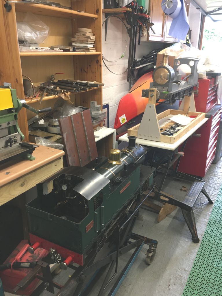

                                #566480
                                Peter Seymour-Howell
                                  @peterseymour-howell39349
                                  Can't help re carrying in the car, I still need to buy a suitable car to move my 5" loco when it's finished. For lifting in the workshop I built myself a lifting hoist with a swinging jib to swing the model out and lower to the trolley. This setup didn't cost me much, the scaff fittings and tube were picked up off ebay for very little money, the swinging arm IIRC was about £50, and the hoist approx £40. Perhaps another £30 for chain and D shackles. The loco when finished will be approx 280lb, the hoist can lift twice that, the chain/shackles about 10 times that, and the jib about 400lbs at full stretch, more if at the halfway mark. I can swing the model around 180 too when needing to work on the other side. I also have a long mobil trolley for sitting the model on and moving around the workshop..
                                  As you can see the loco is lifted by a sturdy steel beam and held from the same lifting points as per full size, D shackles on the front and large hooks grabbing the drag-box for the rear..
                                  Pete

                                    #566491
                                    Jon Lawes
                                      @jonlawes51698
                                      I use a motorcycle lift, the type advertised as Motorcycle Hydraulic Scissor lift. It cost me about £110, (pre-brexit, things may have changed). I pump it up to the height of the workbench (which is effectively full extension), slide the transport box onto it, wheel the whole assembly out to the car, then lower it to my boot. I can then just lift it one side at a time into the boot. I chose a car with no lip on the boot for this reason, an XC40. At no point do I have to do any heavy lifting; I'm an amputee and carrying things can be quite difficult.
                                      My transport case is marine ply with two lengths of railway track on it, when you lower the box over the top and clip it on, the buffers prevent it rolling back and forth. The main advantage of the transport case for me is not worrying if anything else in the boot is peeling off handrails and such.

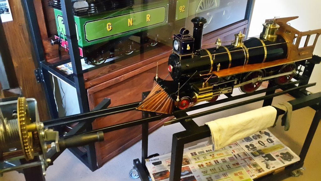

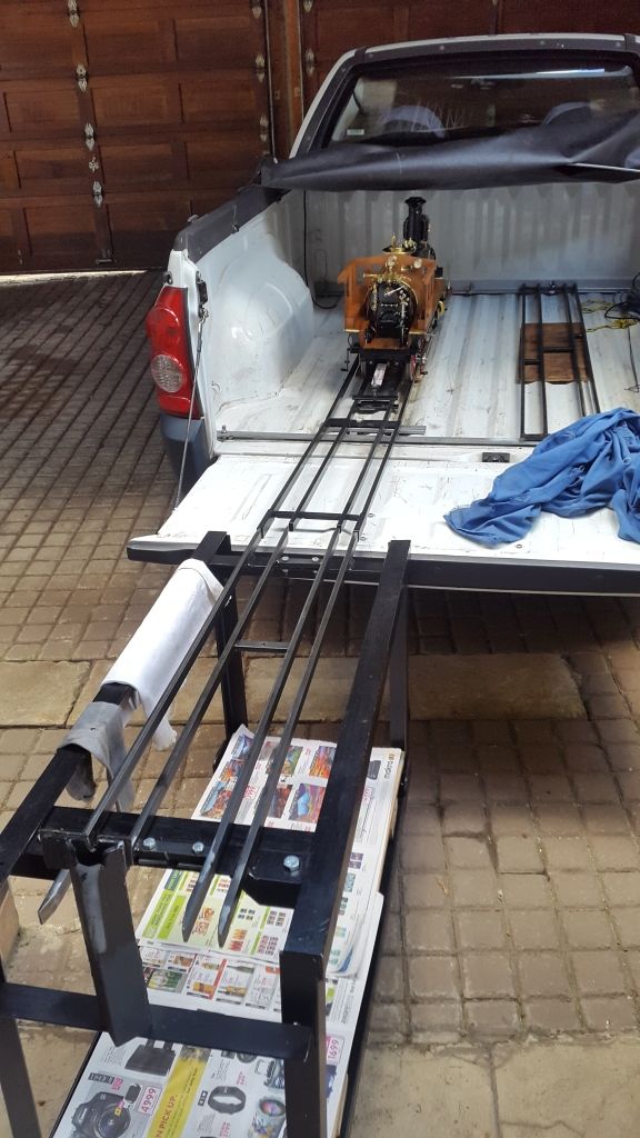

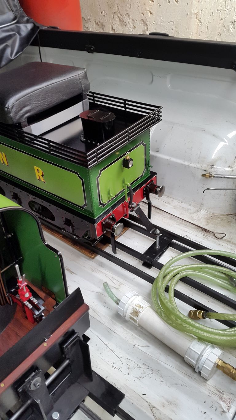

                                      Simon Collier
                                        @simoncollier74340
                                        I have never owned sedan cars, only station wagons. I see no disadvantage. When my old Camrey 1993 got rusty, I bought my brother’s Subaru Liberty wagon. However I discovered to my absolute horror that the rear seats don’t fold flat, as they always have done on wagons. Traditional wagons like Holdens and Falcons had longer chassis than the sedan equivalent and could fit heaps of stuff on a flat deck. None are made anymore, giving way to these so called SUVs which are no substitute at all.
                                        I can get my Simplex in the Subaru alright, but not my Sprinkbok. I built a raised plywood deck for it but it is a poor solution. Club members have wagons, trailers, hatch backs, vans and SUVs. Not one lifts a loco out of a car boot.
                                        #566513
                                        Speedy Builder5
                                          @speedybuilder5
                                          Following others, I have built a detachable frame which 1) allows the loco to be securely fixed to it and 2) also allows it to be suspended for running on air etc.
                                          And bought one (but its in the post at the moment ! ) of these trolleys for transport, shed to car / garden etc.
                                          Thinking about a rail clamped to roof rack overhanging the back of the car so I could hoist loco and frame into the car ??

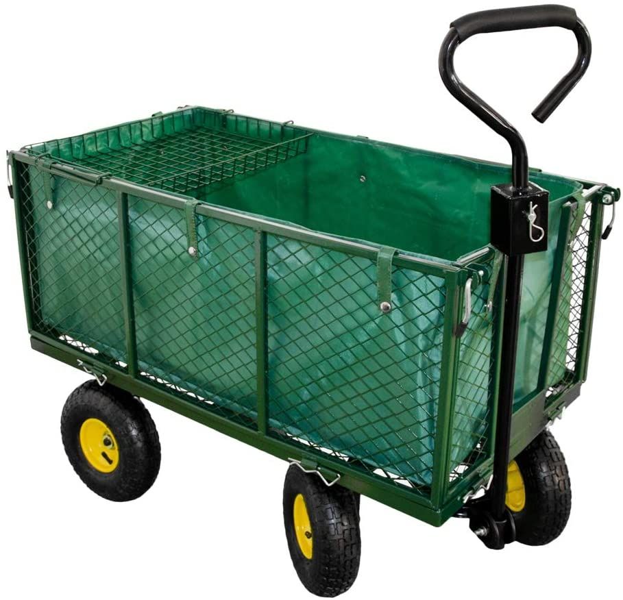

                                          #566538
                                          Anthony Kendall
                                            @anthonykendall53479
                                            The way I do it – it works for me.
                                            Machine Mart, extended with plywood gives more area for working and easier access to car. Removable end-stop to prevent rolling off.
                                            Use over-run rails to get up and under for quick jobs.
                                            What would I do differently – buy a truck which went lower – going low is at least as important as going high!
                                            Get on better without rails – easier to move loco around on the top.
                                            Like I say, how I do it – not saying anyone else should – you get the drift. Pictures may work – if not, you'll have to imagine it!
                                            No good!
