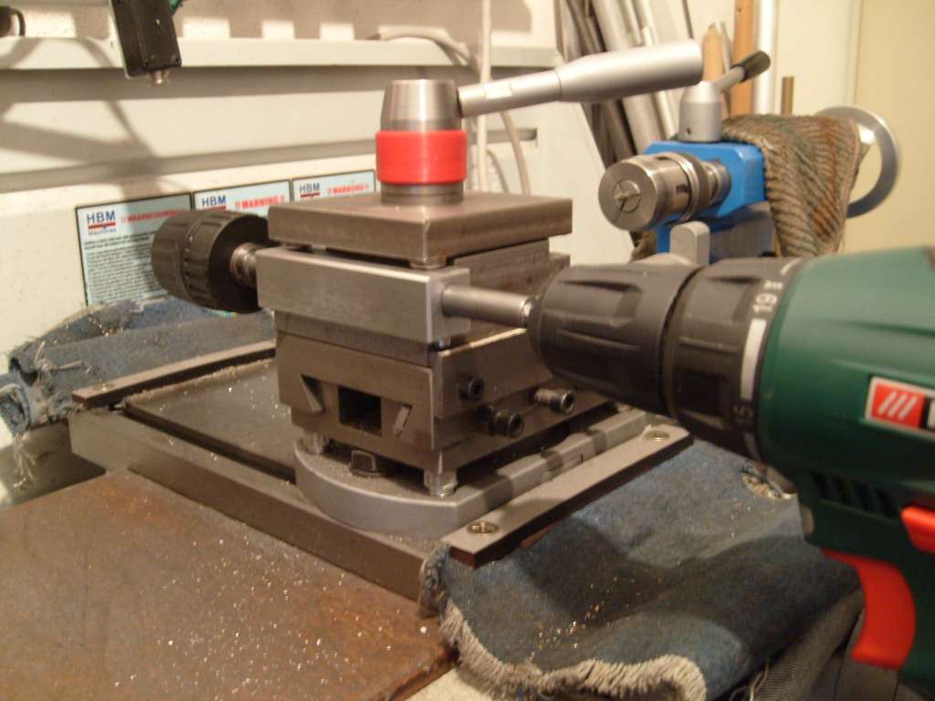

                    I have made a BLDC tool post dril for radial and axial drilling, milling and gear cutting. For tapping I made a holder for a cord less drill that can also be used for drilling. Both are used on a regular base.
                    BLDC tool post drill FreeCAD design.
                    S7300745
                    Tapping holder:
                    ToolPostTappingHolder

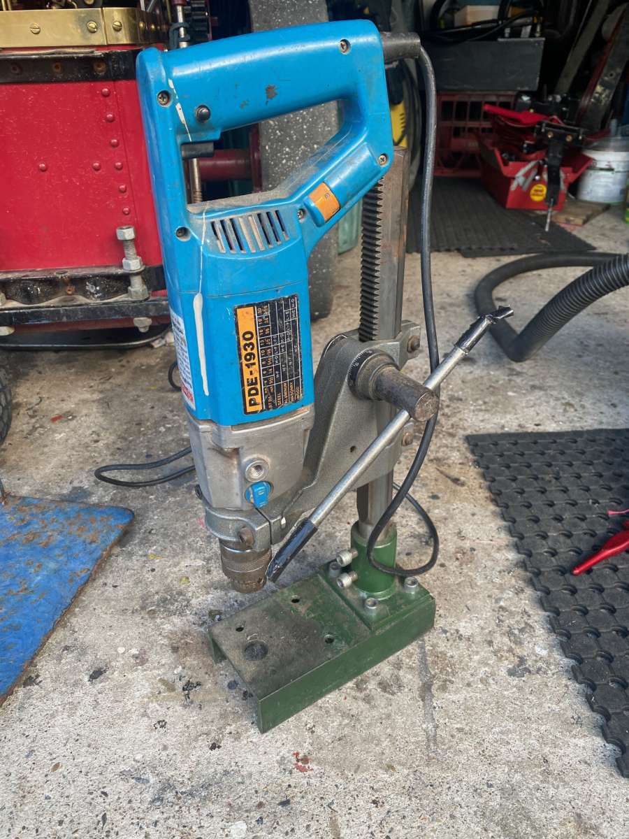

                        If you only need a simple drill press and already have a drill, either mains powered or battery, get one of these. Much easier than trying to make your own. Available from ebay and hardware stores.
                        drill stand

                          ..but even in that (advertising?) picture they couldn’t get it to hold the drill perpendicular to the table.. ..😢..

                            The photo is only intended to show a typical attachment for a hand drill which I found after a 2 minute search. There are lots of others of different styles and quality.
                            This is my first drill press which I bought 40+ years ago and is still used. Not as good as my mill/drill but capable of drilling accurate 1″ dia holes thru steel plate. It originally had a cast alluminium base which was replaced with the one shown.
                            Drill

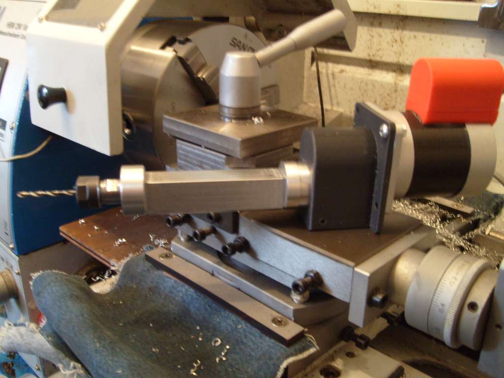

                              This is my effort for a tool post drilling attachment I made a while ago. It has a variable speed motor and driving a pair of toothed pullies and toothed belt to prevent slippage.
                              David
                                S7300745
                                Drilling and Tapping holder:
                                Added the pictures, don’t know why they did not show up on my phone!

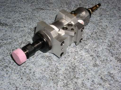

                                      As noted above, a die grinder is not suitable for drilling, but it can be useful. Needing to re-grind bell-mouthed chuck jaws, I made up a toolholder for one. Aluminium was to hand, easy to machine, and perfectly adequate for occasional use.
                                      iqc_grinder_holder_med

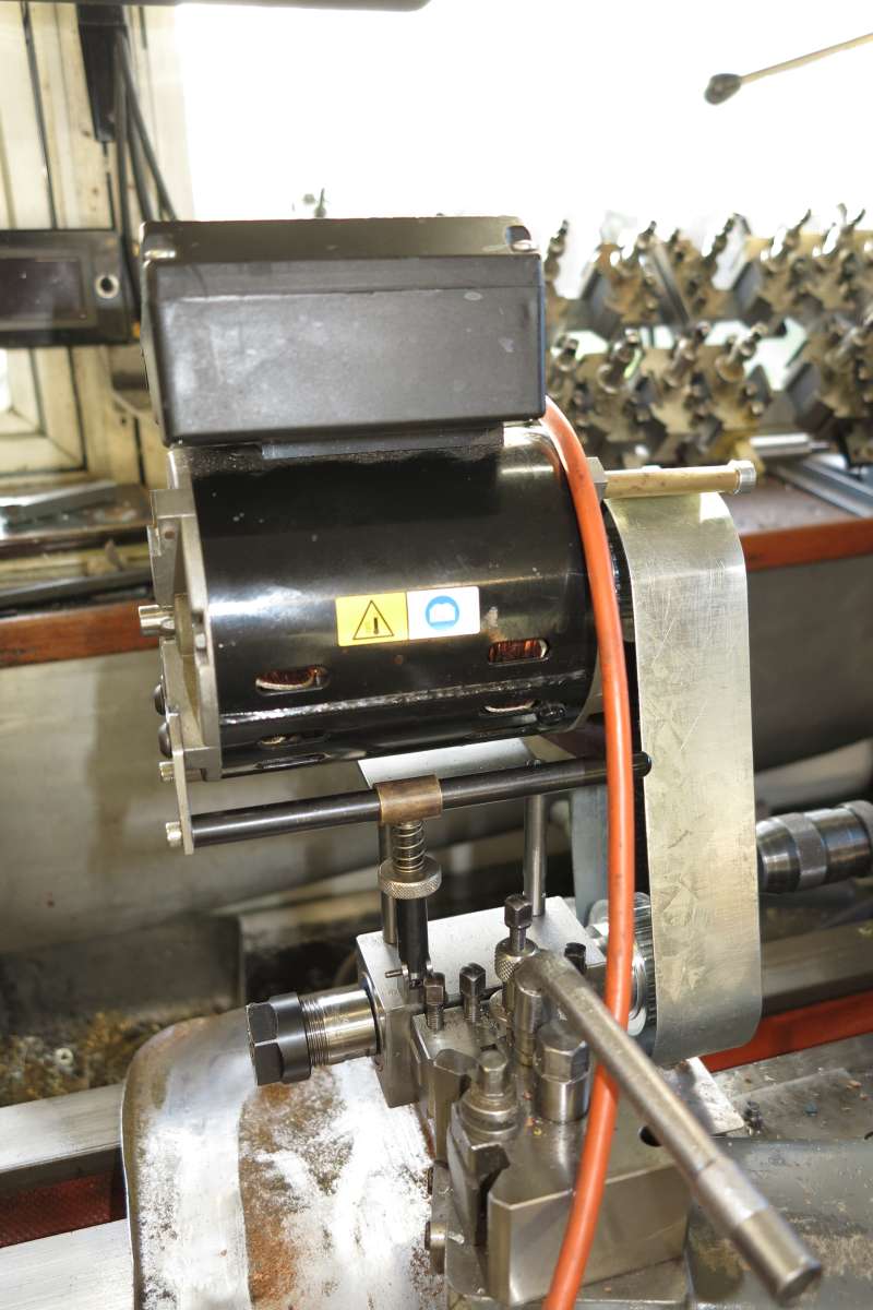

                                        I have a complete unit like Robert, with an axial possibly epicyclic gear box, it was given to me and is undoubtedly of the cheaper type, a simple mounting of the sort I mentioned would work – just need a power supply and the trigger for variable speed, though this could be replaced by a pot ? Noel.
