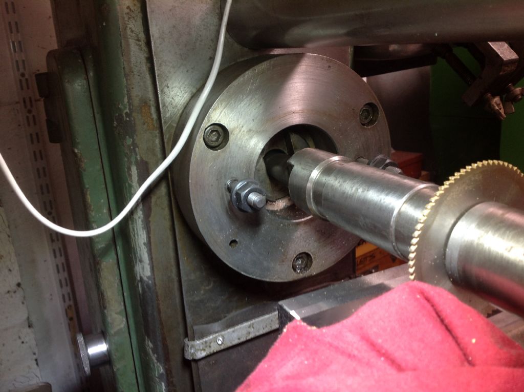

                                  My Senior.
                                  Tom Senior M1 Milling Machine

                                    Thanks Geoff thats a great help, it's all becoming a bit clearer now.
