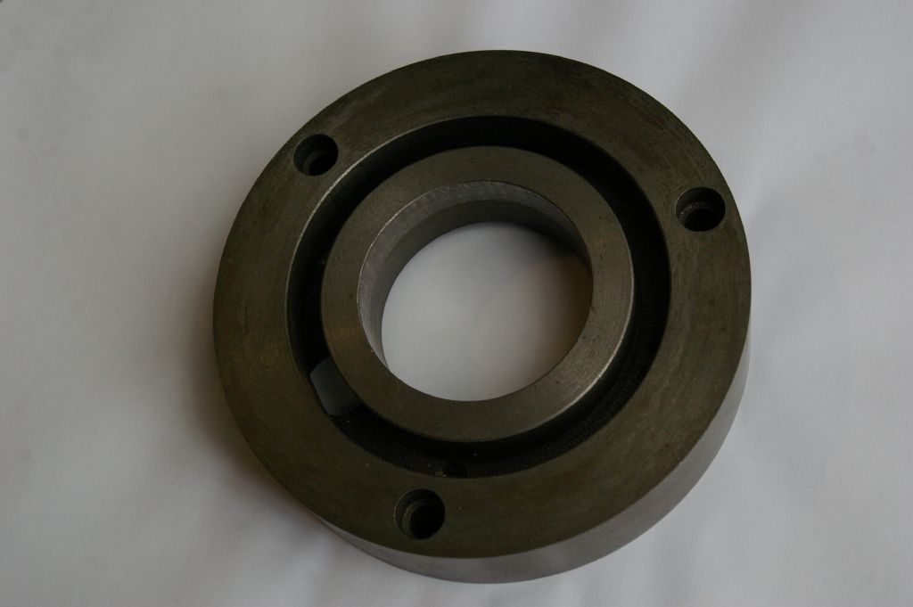

      Can anyone with a Senior M1 point me in the right direction for a suitable type of chuck and collets for a spindle driven vertical attach.
       I’m also chasing a division ring for  the vert. attach.and a ball handle for the
      same     I  would be most grateful for any help .

          Well if you are talking about what’s known as the ‘knuckle’ head, then most (all?) of them have an MT2 taper. Originally they were fitted with a Clarkson collet system, but it’s quite possible (and rather more flexible) to fit an ER32 collet chuck – you’ll just have to make yourself a suitable length drawbar to hold it in place.
          As for ball handles for the division ring – I’ve never seen them fitted. The ring is attached to the body of the mill with three hex-socket bolts, and the division ring is held in place with two nuts and bolts. There isn’t room to swing ball-handled nuts around unless you used the ‘releasable’ ones, and I’m not at all convinced that you could clamp them with what I would regard as sufficient force to hold the head adequately anyway. Mine is currently in bits awaiting a fix, which hopefully I’ll be able to make a start on in a couple of weeks. This is what the driven shaft looks like inside:

                Thanks again Steve ,I’ll try Home/w/shop , I think the division ring is going to be the difficult one , if all else fails I will have to impose on the members good nature to supply the dimensions and maybe a couple of pics. so that my mentor can machine one , relax Charles it’s not you.

                  Chances of finding the division ring without the rest of the knuckle head? Closely approaching zero, and probably from the minus side!
                  Pix and dimensions will be relatively easy though – since mine is currently in bits, the division ring is sitting there in all its glory in an easy measuring state – I’ll see what I can do, but you may have to wait a few days. And that’s a fair old chunk of metal there; it has to be, otherwise you lose some Y extension when you crank the table in and out. It’s nearly 6 1/2″ diameter, and 1 1/2″ thick, with an interesting exercise in rotary T slot cutting thrown in. Yes, you are going to need a T slot cutter, and a rotary table. Due to the physical integrity of the original design, you couldn’t easily make this up in layers, either.
                  I would have thought that a cast iron blank, suitably oversized, would be the thing to go for.

                    Thanks once again Steve , I have spoken to the resident smarty who has a light industrial
                              workshop and he doesn’t see a problem making a division ring.
                              I have shown him the rather poor images I have of one mounted so when you find                   time to forward some dimensions I will pass them on and with a bit of luck
                                    a suitable part can be made.

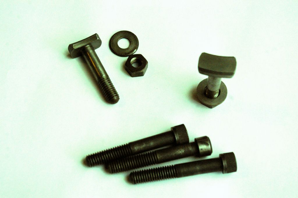

                        The other thing I forgot to mention earlier is that of course, the tee nuts are curved…

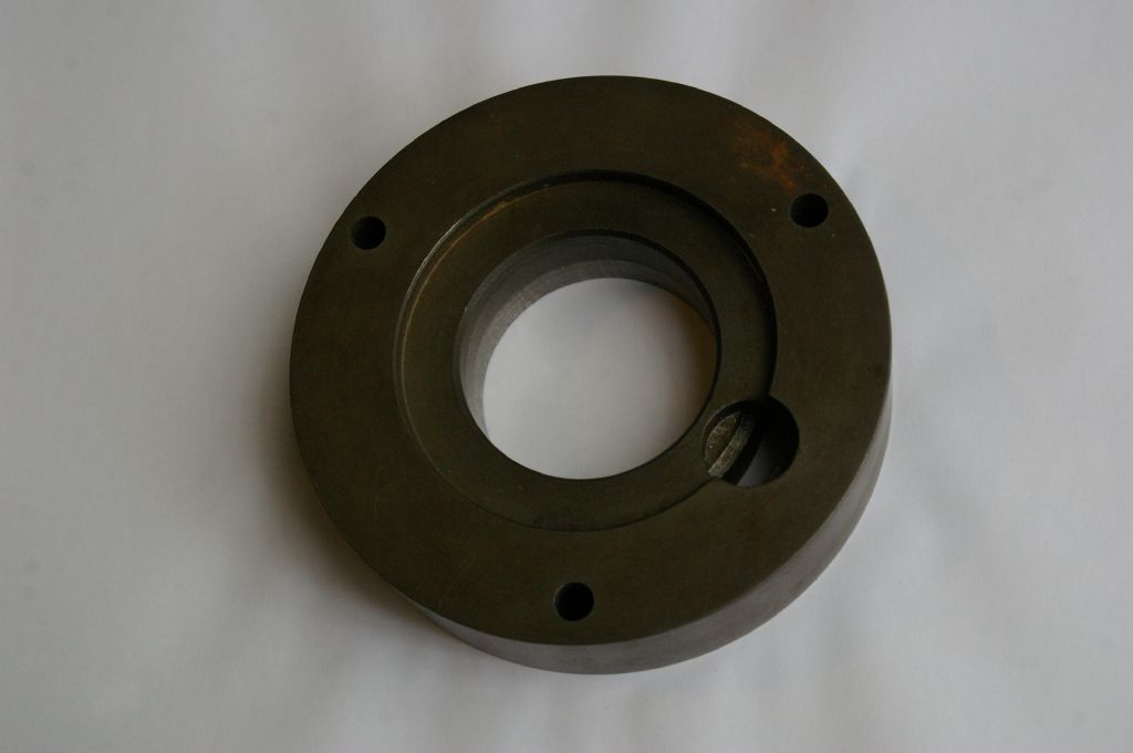

                                Drawing in progress. Meanwhile, does the M1 have a serial number on the vertical surface, just above where the ring mounts on the front, and probably on the RHS? We can date it from that, but I don’t know of any Mill exorcists, I’m afraid… unless I’m one!
                                #56907
                                Steve Garnett
                                  @stevegarnett62550
                                  Okay, I now have a drawing which is probably good enough to make one from, and I’ll take a couple of piccies of it as well tomorrow (especially the Tee nut) and post those in the TS album I’ve already started. If you drop me a private message with an email address, I’ll send you the pdf of the Solid Edge draft of it, which seems to work quite well. There is, of course, no facility to do that here…

                                    Front View
                                    Rear View showing Tee nut entry point
                                    Fixing hardware – Tee nut is turned from 1″ bar and the end is shaped to the slot. All threads are 3/8″ Whitworth, although 3/8″ UNC will do fine. These aren’t on the drawing, because there’s enough info here, I think.

                                      Well, Jim now has a drawing which he says is understandable and clear (phew!), so with a bit of effort on his mentor’s part he should be able to create one of these for himself, I hope. And hopefully I’ll be able to put mine back together soon, although I still have to do the mod to the driven shaft to enable adjustable preload, rather than have to rely on shimming it.
