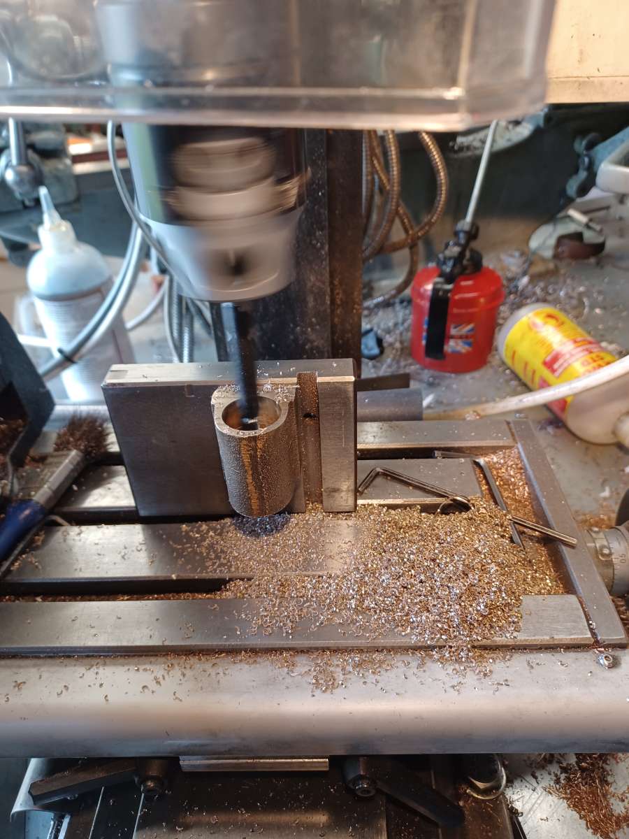

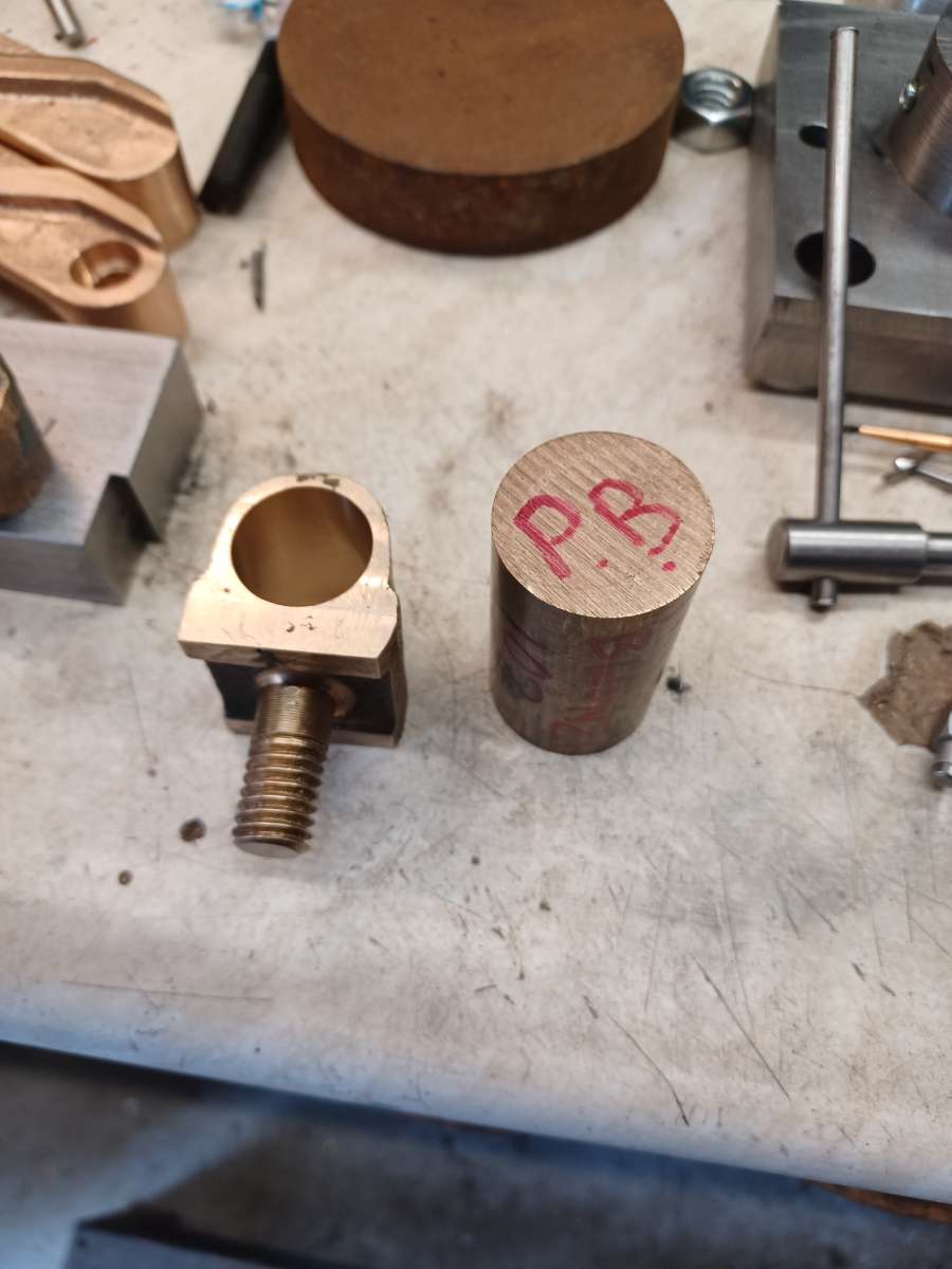

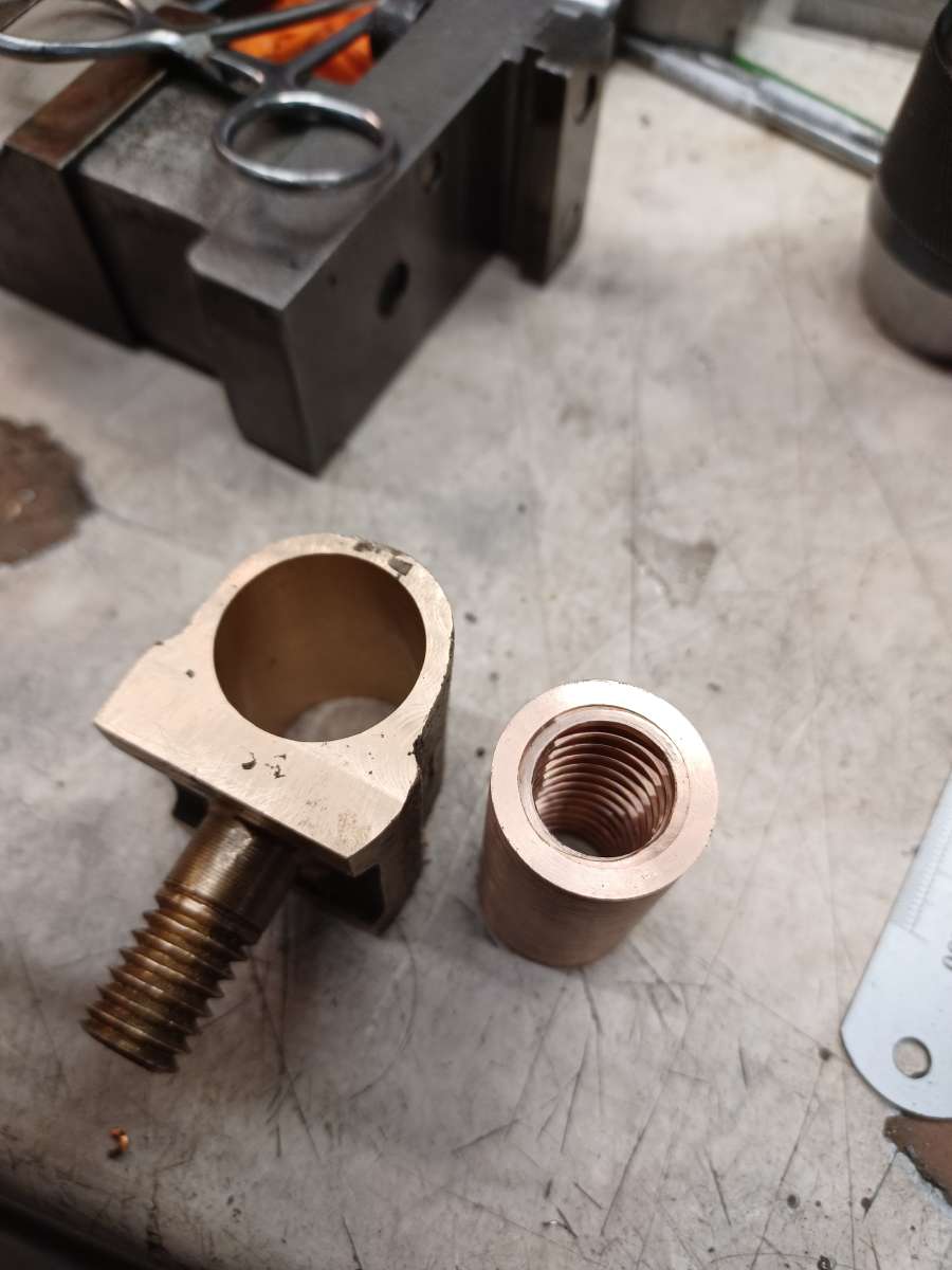

      Help With a quandary.
      I have a bronze casting which comes from a 1918 ish Early M Type Drummond lathe which needs replacing as the internal thread was totally shot. I have made replacement half nuts for later models which are screw cut easier as the leadscrew on the later models  are 3/4″ outside diameter where as the earlier were only 5/8″ diameter and as a closed solid nut not so easy to screw cut working down a 1/2″ diameter bore in a solid piece of Phosphor bronze is a bit time consuming but I managed to cut a reasonable thread in a bush to insert into the bronze casting which I have bored out on the mill to take the replacement bush.
      20260410_165005
      20260410_170811
      20260420_150620
      I have bought some high strength silver solder and flux from Cup Alloys which they recommended and now ready to solder the bush in place with a slight clearance for the solder to flow I am in a quandary will heating the parts to solder, distort the thread or should I fix it in place with a Loctite product!
      20260420_152022
      20260420_152132
      Just wondered if anyone who silver solders parts together may have more knowledge which may give me more information.
      David George

        Hello David, I recently silver soldered a fabricated top slide nut for a Myford S7 it came out OK although nowhere near the size of the nut you are soldering, I also had the advantage of a tap to help with the clean up.
        If you do solder it may pay to file some small grooves down the bore to help the solder flow through.
        The loctite route would probably work, certainly no clean up needed, you could always fit a cross pin on the joint afterwards to give a bit more security or maybe a grubscrew vertically down the joint line.

          Just use loctite, no risk of distortion and can be disassembled if needed.
          I did a similar repair on my Elliott model 00 mill y axis nut several years ago, boring out the cast iron nut and fitting a bronze sleeve. I fixed the sleeve in place with loctite 603. It’s given zero problems in about 8 years of service.

            I suggest soft solder would be the most appropriate, although I’m sure the right grade of Loctite would be just as good.
            One big advantage is that either method ‘undoable’ so in a hundred years time a future owner of the lathe could replace the bush you have made (Best leave some notes written in indelible ink on suitable paper).

              +1 for soft solder, but make sure it’s lead/tin solder, not the horrible ‘lead-free’ stuff that doesn’t flow anywhere as readily as the ‘proper’ stuff. No worries about strength: it’s loaded in shear, and the joint area is considerable. I don’t think there would be any need to silver solder.

                Thanks Foe all the Replies and I have decided to Locktite it as is less likly to cause a distortion and should hold with the area in contact.

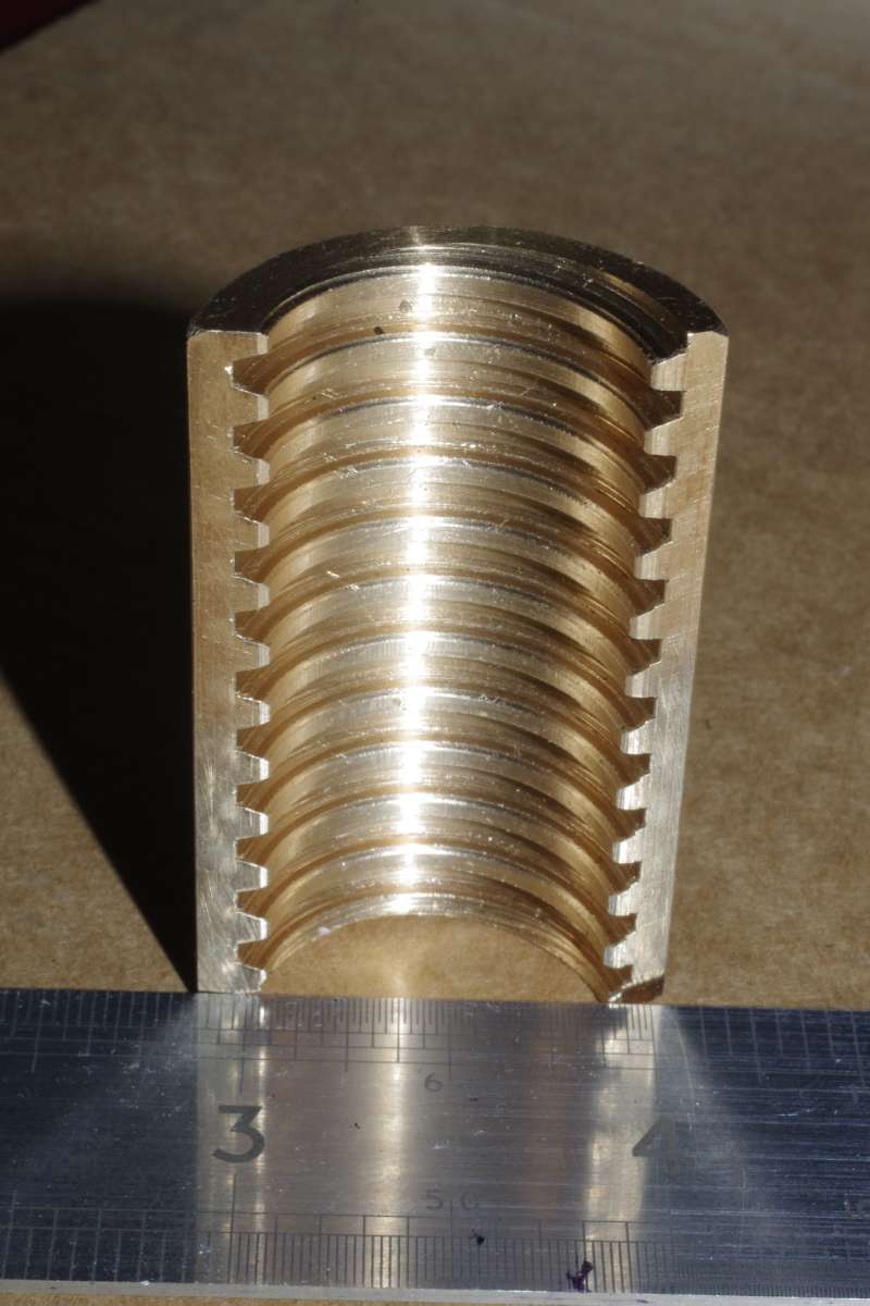

                          Loctite would be effective and very easy because your joint surface is very large. I soft soldered a part thread insert into the leadscrew nut for the Smart & Brown model A lathe and have had no bother since. I tinned both parts before letting them fit together by gravity upon final heating.
