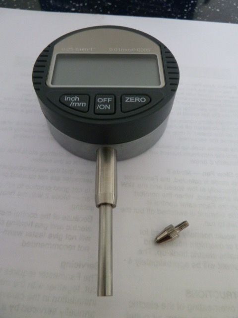

      I tried google but it just shows howto measure thread pitches which i know.
      But i need to check the thread pitch on a small part that measures 2.48mm diameter. Some of you may think thats huge and easily done but I am struggling to see how you do it accurately.
      I have thread gauges but at that small size it has me stumped. My gauges go low enough but its the reading of them that puzzles me.
      I marked the item and gave it 2 full turns, but only had the digital caliper to check it. It closed up by 0.78, divided by 2 turns = 0.39 so probably a 0.4 pitch? Wrong way of doing it?
      What do you use to accurately check that is correct?

                    Hopper
                      @hopper
                      Posted by Dave Smith the 16th on 11/06/2016 05:41:28:
                      Nope not connected with the seat motor, this is the shaft from a dial gauge.
                      YOu have the perfect instrument to mesure the pitch right there. Set the plunger shaft tip on a flat surface, with dial gauge suitably bolted down. Set dial to zero. Mark the shaft. Rotate shaft tip one turn so that the thread unscrews. Read the pitch off the dial gauge dial.

                          Dave Smith the 16th
                            @davesmiththe16th
                            OK i set the gauge up and took a reading of 6.8mm, Unscrewed one turn and it showed 7.2mm.
                            0.4? Measured the thread diameter with the micrometer and its 2.42mm.
                            Do these tally?
                            Thanks.
                            PS, just found my M2 0.4 taps and the shaft is too small, so 2.5 appears to be right.
                            Cannot be certain of the thread pitch but it appears right. Need a microscope..

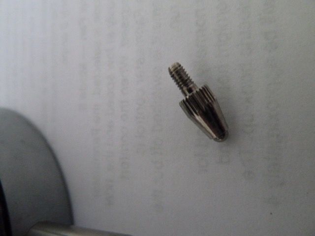

                              Chris Shelton
                                @chrisshelton11794
