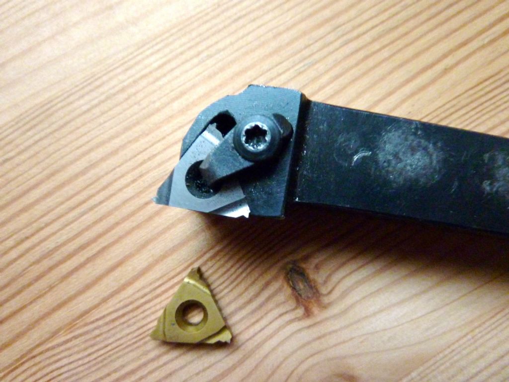

              As said a full form insert as shown in the pic is the best way to get an accurate form , no need to set the compound rest over but just align one edge of the insert with say the chuck face and then cut until the thread outside dia is dead on and then from there its only a few thou to get to a 3A limit , at work we used thread parallels and ring gauges to check final size. but in the absence of these measuring the od of the thread works well.enough.

                Thank you for the information regarding full form inserts, this is the first I have heard of them. Sure enough they are the answer to my threading form, excellent inserts to have in the UNEF pitches I am working with.
                Thanks for showing me these gents,
