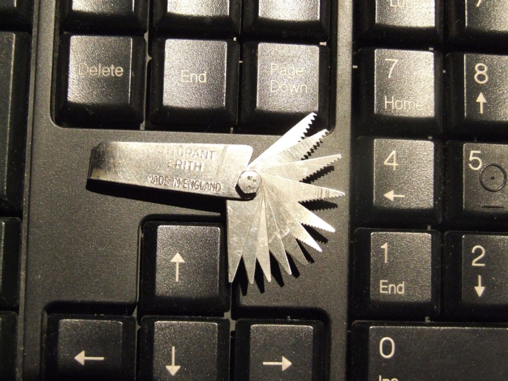

                        Watford
                          @watford
                          Posted by Robin Graham on 21/10/2019 23:44:39:
                          I'm making a holder for carbide turning bits. I have M2.5 screws for them which (if I understand the convention) should mean, in the absence of qualification, that they are coarse (0.45mm) pitch. Just wondering if anyone can confirm that before I buy a tap. The darn things are just too tiny for me to measure with my geriatric eyesight!
                          Robin.
                          On the subject of geriatric eyesight I found these BA thread gauges the other day. 10BA is a bit taxing eyewise .
                          Manufactured by J.H.Grant of Erith. Anyone heard of them?
                          Mike
