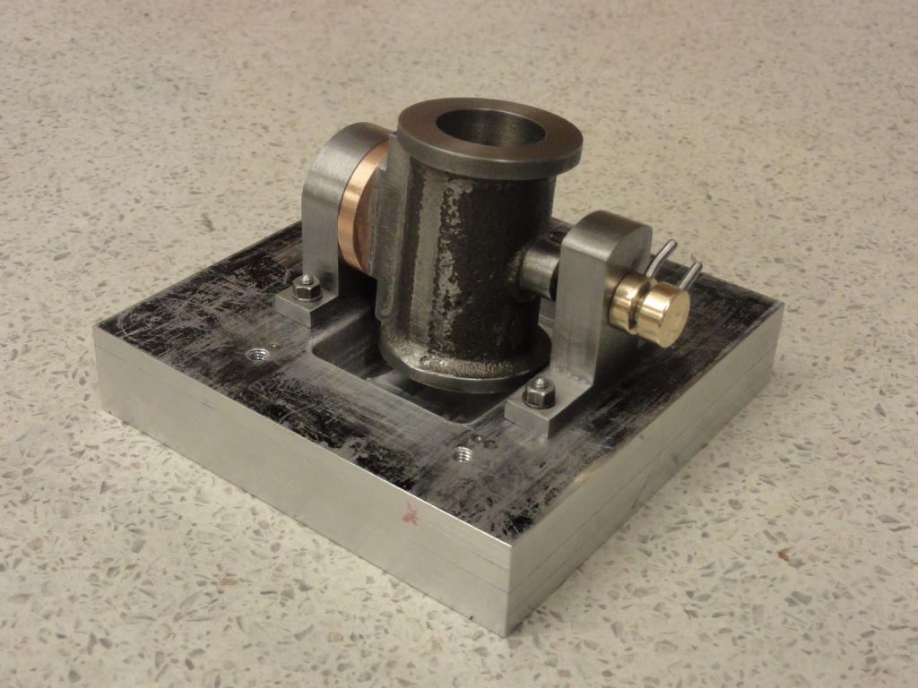

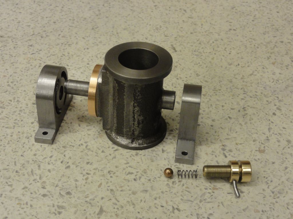

                        Progress over the holiday period on the Muncaster Double Acting Oscillator.
                        Finished off the cylinder mounting arrangement but deviated from Muncaster's plan by incorporating a spring and a bronze ball to hold the cylinder port face to the air inlet block.

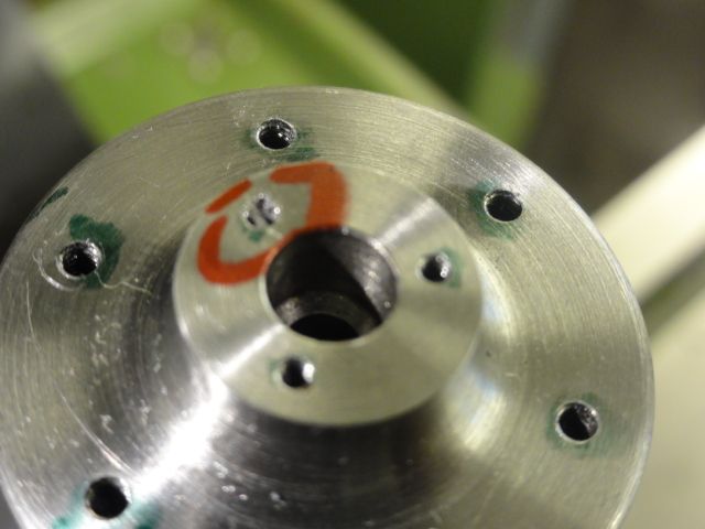

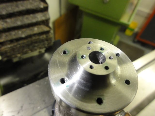

                        Then made the cylinder covers and all was going well until I was given a chance to test my New Year's resolution not to yell bad words whenever anything went wrong. I broke a 10BA tap in the con rod stuffing gland. I managed to retain my cherubic demeanour and calmly considered how to avoid making a whole new cover.
                        I had planned to use 3 studs so the solution was to leave the broken tap in situ and drill and tap another 3 holes in the cover and just turn the gland through 60 degrees. This time my taps survived.

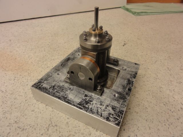

                        The now almost completed cylinder just needs banding to retain the planned wooden insulation but that can wait until the finishing phase.
