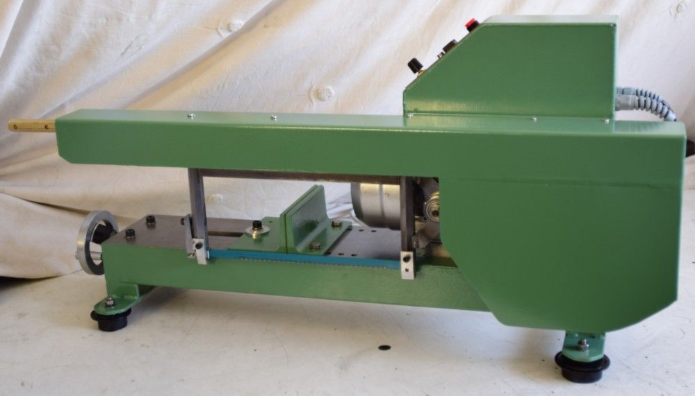

                Joseph Noci 1
                  @josephnoci1
                  In late 2017 I obtained a neat 3 phase 250watt motor with attached Varvel 100:1 gearbox and thought that was ideal for a bench powered hacksaw. It sat under that bench for a year..Mid December last year I challenged myself by starting the project, but on the basis that I do it only with bits from the scrap box/store, etc, ie, no purchase of any bits not within the workshops! ( Except hacksaw blades, of course…)

                  The base is a piece of 150mm x 75mm x 8mm channel iron, shapered flat and milled for the vice, etc. The saw frame slides are 18mm Hex, steel for the fixed and brass for the reciprocating frame. The slides pivot on large bearings that are also on the main drive shaft out the gearbox. In the top hat is the 500watt VFD, and the on/off/speed control. Speeds are from about 2 strokes/sec to position the frame when checking stroke length (inching..) up to 130 strokes/sec.
                  Views with all guards in place.

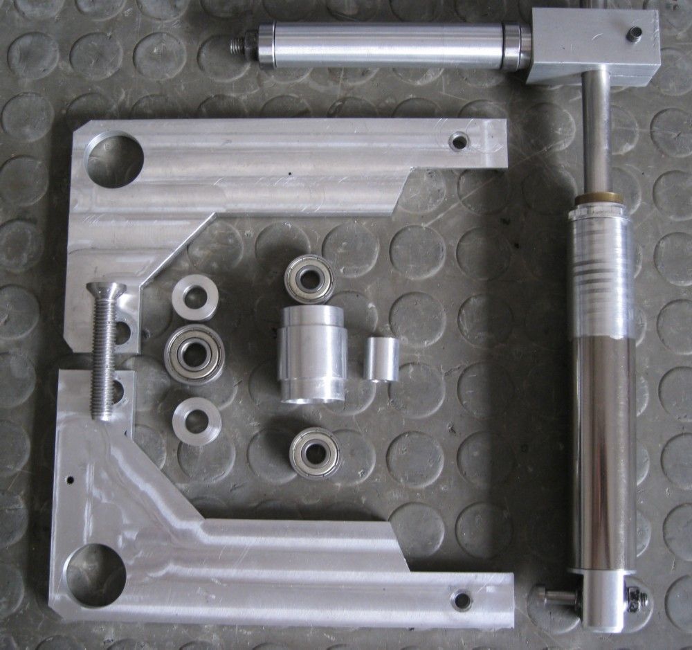

                  The hydraulics are seen here – The tube (right) from an old mountain bike front shock
                  This is the cam activated blade lifter during the return stroke – worked OK, but eliminated by appropriate crank moments placement and geometry, with only a damper used. See it working in the video
                  The drive con-rod, ready to weld up. The crank has three throws giving strokes of 220mm, 160mm and 80mm, allowing optimal use of the full blade for different stock sizes.
                  The oil distribution grooves in the fixed hex slides – fed from an oil well in the top support – one-shot oiling..
                  The oil well.

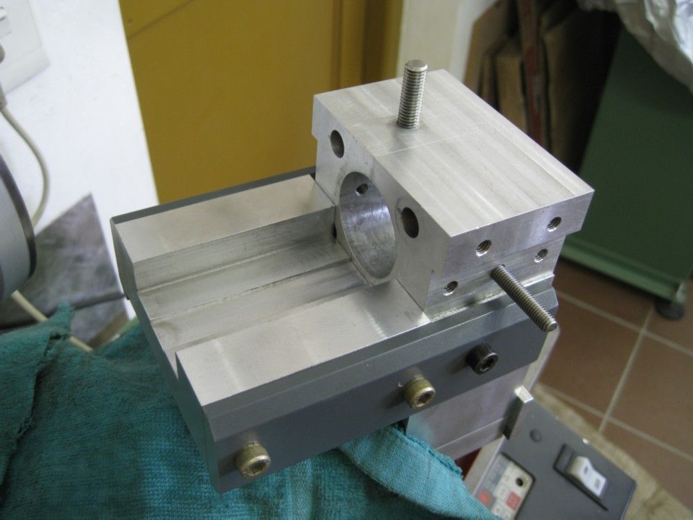

                  The saw frame and slides.
                  Blade Tensioner.

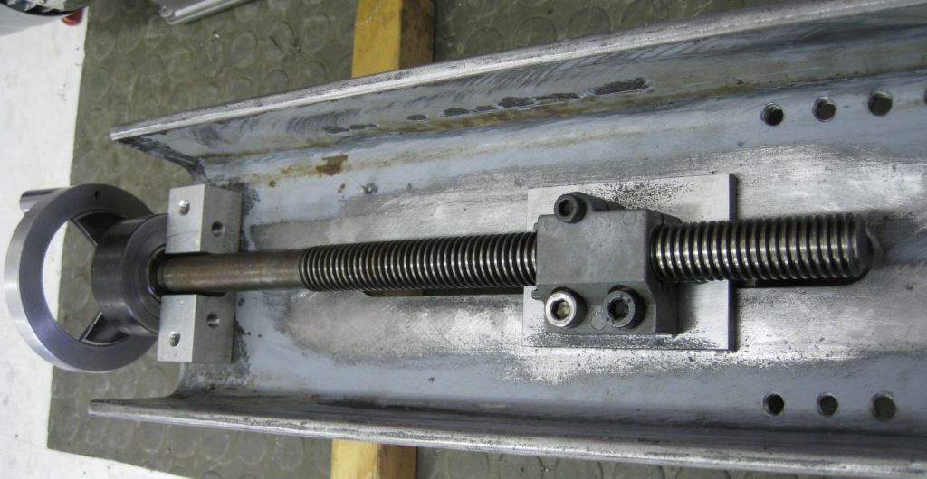

                  The vice/screw – made from an old imperial X leadscrew from and EMCO FB2 mill.

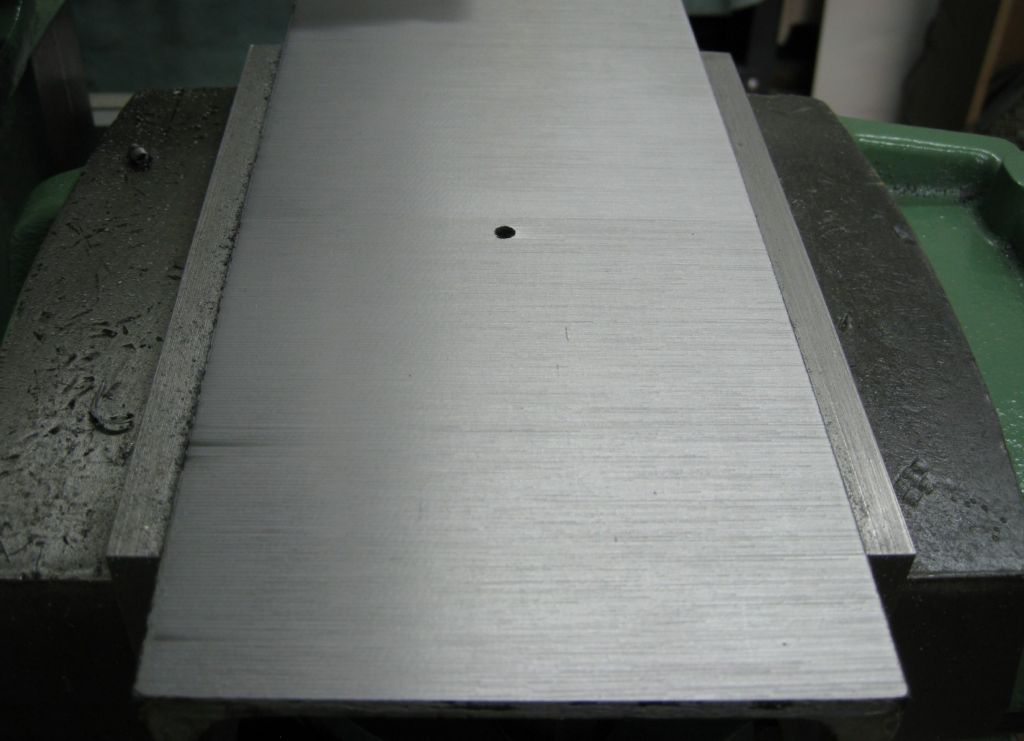

                  The shaper flattening..
                  And…

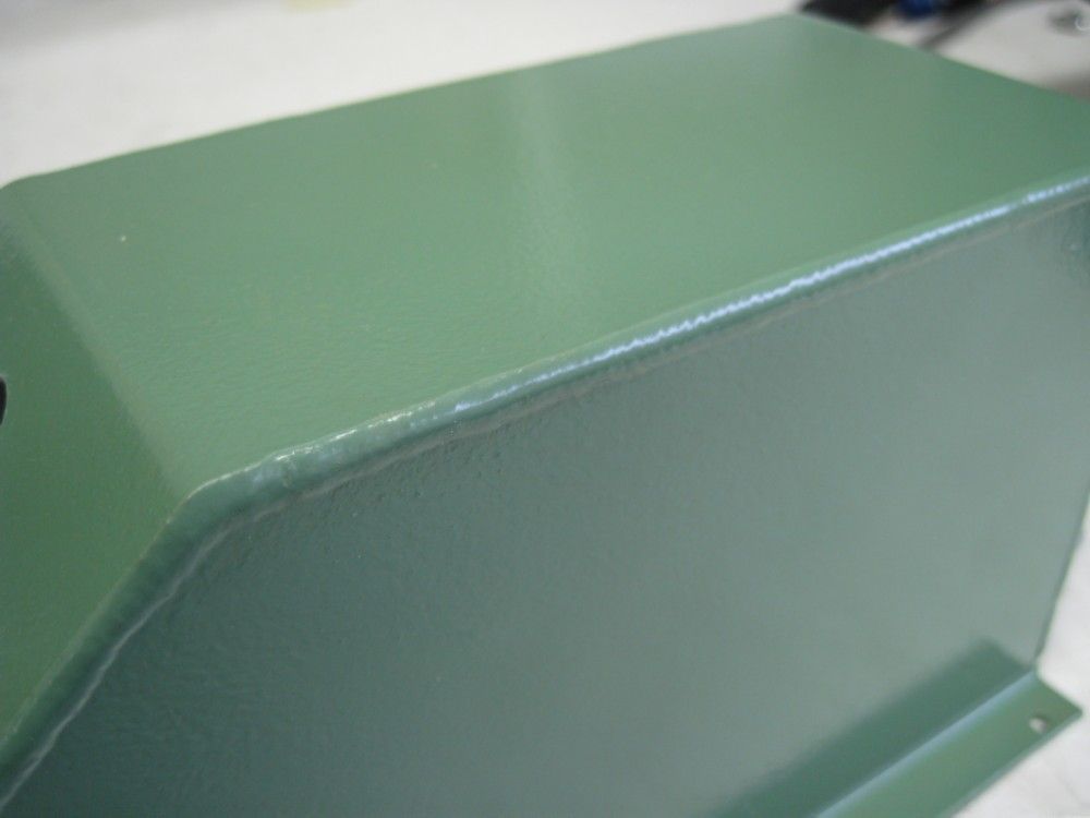

                  The TIG welding on the Ali covers was so good, I just painted over and did not smooth down! ( patting my back..)nice tig weld.jpg

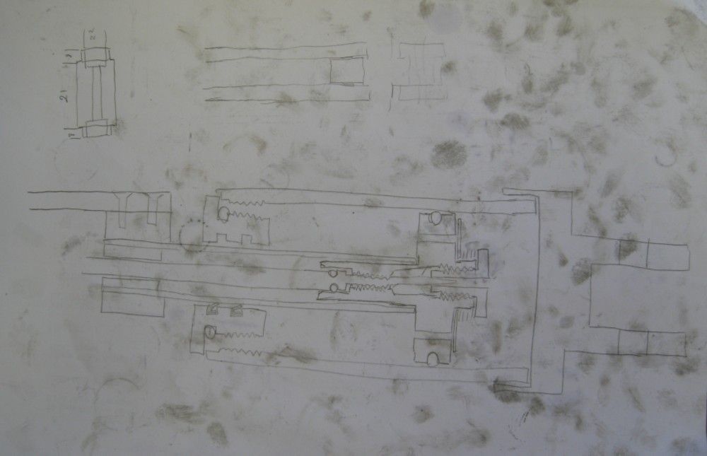

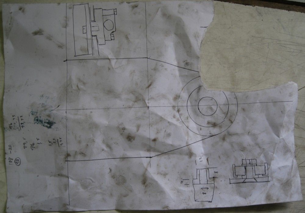

                  All my 'CAD' design drawings for the complicated bits…
                  Hydraulics..
                  A video link below- does not neatly stand on its own, but shows the workings well enough. The blade reliever during return stroke was a trial only really – the cam has a 2mm offset, which through the lever gave a blade raise of 4mm. This needs to reduce to maybe 1mm, ie, cam lift of 0.5mm or so – But the adjustment of the hydraulic drop rate is just to finicky in this mode, and the damper only mode, coupled with proper crank throw moments works best Also, the blade front is 1.5mm lower than the rear mount, and that with correct damping drop rate works very well.
                  **LINK**
                  Took 2 weeks to build, finished on the 1st Jan 2019…And Neil, I was ALSO crimping wires for this on Christmas day!
                  Joe

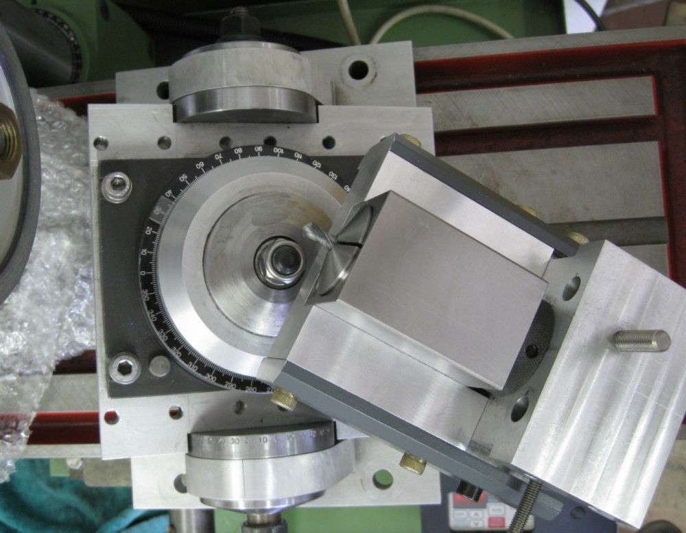

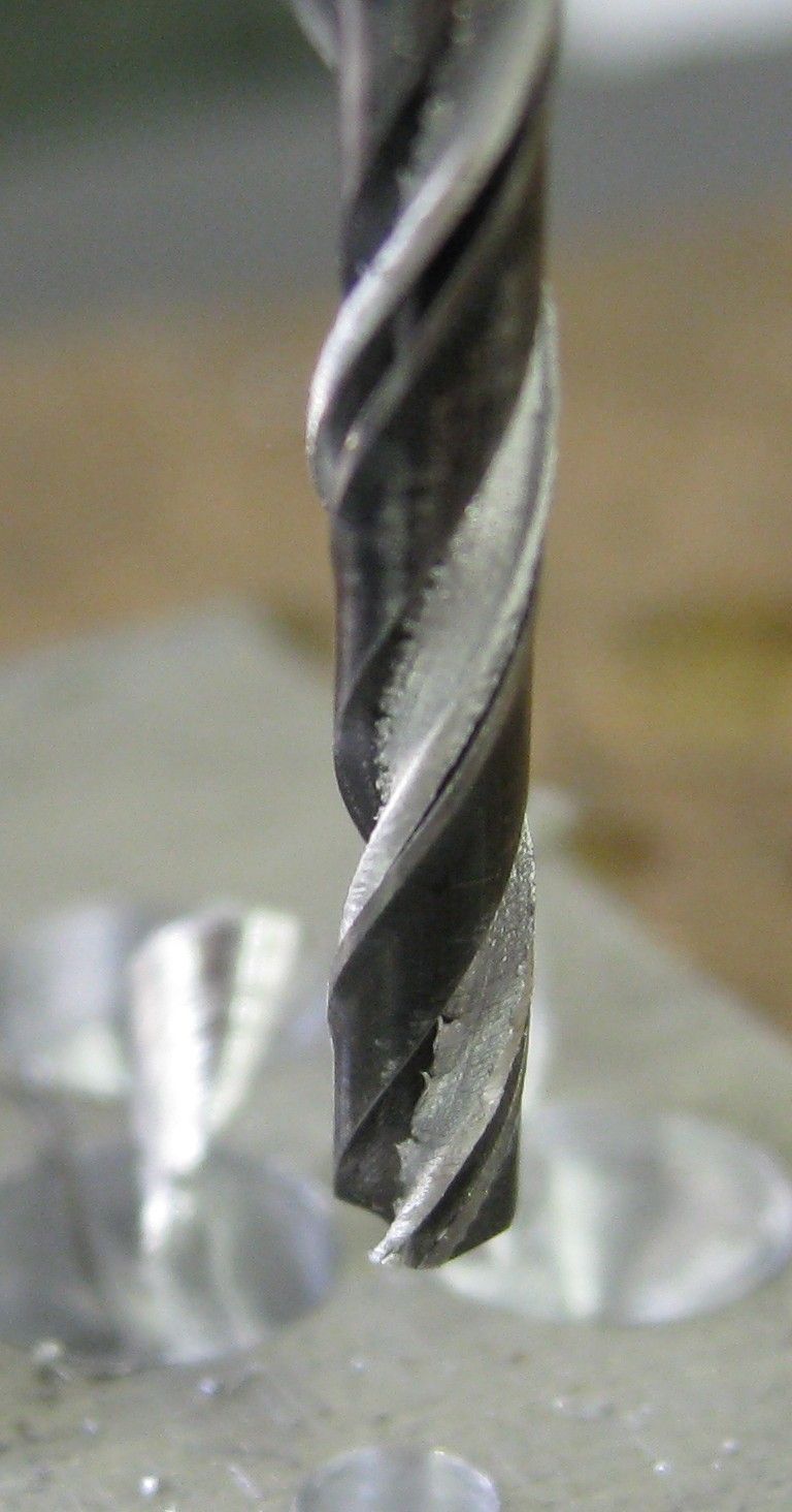

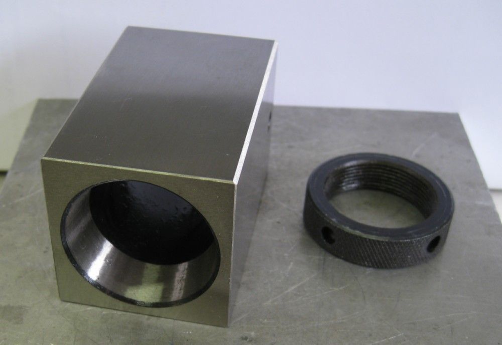

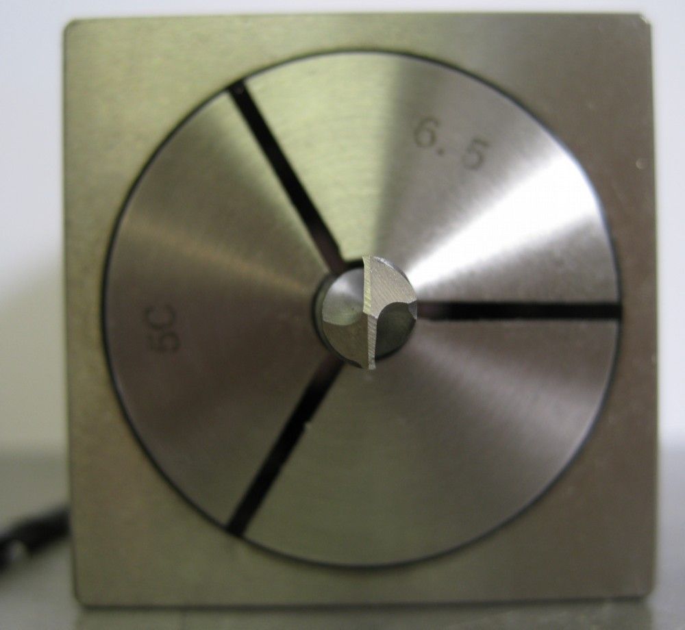

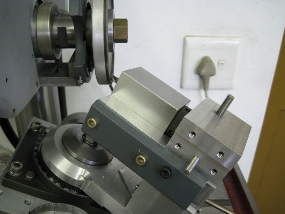

                      After building the saw I decided I had better do something about all my poor condition drill bits..
                      I have a neat T&C grinder that does drills very well, but is a huge pain to setup, so tends to not be used for drill sharpening. I always thought a jig such as the one in March 2000 (issue 64) MEW was a good idea, and when I got hold of a square block 5C collet holder I decided this morning to knock up a similar adaptor for my grinder.

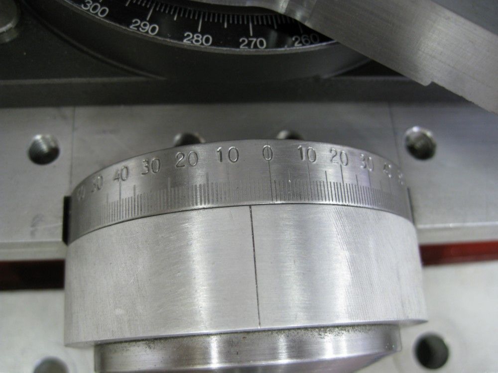

                      This is the universal tool head on my grinder – does all, but requires a lot of set up.
                      The 5C collet block
                      With a sharpened drill still inserted

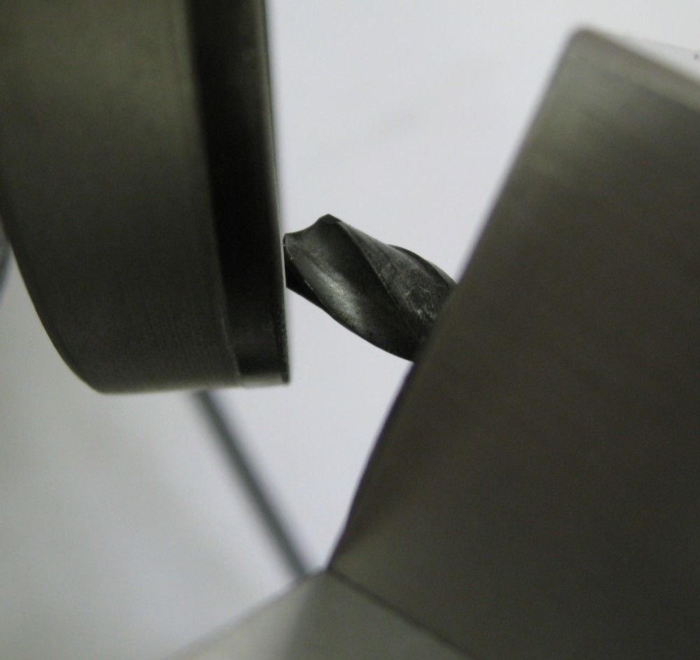

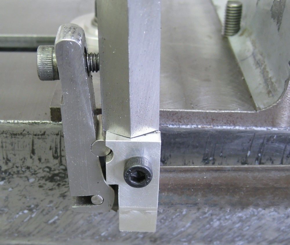

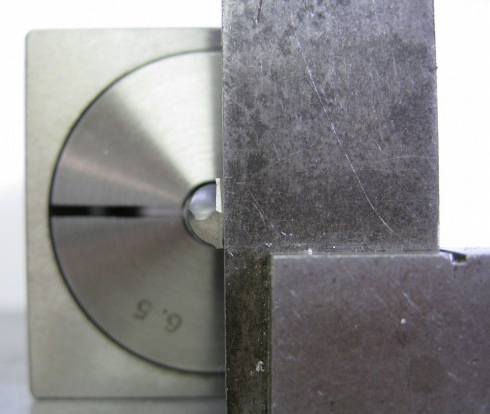

                      Method of aligning the drill edges

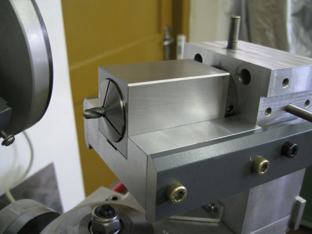

                      The universal tool head with extraneous removed and a fabricated Collet block table fitted
                      Collet block with drill in place. The block is heavy and stays in place with the tilt of the table for the relief angles.
                      25deg secondary relief set
                      Grinding secondary relief.
                      5deg primary relief set
                      View of motion tables from above.

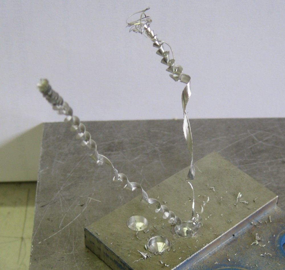

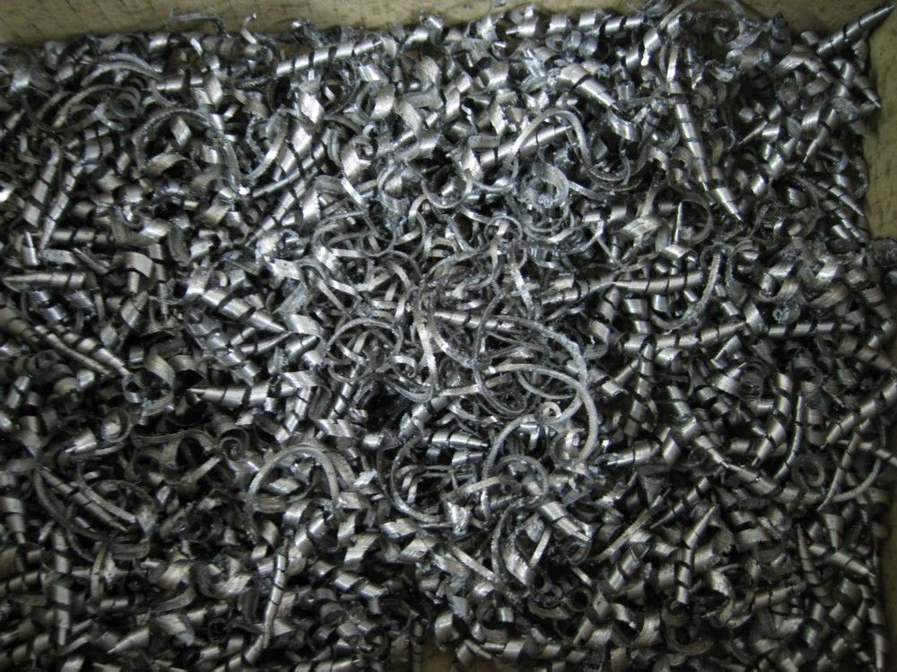

                      6.4mm drill swarf – not to unbalanced..
                      3mm drill swarf. ( poor, soft and string Ali..)
                      Joe

                                    Daveb,
                                    Since the Clarkson has both table traverse and feed, you would not need anything more than what I have implemented – just a firm tray/guide to hold the square collar block and a means of setting azimuth and elevation angles. Since the drill tip included angle can be fixed, that one is easy to do, and then a means of setting 25deg and 5deg ( or whatever takes your fancy) for the primary and secondary facets in the remaining plane is all that is needed.
                                    I was very pleased with the accuracy of the collar block – it is a chinese block and was inexpensive, but is ground parallel to within plus/minus 0.002mm across all flats! Fitting a 10mm 5C collet with a 10mm carbide rod in the collet and placing the block flat on a granite block I find less than 0.006mm variation with a height gauge and dial indicator between granite surface and top of the carbide rod, on all 4 block faces. Part of that variation will also be from the collet, so all together not bad at all.
                                    The 5C collet also offers more contact length across the drill flutes which seems to give better drill location on smaller drills ( sub 3mm) than I was obtaining with ER20 collets.
                                    I appreciate the ease of removing the block from the receptacle and being able to quickly inspect the tip grinding progress, and then replacing the block with no loss of register.
                                    What I need to do is make up some sort of optical/magnifying aid to better align the drill cutting edges parallel with two sides of the block, especially the smaller drill. Maybe a small video camera in line with the drill bit tip, and projected onto a PC screen with a cross-hair overlay. Problem with that is that it starts to become too complicated again to get all the bits out, connected and working, before I can sharpen a drill bit…A monocular magnifying eye piece in line would work fine, but I have few skills in that dept – and no optics or lenses to play with!
                                    Joe

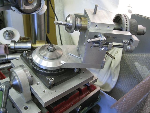

                                          #391239
                                          Ian McVickers
                                            @ianmcvickers56553
                                            I'm in the middle of making a version of the upgraded universal head for the Clarkson MK1 Tool Grinder as shown on the bedroom workshop site. Base plate has been milled to size and a recess cut to accept the upper part. A centre line was engraved across the plate as well but it doesn't show up too well on the photo. Upper part turned to size at 95mm diameter and 110mm high then cut in the bandsaw, about 30 minutes worth of cutting. Hopefully at the weekend I will get some time in the shop to finish milling it and possibly get a scale engraved around the bottom edge.
