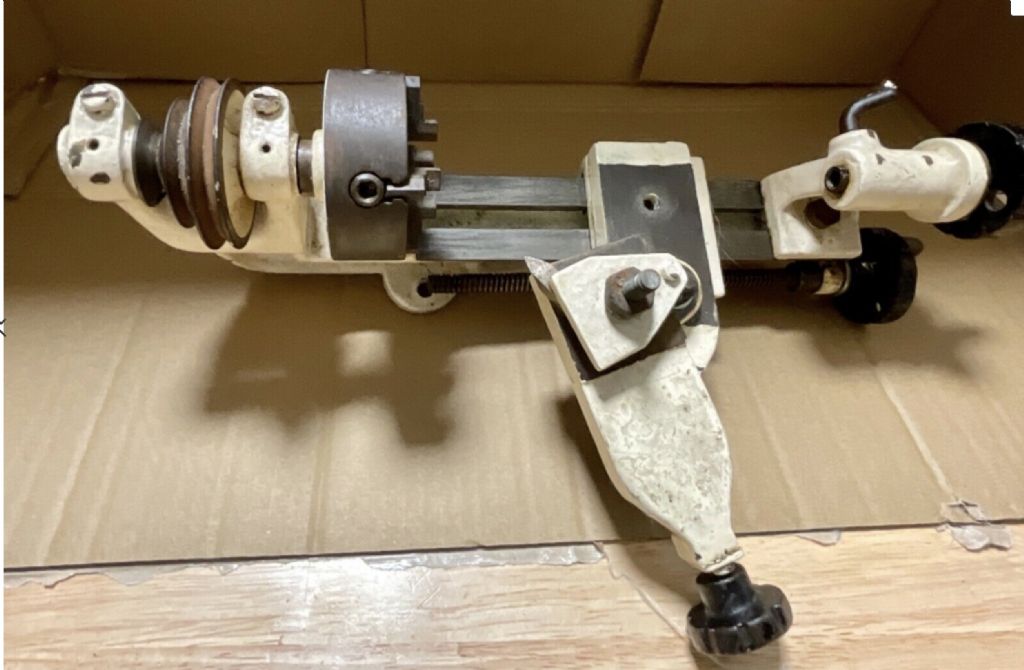

                    Back home and Adept has arrived. I will try and look at it tomorrow.
                    First operation dismantle and true up the foot flat and square to the bed.
                    I think I have a pair of 3, 2, 1 blocks in the shed.
                    So, if I put them under the Vee ways with the lathe upside down, I can run a clock over the foot and use a Dremel grinder to remove the high spots until I get it flat.
                    It does not have to be perfect, just flat enough to mount on a piece of wood.
                    Then check headstock bearings.
                    If they are fine, paint it.

                      Just added photos as purchased from Ebay.
                      Super Adept photo

                                    I have examined the little Adept and it seems to be in good condition.
                                    Bearings are tight but turn ok. Still original paint so not just squashed up. Same with cross slides, tight but screws never been adjusted.
                                    Headstock centre very clean, looks unused. Tailstock discoloured but looks ok.
                                    Bed has a few scratches but they look like original finish to me.
                                    I don’t like the overhanging top slide, looks a week point. I have ideas for better tool posts.
                                    It is slightly smaller then what I thought but will do what I want.

                                      I will have to rethink the Unimat pulley idea, the Super Adept pulleys look much smaller.
                                      Are silicone O rings more flexible than normal ones? I always used normal O rings on my Unimats but seem to remember they were quite hard.

                                                I'd look at poly vee belt, very flexible, but in the ultimate will slip if you get a dig in. Only reservation is can you keep oil off the pulleys? Having a flinger both sides might help. The lathesuk site is quite complimentary about the Super Adept, and it's probably a bit small for a boat anchor
                                                #655865
                                                Pero
                                                  @pero
                                                  Hi David. Welcome back.
                                                  Silicon O rings have been used as drive belts for a variety of small machines and accessories and work quite well. They are probably variable ( by design ) in their hardness but the ones I have used have typically been a little harder than the soft nitrile ones but rather softer than the Viton type.
                                                  They have the advantage of good stretch and seem to get a good grip on the pulley, limiting slip. I would be quite happy to use one as the drive belt on a small lathe such as the adept. The other options to consider are a polyurethane belt ( diy cut and join version ) or a small toothed belt.
                                                  Good luck with the lathe, it looks from the photo to be in very good condition considering its age.

                                                    As your pulley is between two bearings I'd go with the round urathane or green round belts that can easily be joined at home rather than having to cut less grippy O rings
                                                    #655873
                                                      I agree with Jason
                                                      Generalising outrageously from just a single comparison:
                                                      The textured green belts coming out of China seem to be a very good approximation of the expensive Swiss ones
                                                      … except in price !
