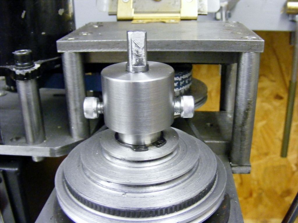

                      #327887
                      Journeyman
                        @journeyman
                        Is it possible to make a captive draw-bar adapter like this:-
                        Saves a lot of hammering and much kinder on the bearings. This example from *** mikesworkshop *** is for a smaller mill.
                        See also this ***Thread***

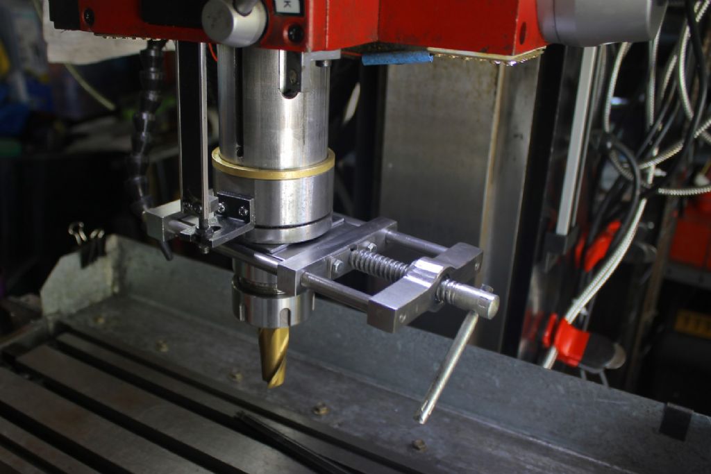

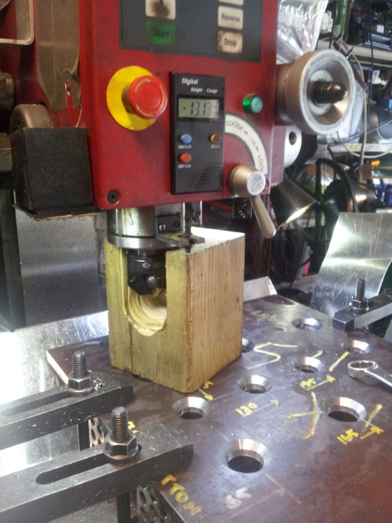

                        Paul Lousick
                          @paullousick59116
                          My mill also has a 3MT and I lower the quill onto a wooden block to support the underside of the spindle to take the load off of the thrust bearing while tapping the drawbar with an aluminium head mallet.
                          If too tight, I use a wedge clamp to remove the cutter. (Details were published in MEW. Can someone remember which issue). Paul.

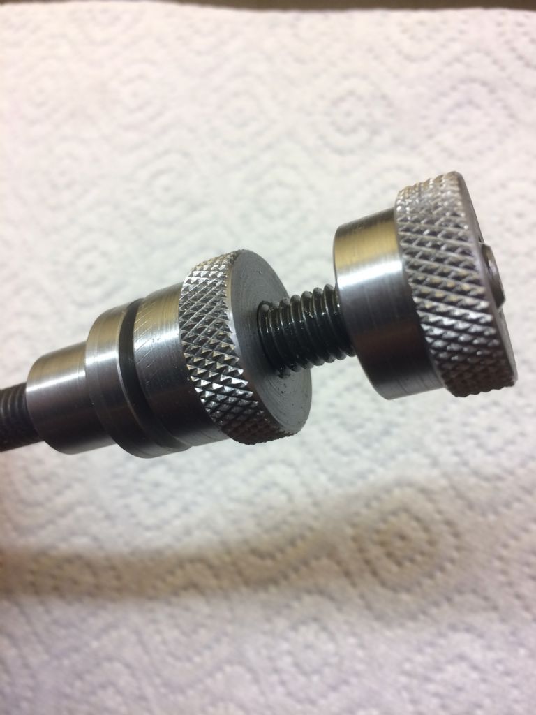

                                      #328372
                                        My simple self-releasing drawbar for X2 mill:
                                        http://www.model-engineer.co.uk/forums/postings.asp?th=63585
                                        Little 8mm square used for tightening, has never come loose.

                                          #328722
                                          oldvelo
                                            @oldvelo
                                            Hi Jens
                                            Check my albums for all size lock bolts
                                            Eric

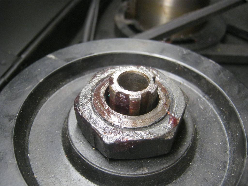

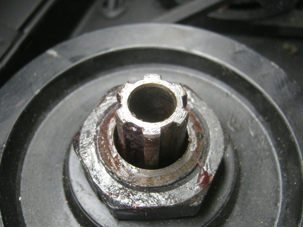

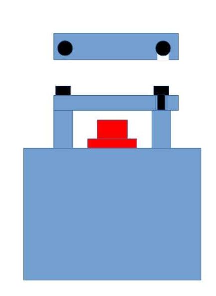

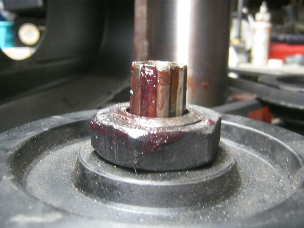

                                              #328928
                                              Howard Lewis
                                                @howardlewis46836
                                                To minimise loading the bearings, make an extractor for the Drawbar.
                                                My method was to remove the pulley retaining nut, (On the RF25 Mill/Drill, it is a Left Hand Thread) and turn back the hexagon for a length of 3mm. I then made up a 3mm plate with a central hole that was a running fit on the new plain diameter of the nut, and with two symetrically placed tappings, towards the outer edge. Then made up a similar plate, but with with two clearance holes to match the tappings in the first plate, but with a central tapping. (Threads were 1/4 BSF in my case, but M6 nowadays, I would expect).
                                                Dimensions are not critical, as long as the captive plate provides a large enough area bearing on the underside of the nut, but do not take too much off outside the thread. Midway between the hexagon and the thread O D should be O K.
                                                Place the plate with the large hole over the shaft, and refit the nut with the plain diameter locating in the hole in the plate, and tighten the nut to retain the pulley.
                                                When you want to release the Morse (or other) taper, Slacken the Drawbar by about half a turn. Secure the other plate with two setscrews (With nuts below the upper plate to make the setscrews captive) through the clearance holes into the tappings on the captive plate, (equally), and run a setscrew through the central tapping, and tighten it to apply load to the Drawbar. This should break the taper, without loading the bearings. It it doesn't, an additional light tap with a mallet should produce the desired result.
                                                If 0.5D thread engagement for M6 worries you, either weld nuts below the plate, or if a glutton for punishment, use loose full nuts below the plate instead of tappings.
                                                Once the taper is released remove the two outer setscrews and the upper plate, and put aside, ready for use, next time.
                                                Howard
