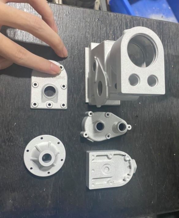

      This video of E T Westbury's "Whippet" being machined would be the perfect example if the machining were stopped before the final holes were done, I'm sure they would sell
      And what a set of "castings" may look like
      I have enquired about costings but as the company can produce a fully working engine for $499 I should think that the castings would be quite favorably priced compared with what is available in this case from Hemmingway at about $200. If so it would be nice to see some of the "lost" engines from the likes of Wall, Westbury and the Motor Boys plans being made available to those who like to build them rather than just the collector of ready to run engines.

                The "castings" that Jason shows above say to me "investment casting".
                Perhaps the dividing line is between gray iron and tempered 356 aluminum; ie: tempered 356 cuts pretty well, and would probably be easier on a CNC machine.
                Gray iron machines well too, but it seems like more power is required.
                From a mass-production standpoint, investment casting is the way to go.

                                                  David Jupp
                                                    @davidjupp51506
                                                    3D metal printing is another possible route to 'castings' of very high quality – perhaps requiring minimal finish machining of sliding surfaces.
                                                    Whilst laser or electron beam systems are still very expensive, extrusion based systems are significantly cheaper and give pretty good accuracy, if not quite as flexible regarding final part geometry.
                                                    All the different options have pros and cons. There is no single 'one size fits all' approach.

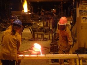

                                                    HOWARDT
                                                      @howardt
                                                      I am of the opinion that castings for this hobby will become less affordable. As years go ny there are less of us so buying less, and the only way the prices can be kept down is volume sales and the equivalent production. Without the sales they cannot cast in volume as it just becomes expensive door stops.
                                                      At the moment I am building a Super Simplex. Cylinder assemblies and all the wheels have been manually machined from solid Ci bar. Much cheaper to buy bar than castings, alright there is more machining to be done but once you think of the process it is not too bad and forget the little imperfections (cock ups) after all it is a running model not an exhibition piece.
                                                      As has been said there used to ge foundries in most towns supporting the local industries. In my early design days I used to work with four foundries locally, ferrous and non. They all went to the wall with the introduction of health and safety requirements for clean air, non could afford a million pound investment, probably the early nineties. The place I was working at moved over to fabrication and machine from solid instead of castings. It was cheaper to machine on the big cnc mill than wait for six months for a casting. At one time the factory had its own pattern shop, probably with half a dozen pattern makers, all of whom got made redundant at the same time.
