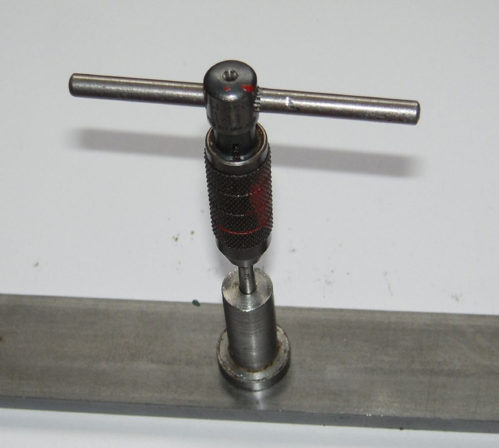

                      Use a tapping block as listed above for small diameters but as most taps come with a centre hole or tapered end, use a spring loaded tapping guide. (lots of examples on Youtube).
                      If you do not have a tapping guide use a piece of round bar with a pointed end (or hole to match taps with a taper) and hold it in the chuck of your mill or drill press.. Exert a light downward force with one hand while you turn the tap wrench with the other. If you do not have a DRO to position the hole. tap the hole after you drill the hole without moving the job.
                      If using a holder like the one above, instead of the tap guide shown, use a round bar with a point. (even a centre punch held in the chuck will work)

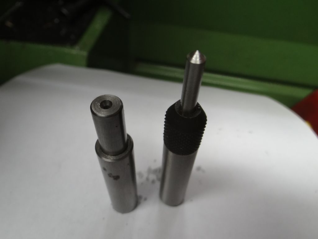

                        I converted a cheap and nasty power-drill stand into a tap holder. Can't find a photo, but the principle of the set up is shown here on my lathe.
                        A couple of spring loaded tap-pushers# are needed to go into the tailstock drill-chuck. Male and female because small taps have a pointed end, whilst big ones gave a dimple. I bought the male example, but had to make the female myself. Not difficult.
                        Used the converted drill stand until I got a milling machine, which does the same job, as the lathe but can take bigger objects.
                        A short fat cylinder drilled slightly larger than the tap can be used as a guide.

                                I do virtually all my tapping on the milling machine using a spring guide like those shown. If I didn’t have a mill I’d do it on my bench drill. Failing that I’d use a block to keep the tap straight.

                                      Tap them while the work is still in position after drilling the hole thus making use if the spindle or tailstock to guide the back end of the tap.
                                      I simply use a short bit of 6mm rod, pointed at one end and ctr drilled at the other so you can locate either a tap with ctr hole or pointed top end. Light quill pressure as you tap, release pressure if you need to back off the tap.
                                      Tap wrench on the shank of the tap so it does not foul the guide and that also allows the wrench to slip before you apply too much force to the tap.
                                      Don't use taper, second or plug much these days, a single spiral flute tap will do in 95% of cases
