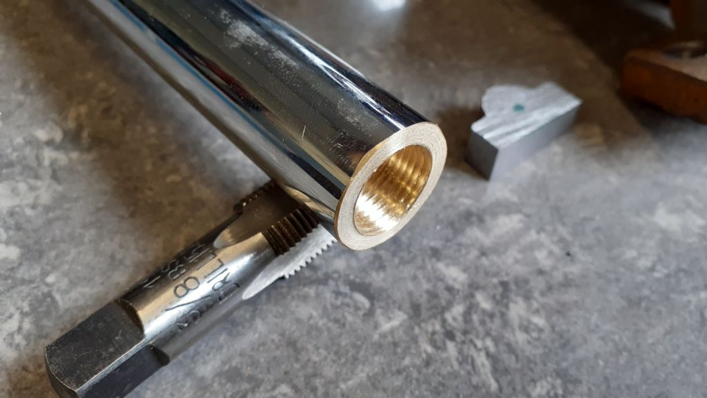

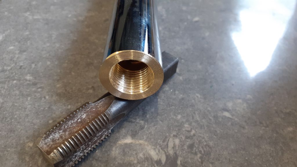

                                  So here are some images of what I have.
                                  The manifold is refurbished and not installed yet, the plug hole is I believe 5/8"UNF.
                                  The adaptor I have (according to the eBay link I included above) has an outer 3/8" BSP tapered thread.
                                  The Taps I bought are 3/8 BSP parallel.
                                  From what I have read, I should be able to run the 3/8" Tap through the 5/8 UNF thread OK and the Tapered 3/8" external thread on the silver 3/8" – 1/4 BSP adaptor should thread in fine.
                                  Second problem is my Tap Wrench is not large enough to hold the 3/8" Tap, any thoughts on what I can hold it with?

                                    Well I though I had better check that I was awake so while in the workshop earlier I put a 14.5mm hole in abit of brass and tapped to 5/8UNF
                                    Actually found I could not start teh 3/8" BSP tap so put a 15mm drill down the hole and then tapped 3/8" BSP, going by the effort needed to turn the tap I would be happy to hang off that thread with my anvil in my pocket
                                    Can just about see a trace of the first thread towards the bottom which is to be expected with only 1tpi difference in pitch between the two
                                    If you can set the manifold up on a drill press or mill then use the chuck to guide the tap and you should get away with a spanner on the flats.

                                        #643330
                                        William Harvey 1
                                          @williamharvey1
                                          Posted by JasonB on 28/04/2023 20:17:22:
                                          Thank you for taking the time to try this out.
                                          I didn’t have a 15mm drill, but did manage to nip the tops off the thread with a 14mm drill. I then managed to re tap the 5/8” UNF thread with the 3/8” BSP Tap using an adjustable spanner and a quick release wood clamp!! Anyway Job Done ✅
