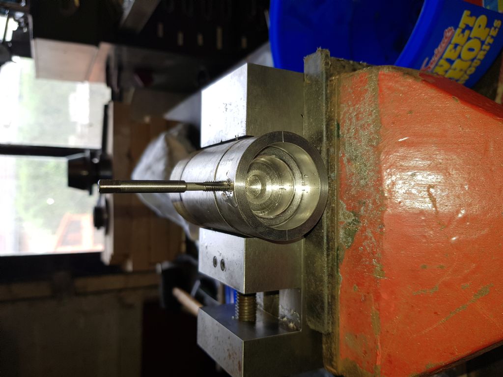

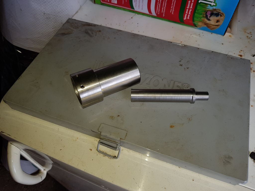

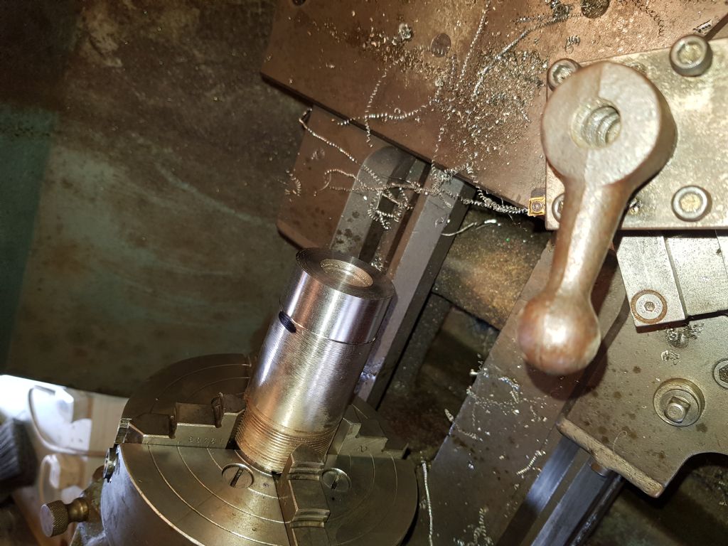

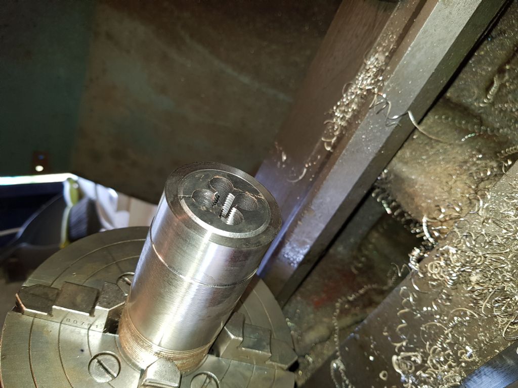

      After posting a question about cutting a m10 thread, some of you suggested macking a tail stock die holder.
      So here goes.
      This project was born from needing a tool to make a tool. As is so often in the home workshop.
      Anyway i was making a toolpost mount and needed to cut a m10 thread. Didn't have a die so i orded one. When i came the OD was 1.5 inches. Didn't have a die holder big enough. Order one no no make one. So i started to make one out of god knows what HARD HARD steel i had. As i was in no rush and not having used the 4 jaw cuck i dug it out and after 10 minutes faffing about got in running within about half a thau. Good enough for me. Some pictures

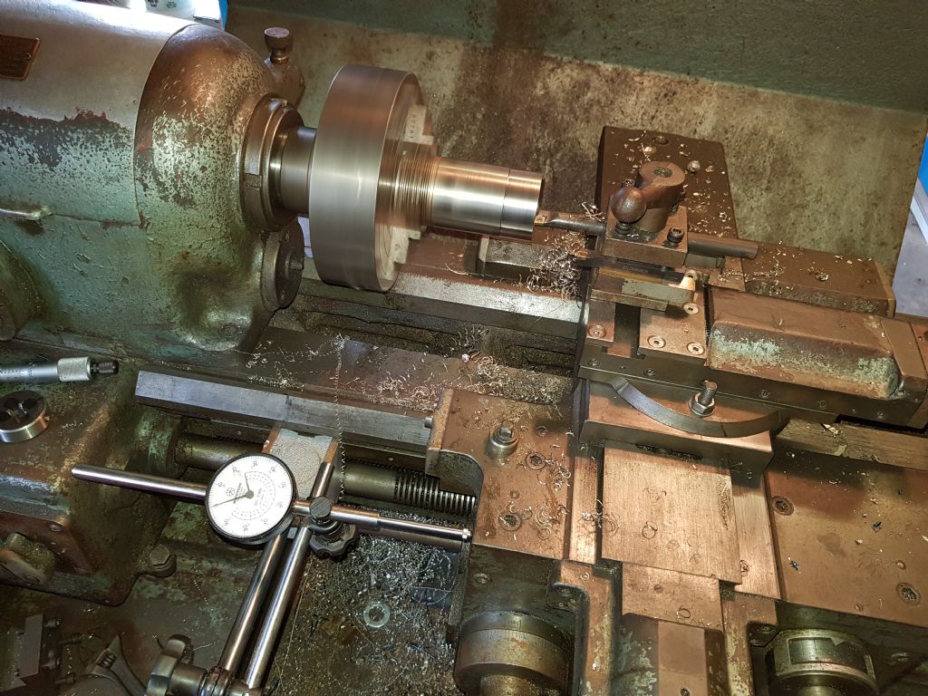

      Started out by turning the OD to what seemed to be a decent size to accommodate to handles.
      Drilled and bored out the the ID to a perfect fit.
      Using the DTI to get to the correct depth.
      In this picture the die isn't pushed all the way in. When it is its perfectly flush.
      Then marked out, drilled and tapped the 3 securing / adjusting screw holes.
      The plan was to cut it off the length, drill and tap 2 holes 180 from each othe and add handles. Job done.

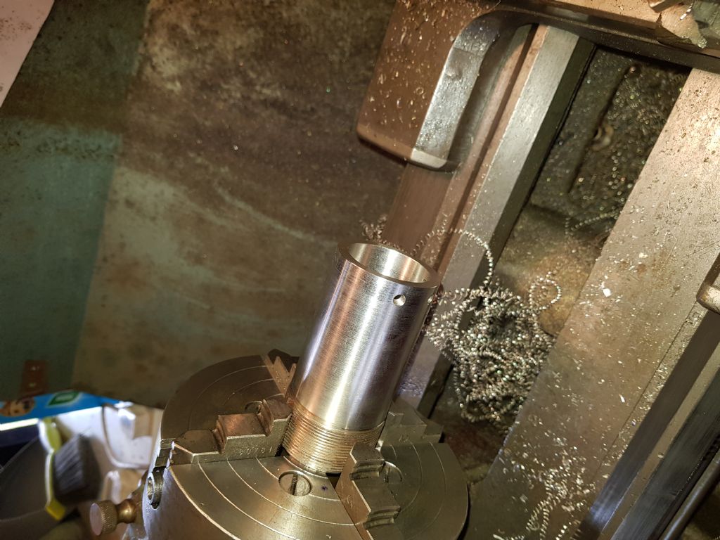

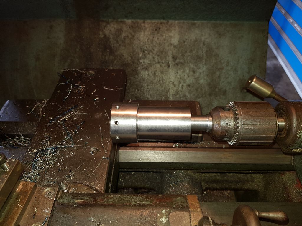

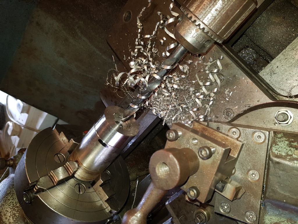

      Well not so. After taking advice from forum members its back in the 4 jaw running true and ill drill and bore through the middle and turn it in to a tail stock die holder.
      Is my skills are at the beginer level im not going to make a mores taper arber. My plan is to bore the through hole 1 or 2 thou over the OD of my tail stock and use the extended tail stock as the running arber if that make sense.
      More progress pictures to follow when i get back in the work shop. Hope you enjoyed read the exploits of a beginner and any advice more than welcome.
      Thanks
      Steve

            Did you leave a small allowance for opening the split die up?. On my 1.5" the bore is actually 1.508
            The smaller ones are 1.003 for 1"
            0.8175 for 13/16"
            and 25.11 for 25mm
            I have no idea what the official standard is.
            Perhaps one of our toolmakers will chip in and tell us.
            regards Martin
            #478218
            Steve King 5
              @steveking5
              I didn't at first it was such a thight fit i had to get the heat gun on it to get the die out. Then the penny dropped and I left about 5 thou clearance.
              Thanks
              Steve
              #478222
              old mart
                @oldmart
                You need clearance to expand split dies for the first cut. Then they are closed down a little at a time to get the final exact size. This gives the best finish on the thread. I have a set, but have never used them, as I prefer to single point using the lathe.

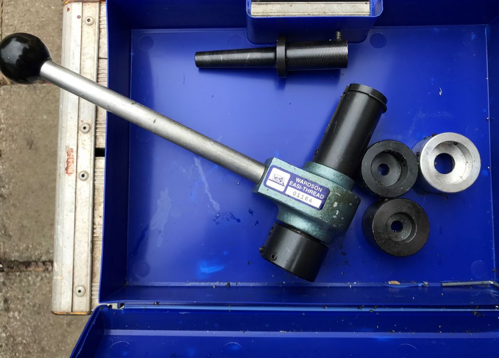

                    +1 for Howard's point. A sliding die holder is preferable to one fixed to the tailstock. I have a Wardson Easi-Thread which has about a 4" slide travel and has a clutch which disengages the die when the lever is released. Reverse the headstock spindle and the thread winds out of the die and resets the clutch. Wonderful piece of kit!

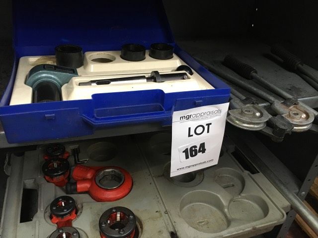

                                Lipscombe Chas:
                                Here are photos of the box the tool came in and the tool itself.
                                There were 3 die holders originally but I made a 4th for larger dies (1.5&quot. The mandrel is 2MT and there is a pin (visible near the end of the parallel shank) which engages in a slot in the sliding part of the tool with a rotating circlip to 'lock' the tool onto the slider. I have a rack operated tailstock so engage the die onto the workpiece whilst holding the lever vertically. The apron needs to be clear of the handle to allow it to rotate about 90 degrees (towards me) to disengage the clutch. I always thread in 'back gear' to give plenty of torque and to allow for slow threading. The nice part is you can thread upto a shoulder with no concerns as the tool when abutting the shoulder turns the 90 degrees and disengages instantly. Reversing the lathe lifts the lever back tothe vertical and the die holder re-engages and winds the die off. The materials I commonly cut are A286 stainless and T614 Titanium. The lever is long enough to be able to comfortably hold by hand whilst cutting the thread.
                                I can't remember where I got this tool from but seem to think it was from J&S Industrial at Wednesbury in a 'clear out' they were having. Most likely about 10 or 15 years ago! I have seen one other at an agricultural engineering workshop nearby to where I live – they used it for making studs for agri equipment on a regular basis. Once set up it will knock out studs in a fraction of the time.
                                Definitely not a sewing machine threader!

                                      Thanks for all the advice, this project is now complete. Well as for the M10 die its is. I still want to make adapters for the other size dies i have but that will be for some other time.
