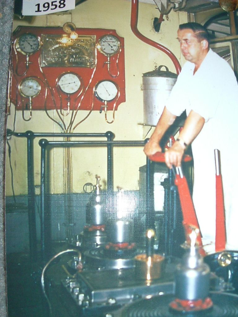

      i have found a photo of a K class engineer at his controls and he had 3 levers- can anyone tell me what the other two might have done?

          Can we see the photo please? Sounds like an interesting model

            Simpling valve and draincocks ?

              Mike – would agree, that seems a likely explanation, only other thought was did it have a variable pitch propellor? Or did one lever reverse the propellor pitch, the boat was designed to go both ways, or were there two propellers, one at each end, and one lever swapped the engagement over from one prop to the other dependant on which way the boat was required to go?

                  The ferries did not have variable pitch props
                  AFAIK both props (one at each end) turned irrespective of which way the ferry was going. The FWD rudder was secured amidships (I can remember them doing that!)
                  The 1958 engineer I think is on a larger Manly ferry – they were a 4 cyl triple expansion – a smaller LP cylinder at each end, the closest cylinder perhaps not seen. The rod with the bronze bush is (AFAIK) the IP valve rod – used as an indicator to avoid stopping at a dead centre of the HP.

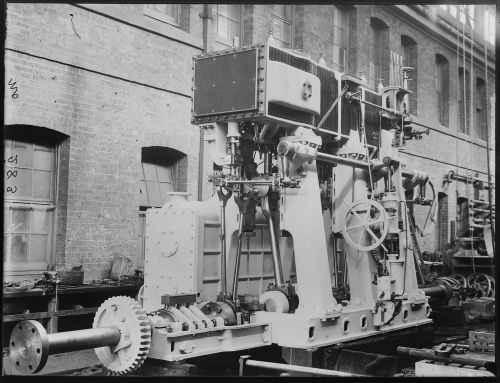

                    I have found a further clue!
                    The fwd/reverse lever was most likely to operate a steam-assisted valve gear system – ie the engineer didn't need to pull the gear over with the lever, but simply operated a valve for a steam ram- seen near what must be a manual override wheel on the BW photo.
                    There are 4 levers on that engine!

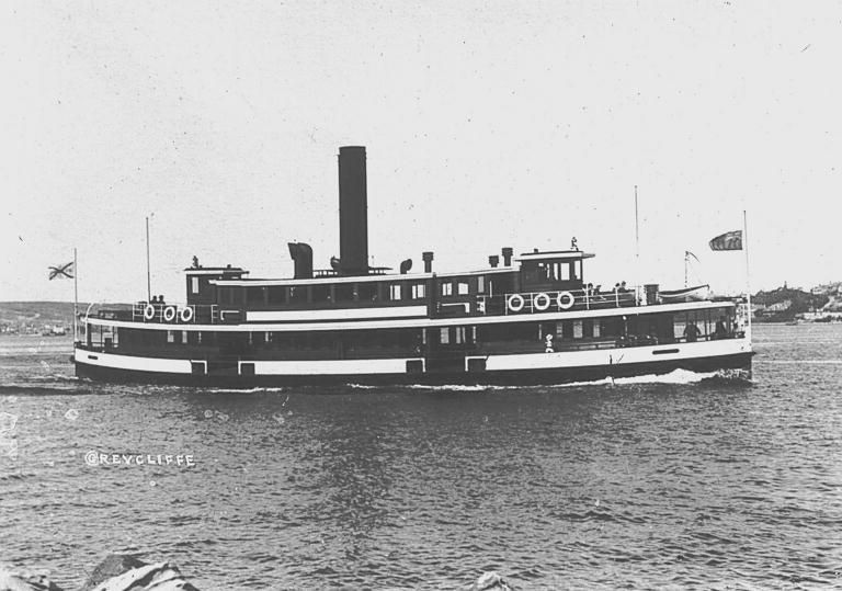

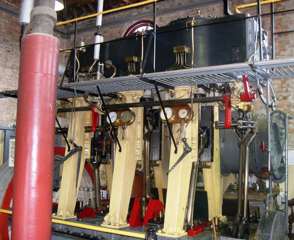

                      There is an engine from a Sydney Ferry at the Museum of Transport and Technology in Auckland NZ. It looks just like a scaled up Bertinat triple. It came out of a ferry (the Greycliffe) that was sunk in an accident when it was rammed by the Tahiti. (An NZ ship.) The engine was salvaged and ended up being sold to a dairy company here in NZ. So the thrust bearing has gone and instead there is a large stationary engine type of flywheel with rope grooves cut in the pulley. I don't think it has power reversing, but it is a while since I have seen it. It does have a worm and wheel arrangement that can be engaged for barring the engine over by hand. Compared to the one in the black and white photo, the condensor is at the other end and there is an Edwards air pump and I think a feed pump at the near end.
                      You can read about the Greycliffe disaster here: **LINK**

                        Thanks- found that MOTAT engine on google. It has a single long lever for the rev gear, hanging off one of the valve covers. The controls are set up to suit an engineer at crankshaft level.

                                  Bear in mind that the reversing arrangement on the Motat engine may not be original. The engine used to run on steam quite frequently but the current Motat management has managed to acheive the resignation of the qualified fireman and the steam section manager, as well as the entire set of steam section volunteers, so it is unlikely that anything will run on steam for a while now.
