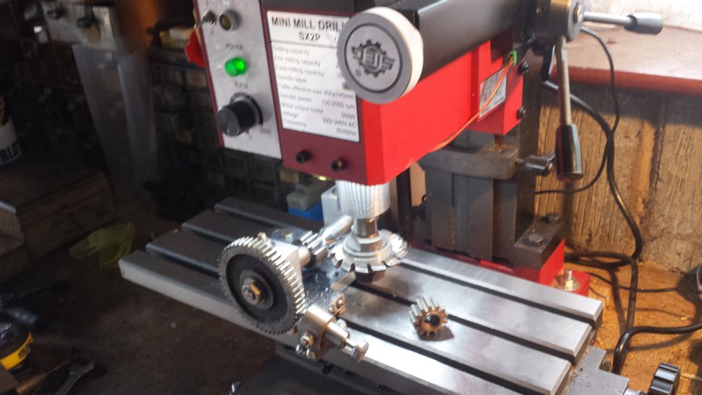

                                          geoff walker 1
                                            @geoffwalker1
                                            Hi Gareth,
                                            I see you have added your reversing switch.
                                            I added mine some years ago and have had no issues.
                                            I had to reverse the rotation to suit a gear milling fixture I have.20190309_095016.jpg
                                            Good luck with the tapping but as J said do take care
                                            Geoff
