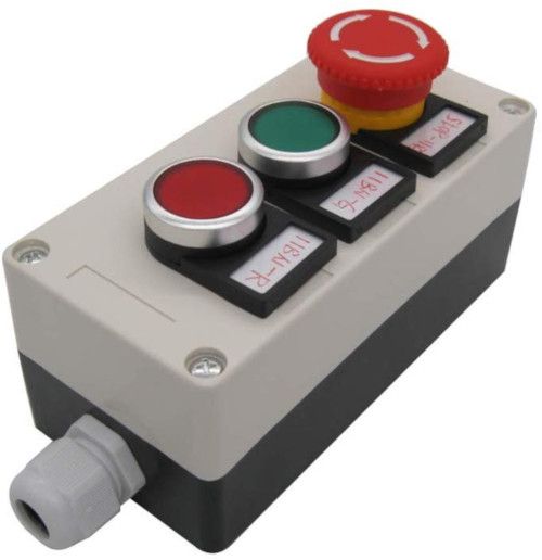

                          Colin Wilks
                            @colinwilks45682
                            Thanks for the link Stuart. To answer you and MichaelG, if you Google "NVR Switch" you get a large selection of on/off and emergency stop switches, but only very few are surface mount (i.e. have a box on the back). The majority are flush mount to replace existing switches in machines, and nobody seems to sell the empty plastic back boxes. As I am fitting the switch to the metal cabinet of a Myford lathe I need to surface mount the switch.

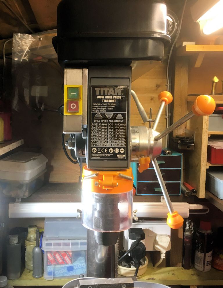

                              Harry Wilkes
                                @harrywilkes58467
                                I fitted a NVR on the side of my drill as shown in photo, the on/off was on the side of the drill and difficult for me to use so I purchased on off ebay popped it in a box and extended the wires .

                                    Cracked it. Googling "enclosure junction box" produces what I am after.
                                    Regarding a direct on line motor starter with a separate emergency stop, this makes sense as it protects against overload and allows me to position the stop switch in the most appropriate position, but is this technology compatible with my Crompton Parkinson 240v motor which uses a condenser to start via a centrifugal switch?

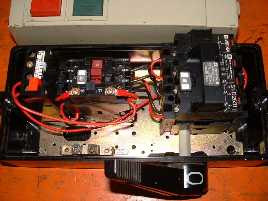

                                      Emgee
                                        @emgee
                                        Posted by Colin Wilks on 16/10/2019 12:58:26:
                                        Overload size depends on the motor FLC, usually stamped/printed on the motor plate.
                                        This is listed in Classifieds.

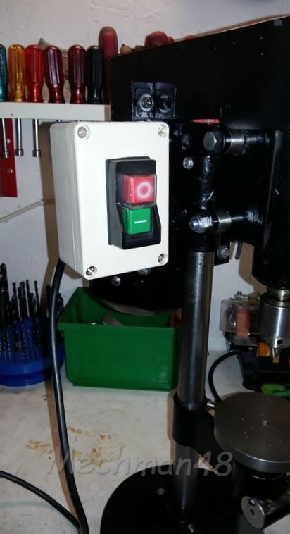

                                                  mechman48
                                                    @mechman48
                                                    I have fitted one of those KEDU type NVR to my small precision drill earlier this year & it works fine; I am in no way elecktrikery minded but just followed the wiring instructions with fingers crossed. I tested by having the drill motor running then switching off the socket on the wall, heard the contactor delatch ?; waited a couple of seconds then switched the power back on, the drill did not start up, I had to push the start button to get it to run, all's well that ends well & with a sigh of relief I hadn't tripped the RCD in the garage.
                                                    George.
