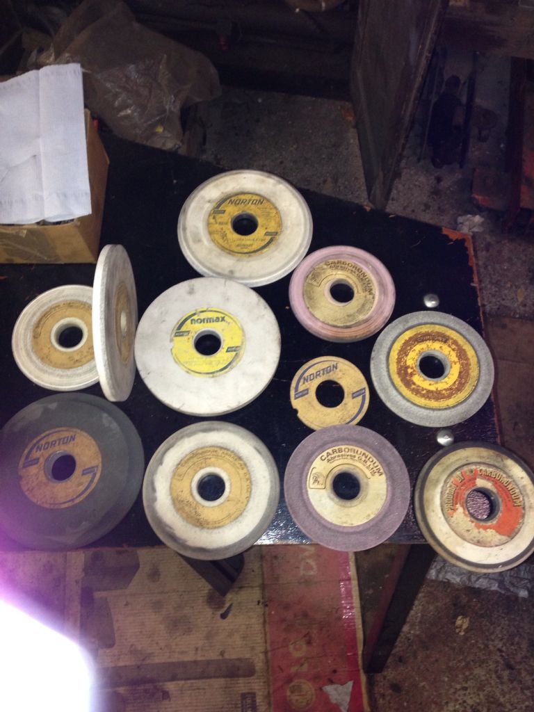

        image.jpgimage.jpgAl & I have a Jones & Shipman surface grinder, with it came a large amount of wheels, we have not got an idea which wheels do what, can any one advise use. I have an ally cylinder head to skim! So advice on that would be appreciated. See photos of a small sample, and why is the one stud up two different colours.

          It's a special used for tidying up the edges of bimetallic strips used in thermostats.

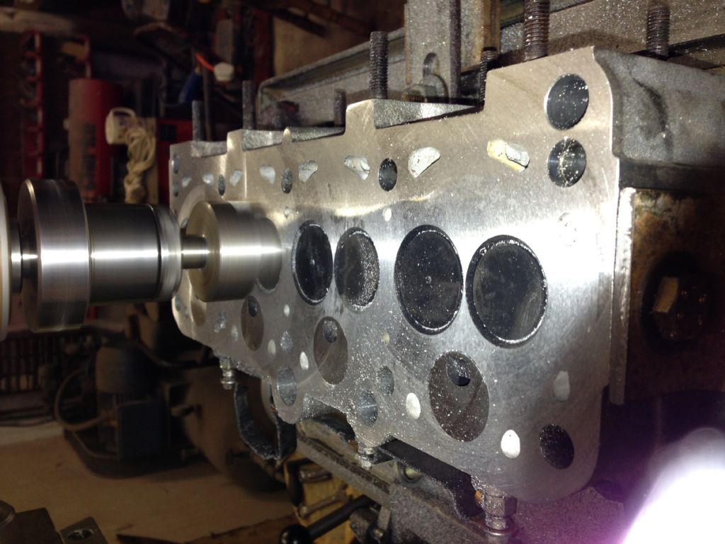

                  As regards an Aluminium cylinder head a very fine milled finish using a broad sweeping flycutter would be just as good and much safer to do .

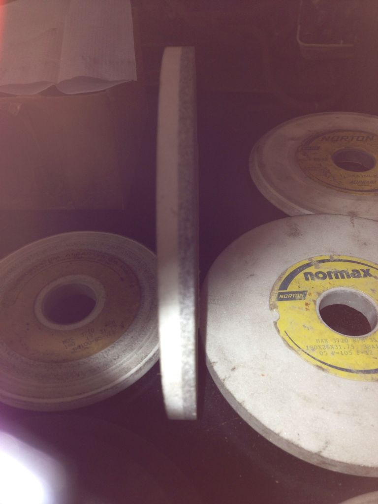

                      The grinding wheel that is stood up is two different colours because it has been used on only part of the width, and the part that has been used is glazed.
                      It may seem a waste, but I'd bin the wheels that came with the grinder and buy new. Presumably the wheels are an unknown quantity, so you don't know how they have been treated or stored. As a rule of thumb the periphery of a grinding wheel should be doing about 5000 feet/min, that's around 60mph. If the wheel breaks up it'll do a power of no good to anything in the way, including you.
                      Andrew

                        Yes – some of those wheels don’t look in very good condition and a couple of them are either badly dressed or they’ve actually been used on the sides for grinding .
                        Wheels are not that expensive – get a few new ones .
                        The professional grinders in industry could tell whether a stone was cracked by ‘ringing’ it – just like testing fine china – though a duller sound .

                          Fly cut the head on the mill, its the best and safest option.

                              Brush on some paraffin (WD40 might work as well) before starting the cut and provided the tool is ground correctly and the mill is trammed correctly you can expect a superior finish. If you do it right the mill will tell you so with a hiss from the tool as it cuts.

                                Reference has been made about wheels looking as if they have been used for grinding on the side. It should be appreciated that wheels can be used for side grinding as long as the wheel is dished and the cutting is done on the outer edge of the wheel. Wheels can be purchased that have the relief already dressed in, or the wheel can be relieved with a hard dressing stick such as Norbide etc.
                                    The manual for my Myford cylindrical grinder even gives you a handy sketch showing how to relieve the side of wheel for grinding up to a shoulder.

                                          Ok fly cutting the head it is, ALS bringing one over tomorrow as the one I have is home made & I have not used it ! Came with the mill. Why use kero or wd 40 & not cutting oil ?

                                                image.jpgThanks gents, carbide tip was best result, please see photo.
