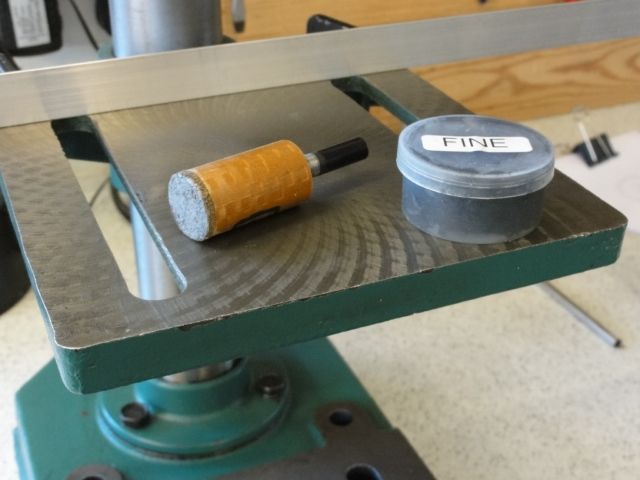

                I used a round piece of softish leather glued to the end of a piece of wood dowel and impregnated with engine valve grinding paste:
                Note that I didn't use it in my milling machine for fear of getting abrasive in the little important bits of the machine but my cheapo drill press survived the experience unscathed.
                The finish I got was:
                Jim

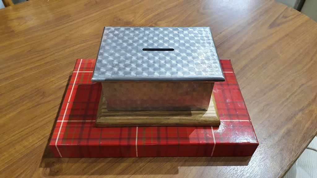

                #544734
                Craig Brown
                  @craigbrown60096
                  I made this money box for my son and basically used the exact same technique described by Jim above. A wooden dowel with a piece of leather glued to the end and used a mix of oil and surface grinder swarf as the abrasive. Cover the surface in oil and then sprinkle a small covering of the abrasive and then just work your way across. It's best to set up a fence to keep the pattern square and I just did my overlaps by eye. Obviously a spacer is then used between the part and the fence for the next row and so on and so on.
                  Craig
