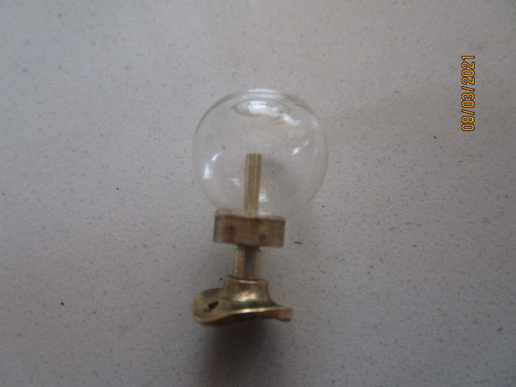

      I have made 2 oilers from glass globes and brass.
      Does anyone know if superglue is affected by oil once it is cured?

                    Brian H
                      @brianh50089
                      I never considered Araldite, even though I have some!
                      Many thanks to all who replied, you've been very helpful.
                      Below is a picture of one of the oilers, it just needs a split pin and some worsted thread to complete.
                      The glass globe is 5/8"inches in diameter.
                      Brian
