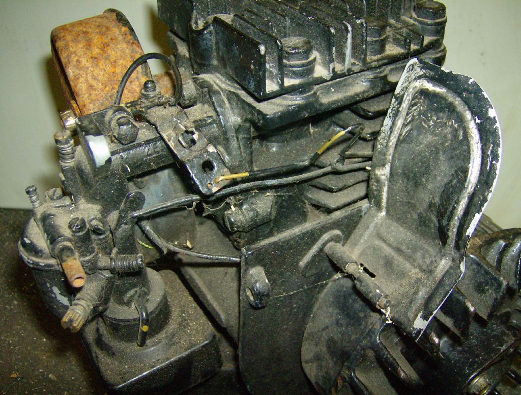

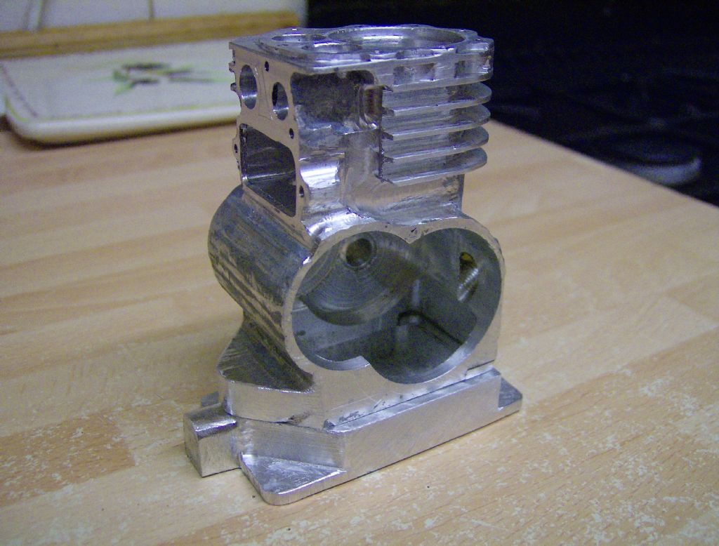

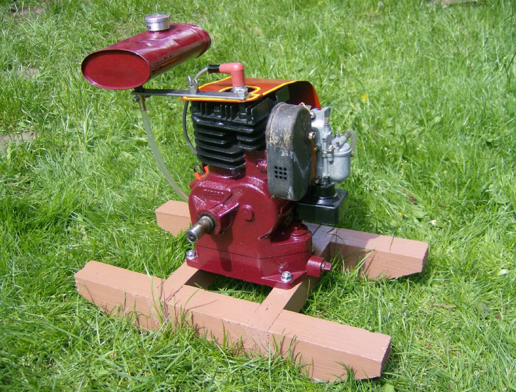

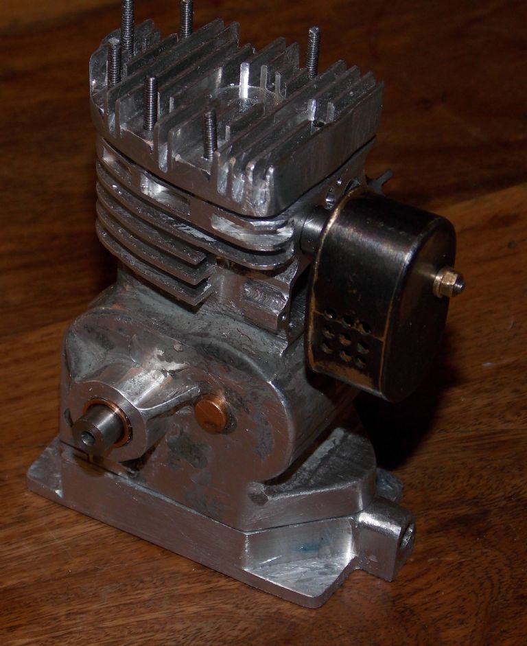

      Over the holidays I have been working on a lump of aluminium to make a combined cylinder/crankcase for a model of my salvaged Suffolk lawnmower engine.
      I'm no Brian Perkins, and to be honest its more a learning process than a medal winner! There are some serious mistakes, but none fatal so far.
      Pics of the original and the (still very incomplete) block to compare:
      Output side of restored engine
      Carburettor and vane governor

          What scale is it Neil?
          #107490
          Sub Mandrel
            @submandrel
            Roughly 1/3 full size, so the block is just over 2 1/2" high.

                That's a nice piece of sculpting Neil – very compact – whats the capacity BTW and does the lawn mower come after wink

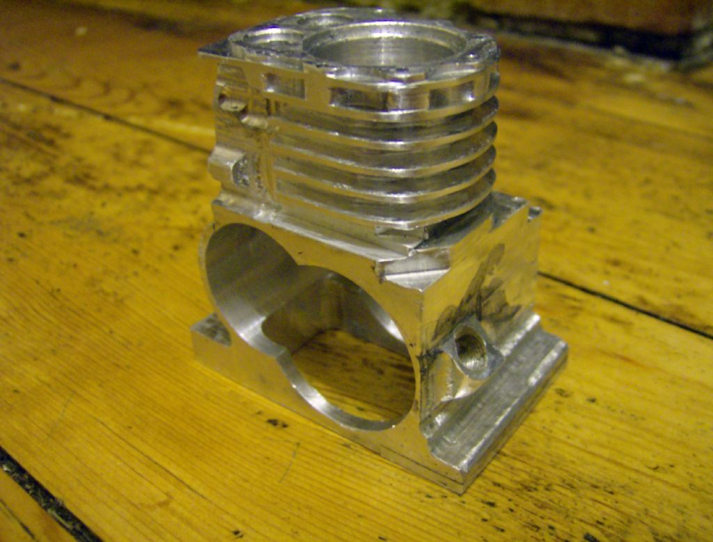

                  It's looking great Neil. Are you planning to use a cast iron or steel sleeve in the block?
                  Or is your block made of high silicon aluminum like the original, to handle the rings running directly on the bore?
                  Briggs and Stratton in the USA pioneered the use of the hi Si alloy. It seems a bad idea on first glance, but I have seen many B&S engines 40-50 years old made this way and still running.
                  JD
                  #107513
                  Sub Mandrel
                    @submandrel
                    It will be 3/4" bore, probably the same stroke so about 2.7cc.
                    I will use a liner – CI or steel with a CI piston. My original is the early 78cc small bore version with a CI block.
                    Hopefully today I will be able to finish profiling the crankcase part.

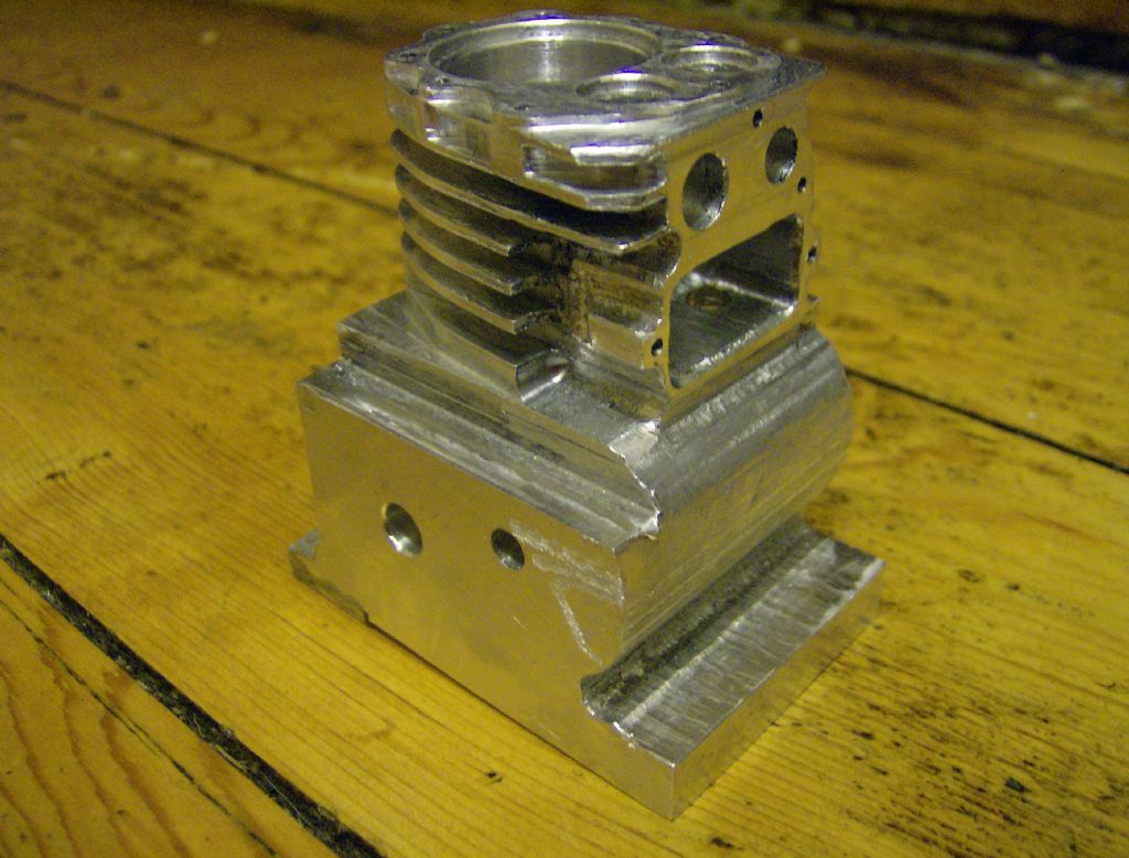

                              The ancient engine is making me guilty as I embark on this one… although I have done some really nice work on the eccentric straps and rods (if I say so myself). Thinning them down from 1/8" thick was a challenge until I realised I could use the very tip of a huge clamp to hold them on the mill table.
                              This engine has been planned for ages and I set the target or making the crankcase over the break. It still needs a littl;e more shaping – reducing fin ends, the hole between the manifold attachments, some fixing holes and tapping.
                              I slightly bent the base with over-enthusiastic clamping. I spent ages rocking it on the 'surface plate' and tweaking it without success. Eventually I applied some engineer's blue that showed two small high spots. Rubbed off with emery cloth and solved in a minute!

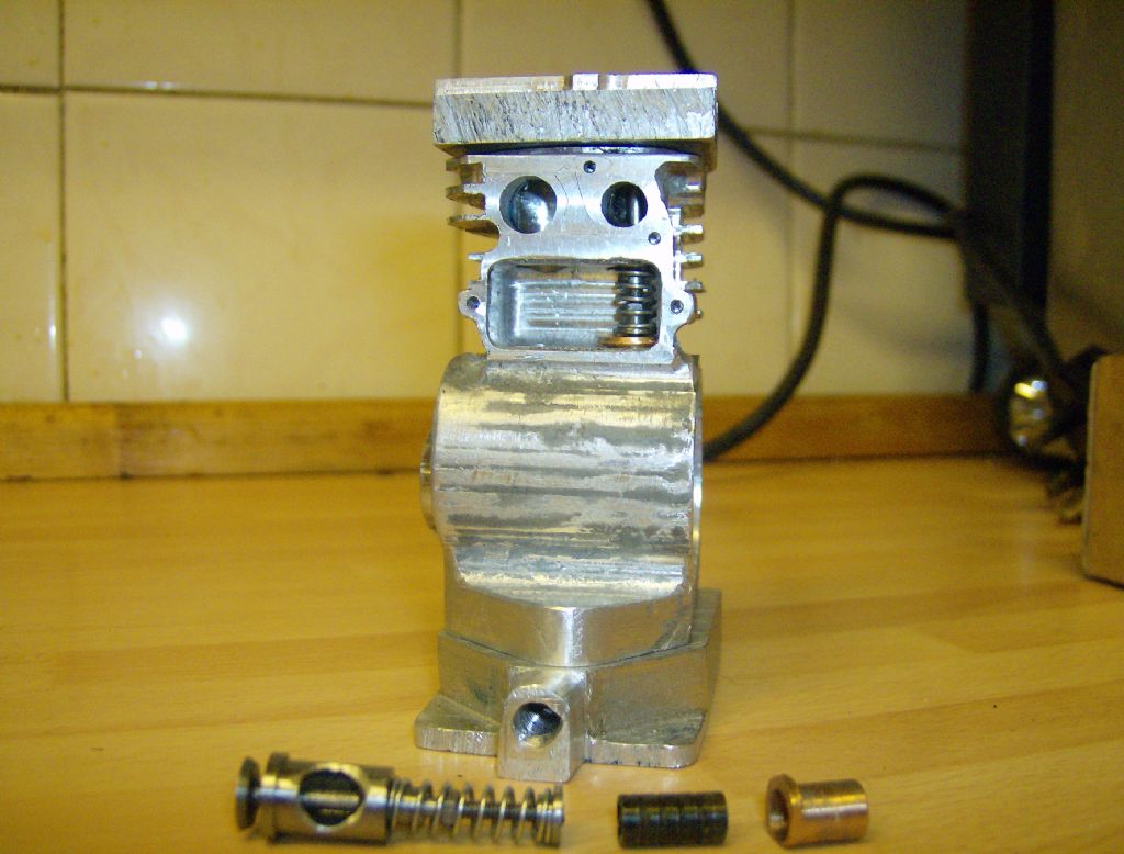

                                Some more progress. Many thanks to Rod for advice on springs.
                                Valves
                                Some more bits of engine

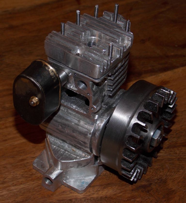

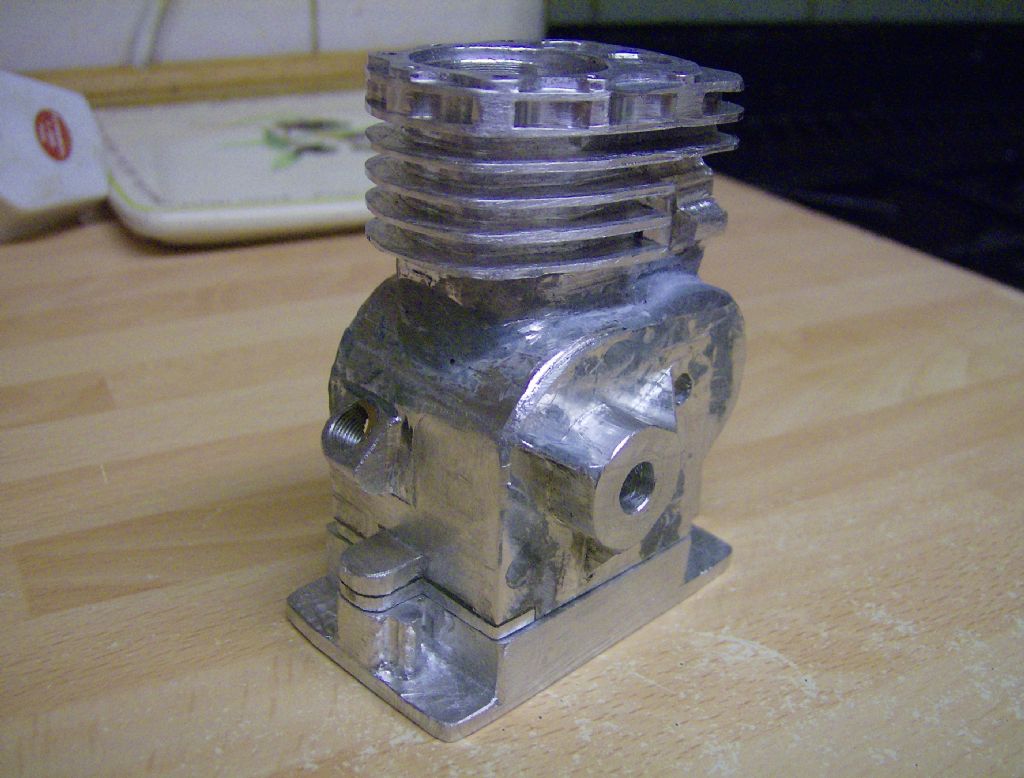

                                  Quite a lot of progress now, last big job is to make a carburettor!
                                  Progress 2
                                  Progress 1

                                      Hi Gray,
                                      I HOPE it looks like the ones fitted to Qualcast mowers!
                                      My regret is not making it 1/2 size instead of 1/3, not much more work, but a lot less fiddly.
                                      I might write it up – if it works!
