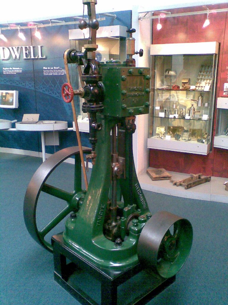

              I recently posted pictures of couple of full size engines in my albums – even the models  are real engines
              This Tangye engine at the Black Country Museum is not too far from a Stuart 10V at all!
              There are truckloads of engine about, if you look

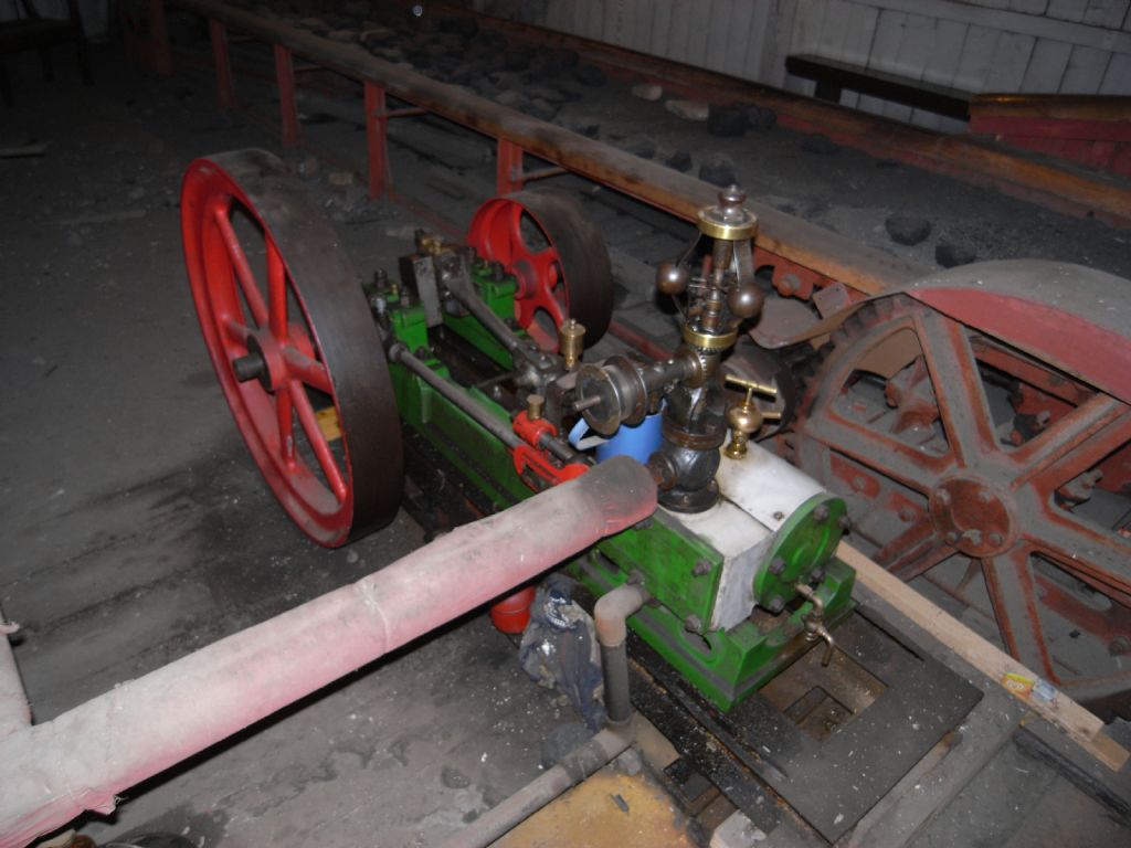

                Here’s mine
                and here’s a real look a like at Beamish
