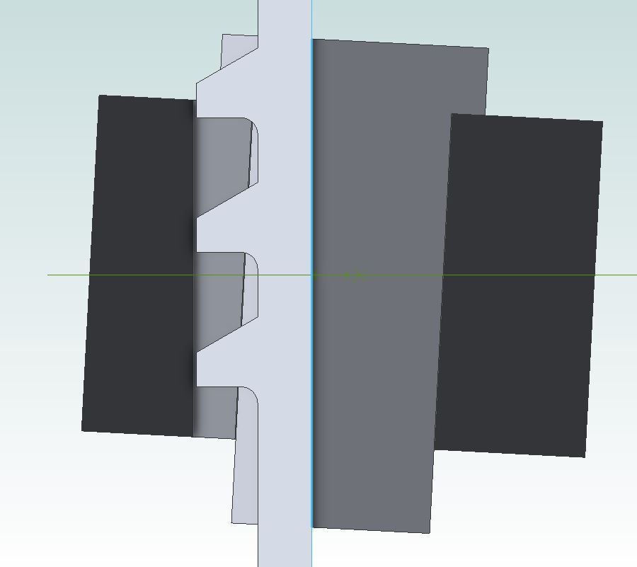

      Ramon, if you say you can't see how the broach will follow the tapered guide what makes it any different to the broach following a parallel guide and not drifting of somehow?
      If I tilt the sketch so the exaggerated broach angle is vertical you should be able to see from the drawing that it is cutting a keyway that is parallel to the guide bush, I simply can't see what is different that may cause the broach to move away from the guide
      Yes you could tilt the flywheel slightly so the broach is truely vertical but as I said at our sort of sizes the broach is so short the 75mm or so sticking out at the start of teh cut will only be 0.75mm off, thats 0.57degrees so I have not found it needs the work mounting at an angle myself.
      Here is a square up against a 6" long parallel in a tapered guide a syou can see it's not far off vertical
      As I said the angle in the sketches was exagerated in practice it is very small, this guide bush is 1.5" long and depth of slot varies by 0.35mm, hard to be exact one handed.

        As modelled, would the marginal acute angle where the broach hits the bush tend to push it into the guide slot? So at least in theory, it’s better than a parallel slot?

          Well actually they can Jason, I have seen that where a broach pulls itself into the workpiece because the broach was not being pushed in truly vertical – when that happens its a bugger to get out sometimes too.
          I'm not saying your method doesn't work – you've obviously proved that to yourself for yourself but I'm not convinced from my past use of broaches. Just to be clear – are you pushing the broach right through the workpiece ?
          Guys, I'm not being pedantic here but I just don't see, based on my use of push broaches, not just at home, why there is need to go to all these lengths to get a flywheel drive on a shaft, it is after all a pretty basic requirement and to be honest Doc, if you are trying to replicate a full size machine of similar attribute the flywheel would in all probability be staked not keyed – but you'd still need to slot the wheel of course.
          From the outset I did say if broaches are not available then slotting is the best (only?) option. A broach is a dedicated piece of kit – not cheap for what it is and can easily be damaged/ broken. A slotting device on your lathe is far more versatile for a relatively short diversion. But that's my take – money and choice being the ever present convention.

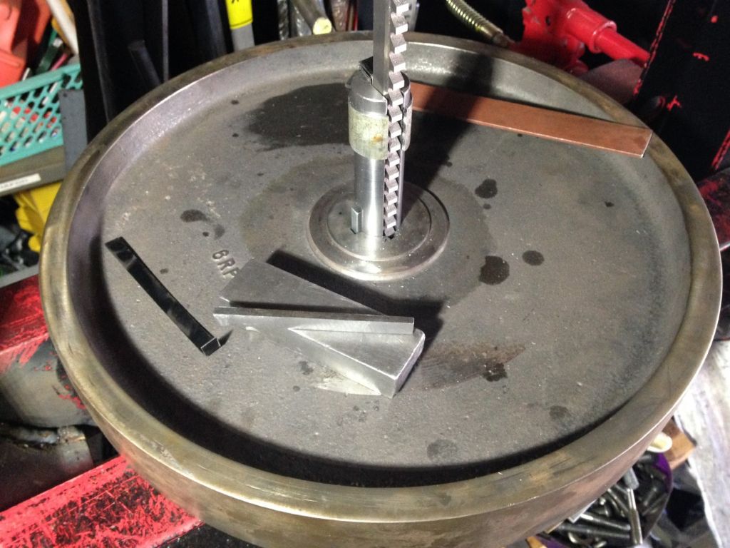

                                      The flywheel on my engine is held by 2 tapered keys, 90 degrees apart.
                                      The taper slot made by making a guide bush with a deeper slot to hold a tapered shim. The flywheel was mounted square on the press and the broach pushed thru at an angle. Take care to back off the pressure on the ram often so the broach is not bent too much and breaks (broach is not aligned with the axis).
                                      A second key slot was machined in the guide bush for aligning the bush with the first slot in the flywheel when the second was made.
                                      (PS. My first attempt at broaching a 3mm wide slot, sheared the drive pin in a light drill press that I was using as a press and is not recommended)

                                          Paul (Kemp). Thanks for the link, that's a beefy key way but as I see it the guide is for cutting a parallel slot on a taper – not cutting a taper in a parallel bore using the broach to achieve it.
                                          Paul (Lousick) I don't, nor didn't, doubt your's or Jason's claim, just that to me that's not the way to use a push through broach. As you say you have to constantly relieve the pressure as the broach is pushed off the vertical. To me, though it may, and in your case did, work there is no guarantee the broach stays in contact with the guide – very likely too I agree but not certain.
                                          As I'm sure you are only too aware machining a taper to an exact match has to be perfect, no doubt you can set your flywheel in place where you want it to go and tap the key home from the end of the shaft to locate it in position. As it stands Doc intends to machine two keys that sit in a captive slots and push the flywheel over the keys such that the tapers engage when the flywheel is in the right position.
                                          There may be some leeway in the captive slots but I still stand by my thoughts that this is not the way to go – for a flywheel of this nature.

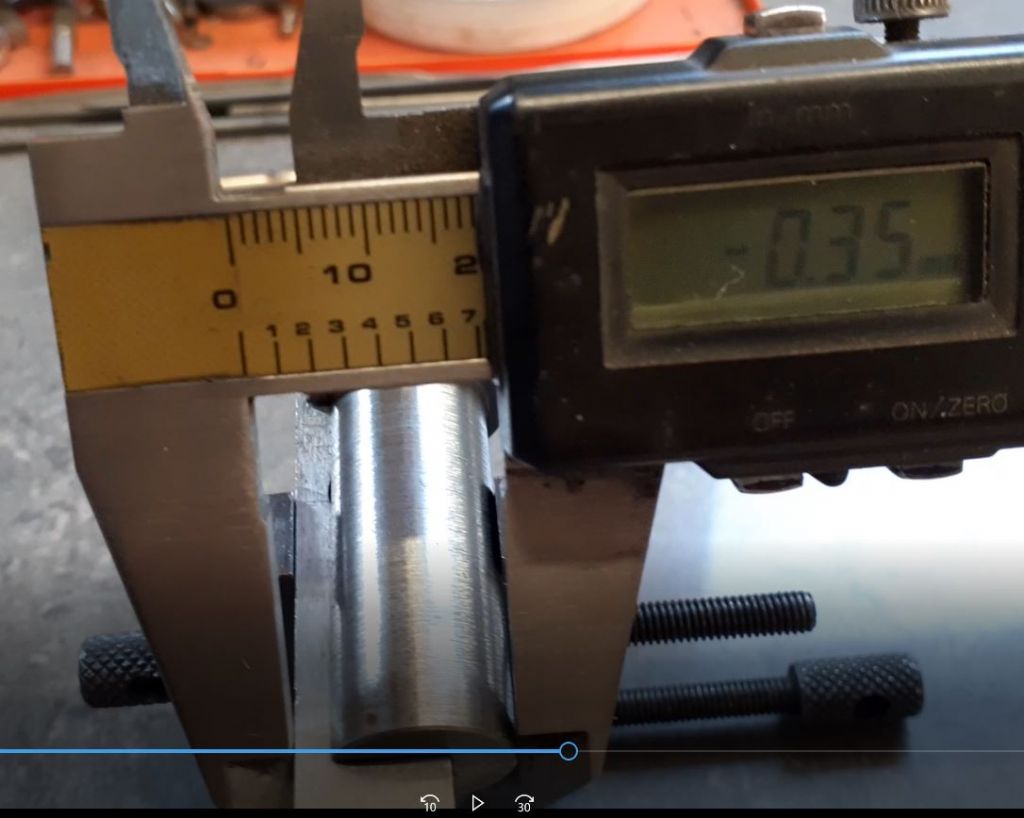

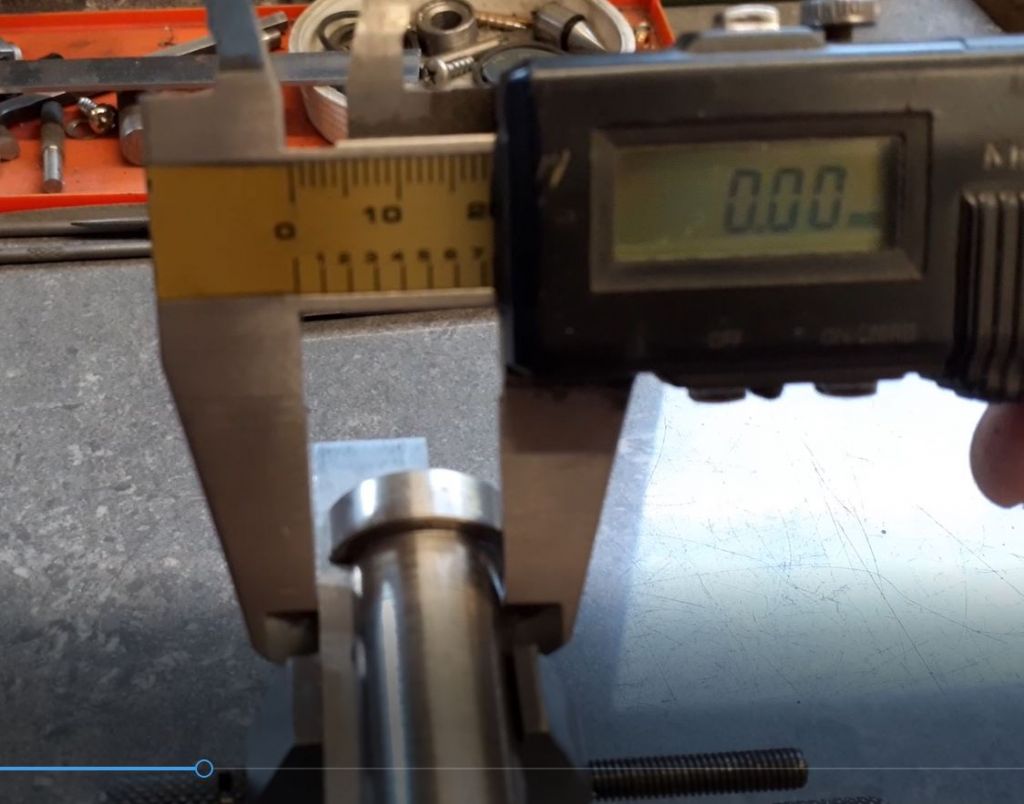

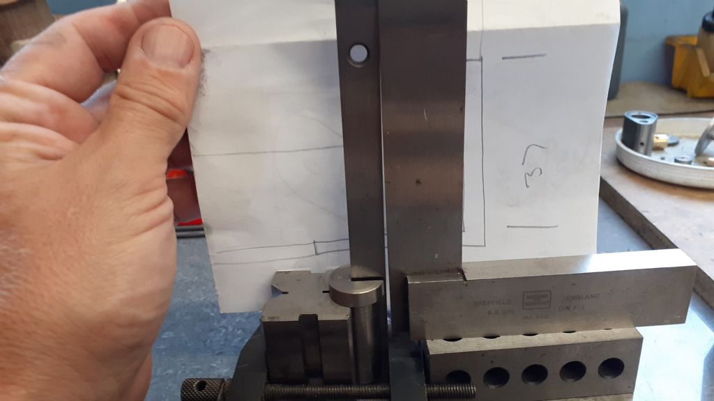

                                                  I used a gauge to hopefully get the same drilling depths in each end, so that I can keep swapping the shaft round between centres and use the same diameter and length settings as I increment down to size. I can check this I guess by clocking each end in turn and seeing if there’s a difference when I’m setting up.
                                                  I’ve done a stage drawing for rough machining. I used the slip gauges to get the lengths. A bit tricky to find the end of the shaft each time when re-setting, but it worked to a few thou. I got as far as this today:
                                                  This material machines beautifully, completely different from the 080A15. I think with a bit of abrasive finishing it will be spot-on.
